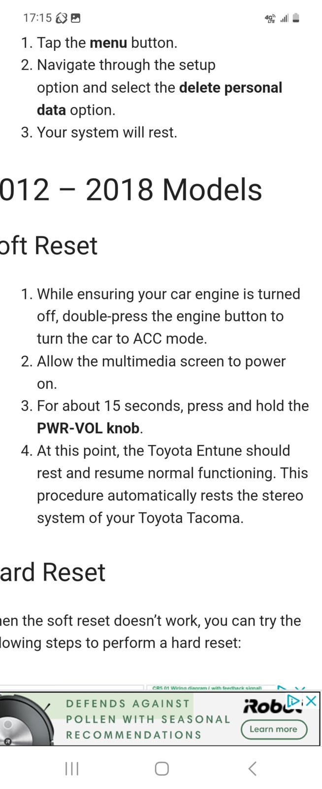

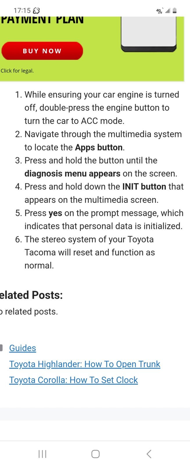

    Here’s how to do a hard reset along with a soft reset . 1000000186.jpg 1000000187.jpg

    I’ve tried both already :/
