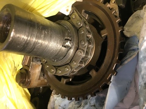

    Like they say, a picture is worth a thousand words... this is what awaits if there is an installation error.

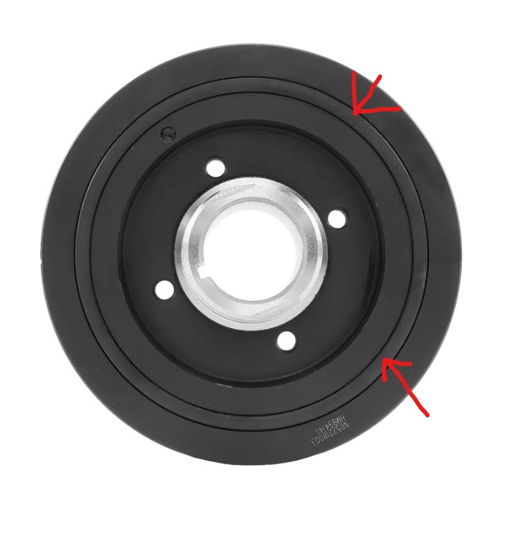

    this is the rubber portion on HB that others have said failed:

    you need to confirm that the inner portion of HB is still turning and the outer ring is not(bc the rubber ring is gone/cracked)
    need to get down under rad.....maybe use a mirror to confirm
    1-if inner/center portion of HB is turning and outer is not.....could attempt to replace yourself......it will be a failed HB
    2-if the entire HB is not spinning(both inner and outer) then that could be a major job
    kinda like OS's picture above
    need to confirm the above and get back to everyone

    One idiot tried to get rid of the wobble.....which is usually what happens...
    ....and he locked the HB against the block from tightening that bolt tooooo hard.
    That's the reason I'd be suspect about that key.......yours failed in most unusual way.....
    HB.....usually wobbles to death.....bolt wont tighten..
