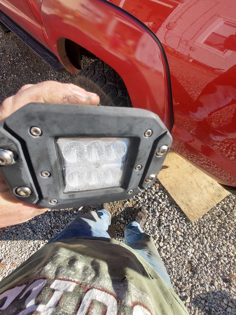

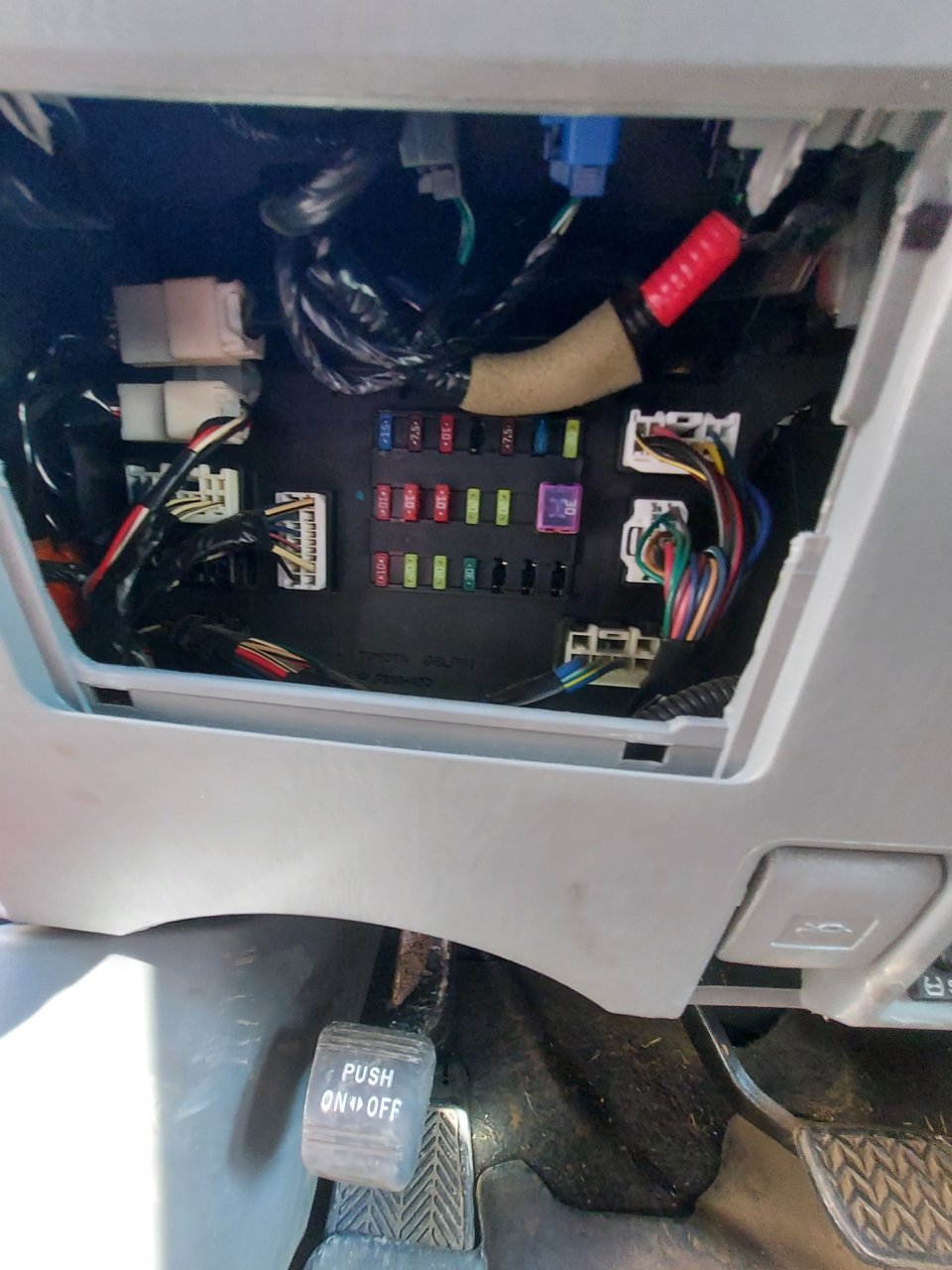

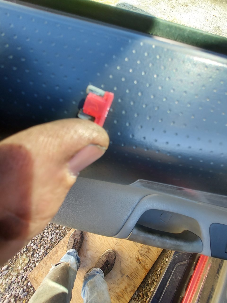

    So after cleaning the battery terminals extensively, removed the reverse lights that were included on the rear bumper (passenger side had condensation inside it which is what caused that circuit to IG1 10a to blow). Checked all of the harnes connections in the rear of the truck. Lastly checked the fuses one at a time and found the IG1 10a fuse blown. Thanks everyone for posting in this thread, I know it's from a couple years old but it was the only one that came up with the keywords that I was searching for.
