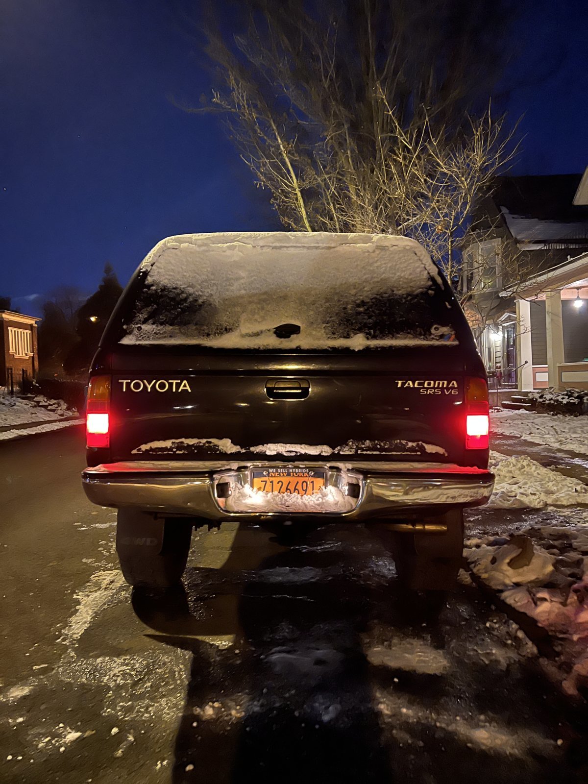

    I did get the multimeter in, it’s only getting ~9.8 volts on the driver’s side where the pass side is 11.6
    the pins on the connector are the same orientation so I swapped taillights, results didn’t change (driver’s side running light still out)

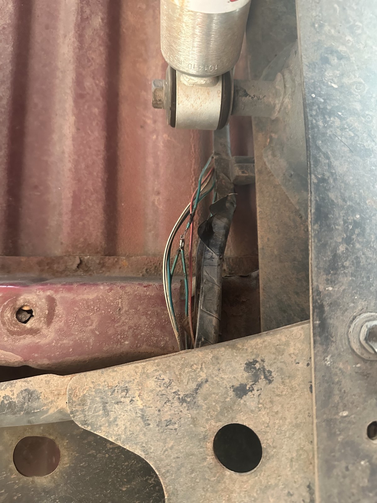

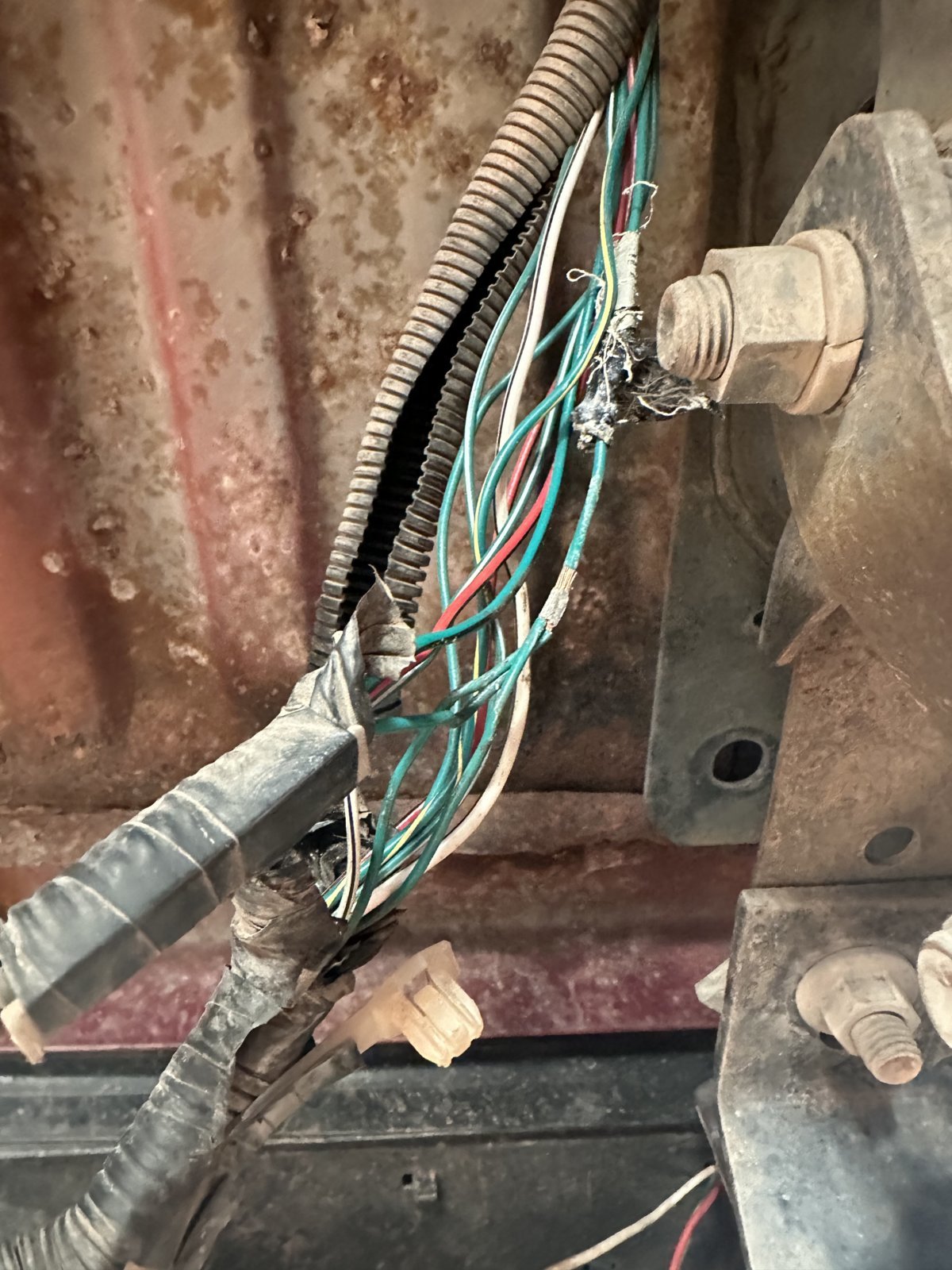

    My understanding is this is for 2000 and older, in 2001 they updated to the wiring to run from one taillight harness to the other.
    There are two splices, one near the shock and the other near the bumper where the harness splits off to the passenger side. The first splice sends one green wire directly to the right running light and another down to the second splice; the second splice has three wires, one to each license plate light and one to the left running light.

    Whoa....that bundle of green is in need of some TLC. Looks like Coldaccord has a fun task ahead tracing the voodoo that is sucking the voltage away from his driver's side taillight bulb. Sounds like a funky ground connection.

    ^but it shares the ground with the working brake light
    I took the easy route and just ran a jumper from the other side.

    OK then......all works correctly now. The slice point has to be the failure spot.
