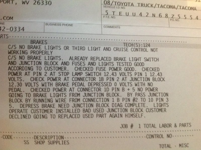

    2008 Tacoma with no brake lights or third light. Checked fuses, bulbs, replaced brake switch and replaced the fuse junction block under the dash twice. Still no lights. Have had to the service department twice and they say it's the junction block but have replaced it twice with ones from a salvage yard. Can't imagine both being bad. Any help would be appreciated!

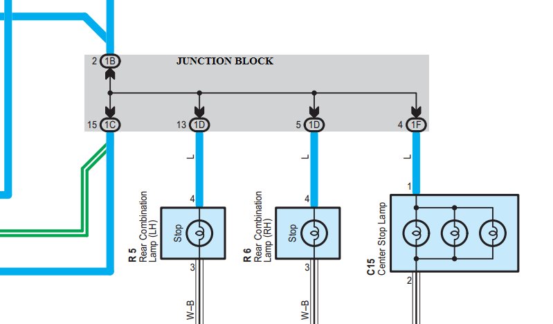

  3. Jan 16, 2016 at 5:43 AM

  4. Jan 16, 2016 at 5:47 AM

    The service center suggested to bypass the junction block to get power to brake lights. I refused and got a replacement junction block but it didn't help either. The above photo is a copy of the invoice from the service dept.

    Reading their description of troubleshooting the problem is indeed the junction block ...
    You do realize that the junction block is just a connecting junction between several points.

    One of the most important rules of troubleshooting is to never trust what has been done previously - EVERTHING should be confirmed. Having said that, I would be removing the connector plugs from the brake light switch, and into and out of the junction block. Check the connector pins for damage and the female pins for enough "pin tension", as in, take a very fine wire paper clip, bend it open, and push the end of it into the female pin. Drag should be felt, equal to the others in the connector. If it drops in too easily, a proper contact will not be made, and that pin should be replaced. One of the most common causes of damaged pins is improper testing - usually when someone shoves their multimeter leads into it carelessly.
    After all that is tested, recheck all the voltages with all plugs reconnected - it is important to measure voltage with a load on the circuit (all plugs connected, so circuit should be completed), many times a circuit with high resistance will carry enough power to display good voltage on a meter (which draws far less than a milliamp) but drop off to nothing once a few amp load is applied. I don't know how the tech at your dealer tested voltages, but in my experience this gets overlooked way too often.
