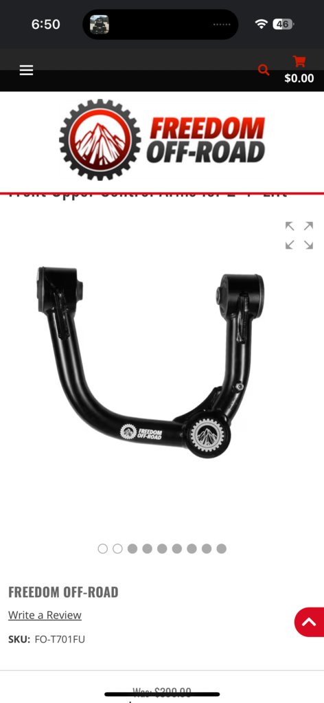

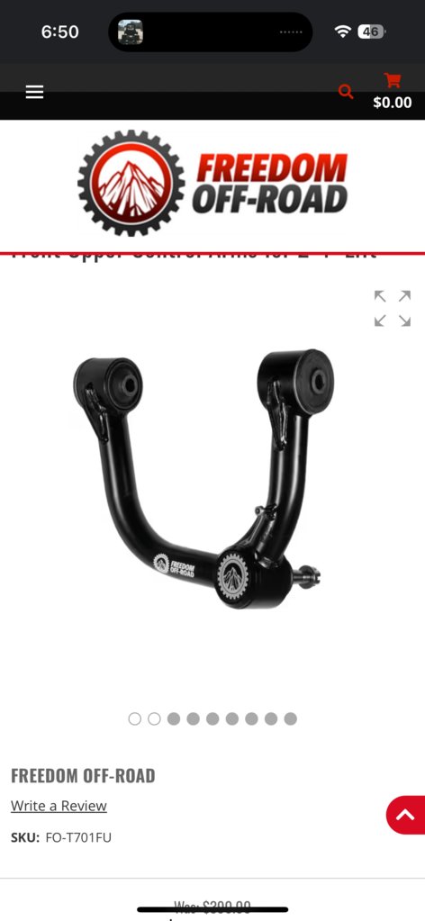

    I’m looking at getting the Freedom Off-road UCA’s and noticed it comes with just a lock-nut and washer and this concerns me. I noticed most aftermarket UCA’s also do not utilize the cotter pin and castle nut. I would like your thoughts concerning this.

    No worries. I see they are running a Black Friday sale too. Those a way lower, ha. Their pics show castle nuts and regular ones. Worse case, you reuse the OEM nuts or get your own castle nuts and call it a day.

    And its not an option for a castle nut, Freedom just shows the arms with both options in their listing.
    https://freedomoffroadusa.com/front-upper-control-arms-for-2-4-lift-fo-t701fu/

    Update! My Freedom Off-road UCA’s came in today and they do have a castle nut and cotter pin! They were a bitch to install, but I got them in.
