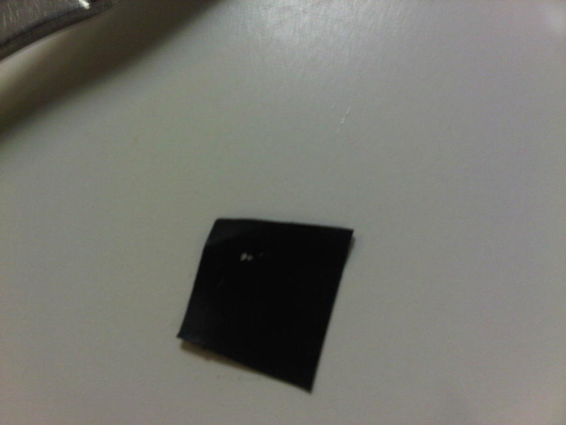

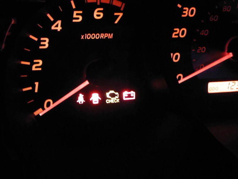

    Update:
    Got the light on and heres why it was off. At least they didnt attempt to screw with the circuit board. Jackasses.
  8. Sep 2, 2013 at 6:58 PM
    650H1

    That duct tape?
  9. Sep 2, 2013 at 7:01 PM
    Slvr2ndGen
    Slvr2ndGen [OP] Well-Known Member
    Jul 30, 2013
    #109448
    158
    405
    05 PreRunner DCSB, 2010 PreRunner DCSB
    Electrical tape
  10. Sep 2, 2013 at 7:02 PM
    Slvr2ndGen
    Jul 30, 2013
    #109448
    158
    405
    And it was behind the overlay
