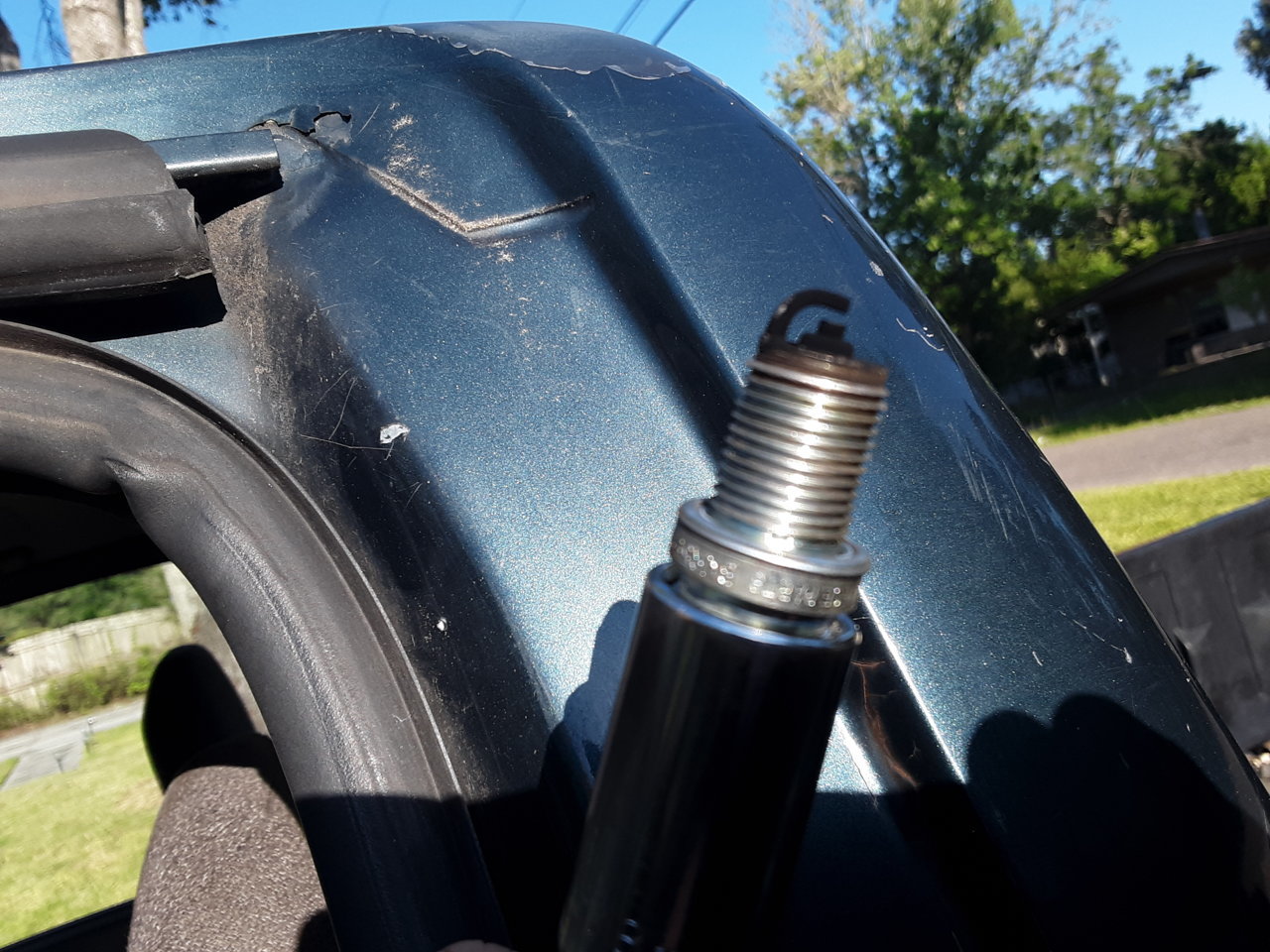

    change of plugs and wires noticed all cylinders black carbon powder coated tell me rich on fuel

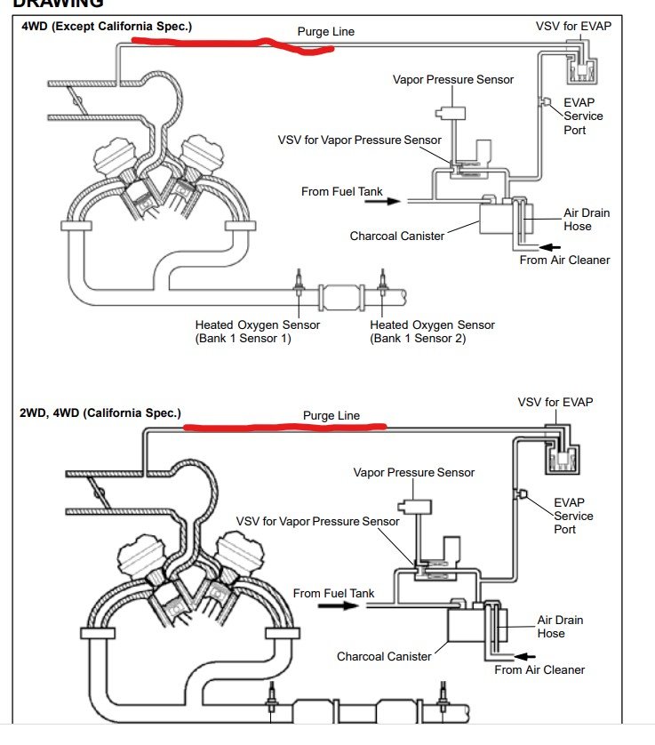

    try pimching off or plugging the line from the evap purg vacuum switch.

    Yes per the above diagram I pinched the line with no change in idle. If I disconnect, idle drops.
