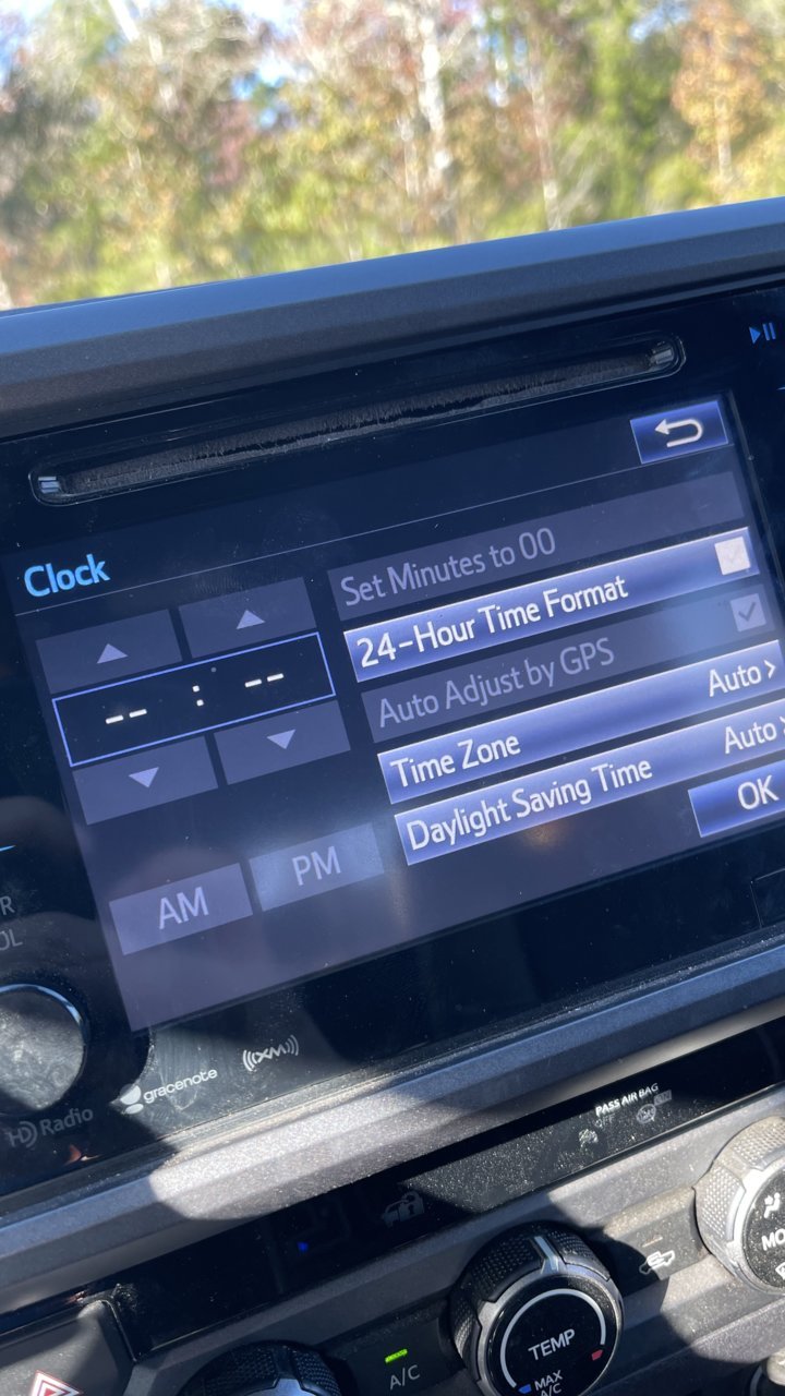

    Hey guys, for some reason the clock isn’t displaying in my truck anymore. I turned it on this morning and it was fine but now it doesn’t show any time. I tried messing with all the clock settings and it even knows I’m in eastern time but won’t show anything.
    Anyone know a fix?

    Welcome to the forum. Could be a loose connection on the back of the radio, very easy to pull it out and check.

    It was a loose gps connection in the back, once I reconnected it, it switched back on immediately. Thank you.

    I was about to tell you it requires a good GPS connection but it looks like you’ve figured it out :thumbsup:
