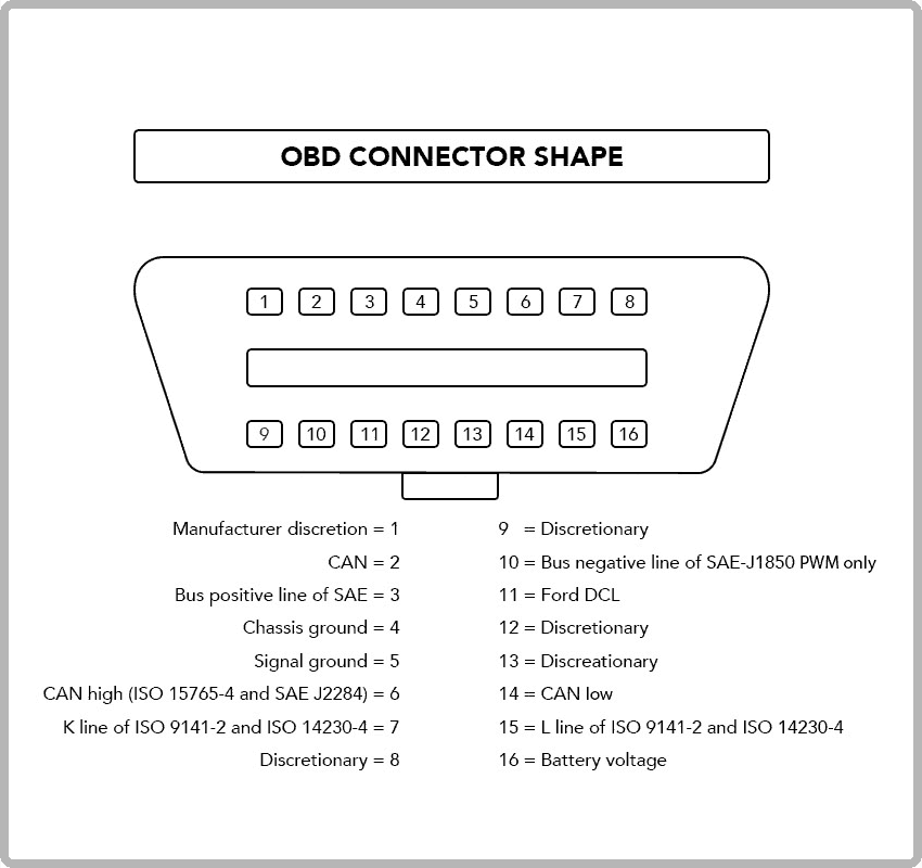

    I have a 2003 tacoma 3.4 no data on scanner have 2.4 volts DLC #4 and 10.8 on #5 with key on.Fuses are good, checked as many grounds as i could find.Check eng lite comes on with key on and turns off when started.

    All fuses are good rework connectors one ECU and most of sensors maybe I missed one checked all grounds I could find scanner just does not communicate have 12v atDLC

    If you have voltage on pins 4 and 5 of the DLC you have a bad ground somewhere, those are both grounds.
    Pin 16 should be constant power.
    Pin 4 is Chassis Ground (grounded at Ground Point IE (right of glovebox))
    Pin 5 is Sensor Ground (grounded at Ground Point EB (on left side of engine))
