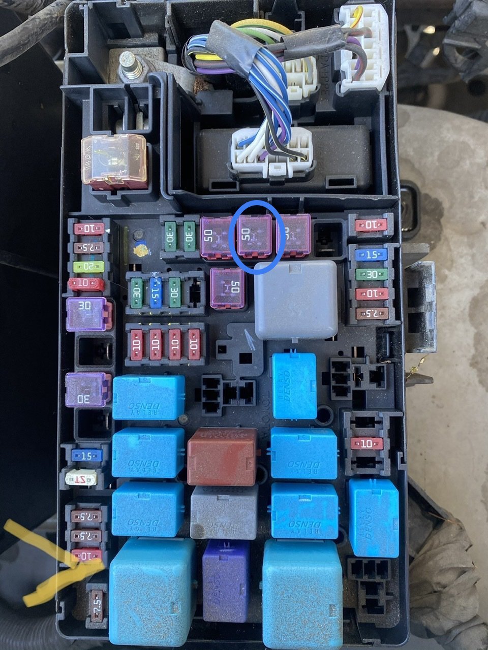

    It has a clear window on top.
    Take a look at it, see if it looks blown.
    It’s in the fuse box, under the hood.CF78AB6C-137A-422E-9E0C-F0F79AA53C16.jpg

    The one circled

    The fuse doesn’t appear to look blown, but like you guys said that’s not always the case. I checked to see if I was getting power to the fuse box with my multimeter by placing the red onto the big wire that’s bolted in up at the front of the fuse box, and grounded the black end to the car. (Not even sure if this is how you check for power in a fuse box) but I was getting 0
