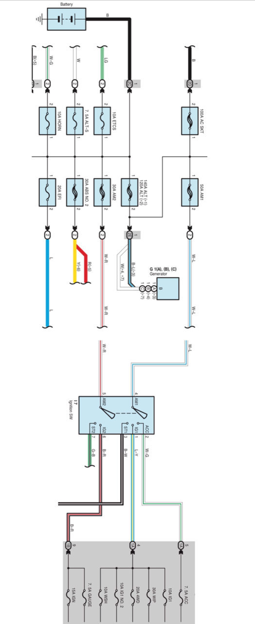

    For anyone interested, here is my “flow chart” of diagnoses.
    I’ve got to run out for a bit, I’ll jump back on in an hour.
    Until then, we need to know why(if) we don’t have power from the AM1 fuse.
    It powers A LOT of different stuff. The IG1 and IG 2 being the big ones.
    Again, I’m still trying to to verify where we do and don’t have power.

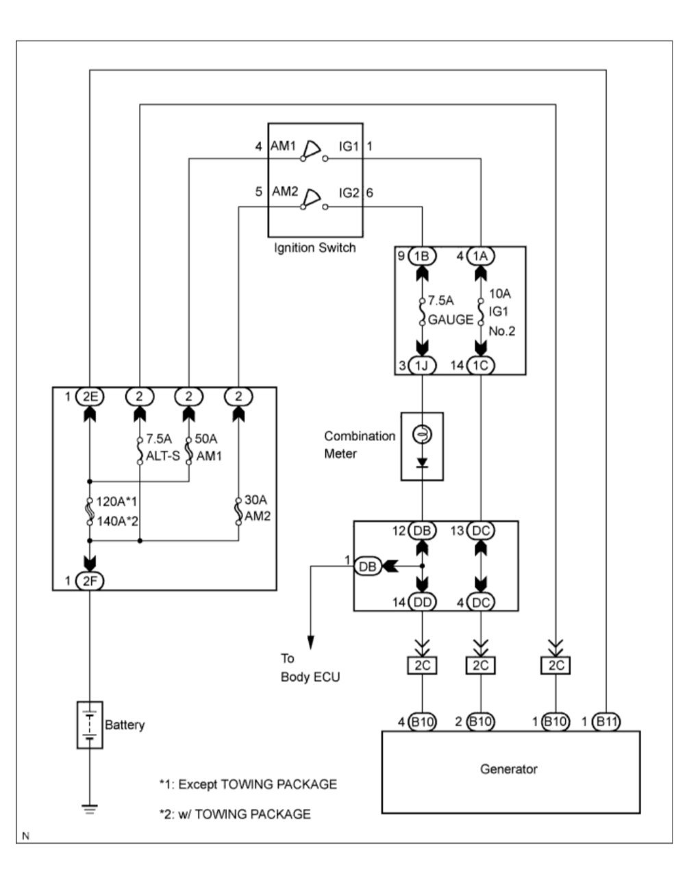

    FWIW, this is the charging system circuit.
    Take a look at what’s involved?
    See any commons?

    Some good troubleshooting tip so far but according to his profile the OP has an 02 so the diagrams posted are not correct.
    I don't have OE diagrams for 02 but here's the one for 2000, it should be the same.
    There are no modules involved in the starting circuit, a failed PCM could cause a no start but it will not cause a no crank.
