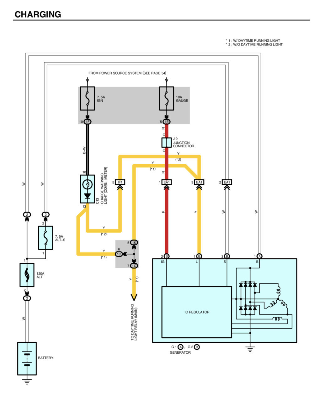

    I wish I could understand those damn diagrams. They seem very helpful.
    I could possibly borrow a test light from a friend. Probably even buy one.

    STOCK
    You can ignore that diagram.
    It’s for the 2.7. I don’t know why, but finding diagrams for a 2002 is hard.

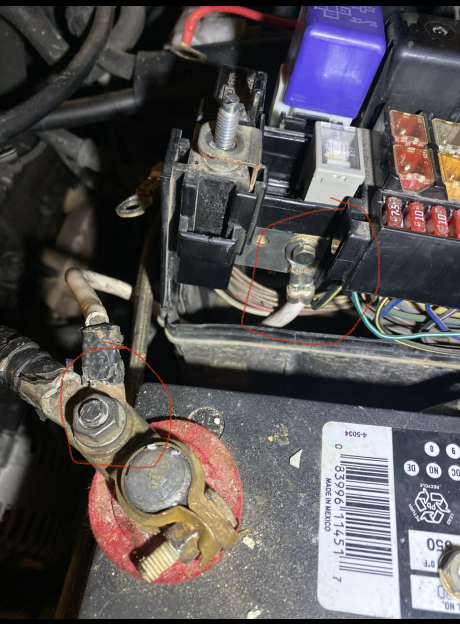

    No. I’m not sure what it’s called. But it’s comes straight from the positive battery terminal and bolts up to the 120a alternator fuse. It’s not connected to anything else.

    Predator tube steps, Ranch Hand grill guard, Magnaflow CatBack exhaust, Toyota tool box & bed mat, 2LO Module by @Up2NoGood, Rearview Compass/Temp Mirror, Tune by @JustDSM.
    Post some pictures of your battery cables and the fuse you are dealing with, it may shed some light on what's going on.

    2002 Tacoma Limited
    The white wire is the one I’m referring to.

    That would help.
    I have a suspicion that unbolting the White charge wire from the alternator will resolve the problem.
    I would still like to know if it’s the wire itself shorted or the alternator.
    Explaining how to check for a short with out a test light is kind of hard. Or at least for me it is.
    You’re a lot more knowledgeable than me on this stuff, but I would be down at the alternator check for the short.
