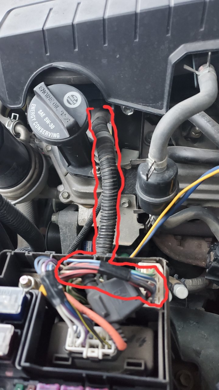

    Id try to locate the break if possible, I'll look at mine when I get time and see if I can give you suggestions on where to look but meanwhile looks for anywhere the engine harness may be rubbing on something or have damage from road debris.

    Don't really have much of a stretch of wire where it could be in, if you have power at EA1 but not the injectors it's gotta be in this harness between there and the injectors. That bracket there would be a suspect spot or if you see any evidence of rodents.

    Just wanted to give an update and tell everyone I fixed the Tacoma and tell everyone thank you for all the info and help! It turned out to be a broken wire in the harness under the intake manifold
