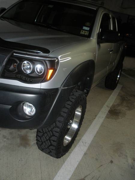

    Well tomorrow im gonna be installing my new headlights. They are the Halo style.
    Im really bad with wiring so I was wondering if anybody with experiance with these chime in or post pics of the wiring?
    Here is a pic.

    Ok, the low and high beams should be plug and play. The led's and the halo's have their own wires: Red, white and black. The little marker lights that you can turn on and off have their own wires as well: one white w/ a black line and a green one. That is the wire that you will splicing into. Take all the white and red wires and connect them, run a wire from those in to the green one from the marker lights. Then all you have to do is connect all the black ones and then splice them into the white/black wire.
    It's very simple, you're probably just overthinking it, try it out and let me know how it goes. If you need me to take pictures it will have to wait until tomorrow because it's already dark here. Good luck.
