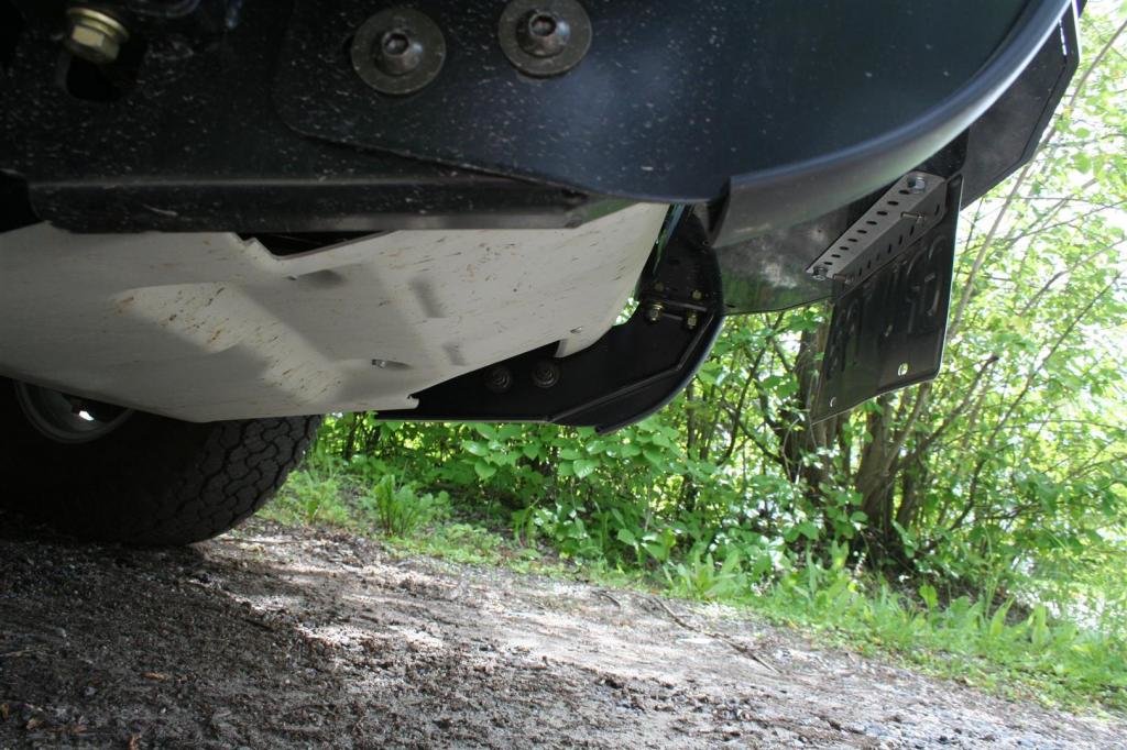

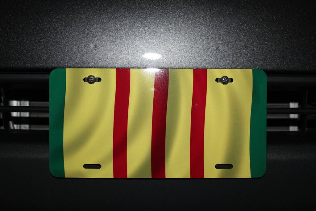

    Ok here you go. Use a small length of the angle bracing used for garage door openers. Attach to existing brackets used for the front valence. Remove plate by hand before offroading. Easy.

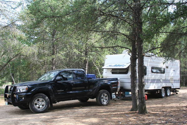

    So had it on a long road trip no bending at highway speed or anything, you cant see the bracket at all and it still shows the registration stickers.

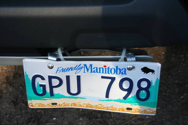

    What I did was bolt the Licence Plate to a couple Angle Brackets and then put a couple Tie Wraps through the holes in the Front Skid Plate Cover for a temporary fix until I got a Grill Guard put on.
    Then as shown in my second picture I used Angled Galvanized Slot Steel like teamfast used on his.

    I made this up and went to the dealership and installed it myself, as a temporary holder.
    Salesman said a Lady with a BMW saw it and wanted one
    Heat Gun bent 1/4" PVC, cable tied to inner Aluminum Bumper.
    Had plans to make a bracket for a future Avid Light Bar.
    Ended up with this
    Should be more pics in my gallery

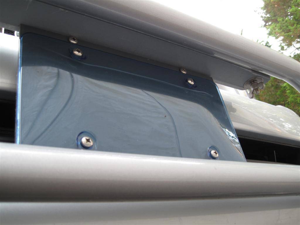

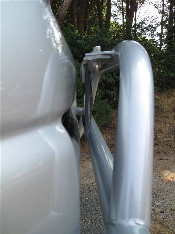

    I bought a Westin Sportsman Winch Mount Grille Guard (still needs a winch) so I ended up doing this...

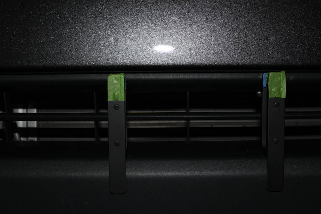

    Now this is slick. Where do I get clamps like this?

    Home Depot or your local hardware store will have them.
