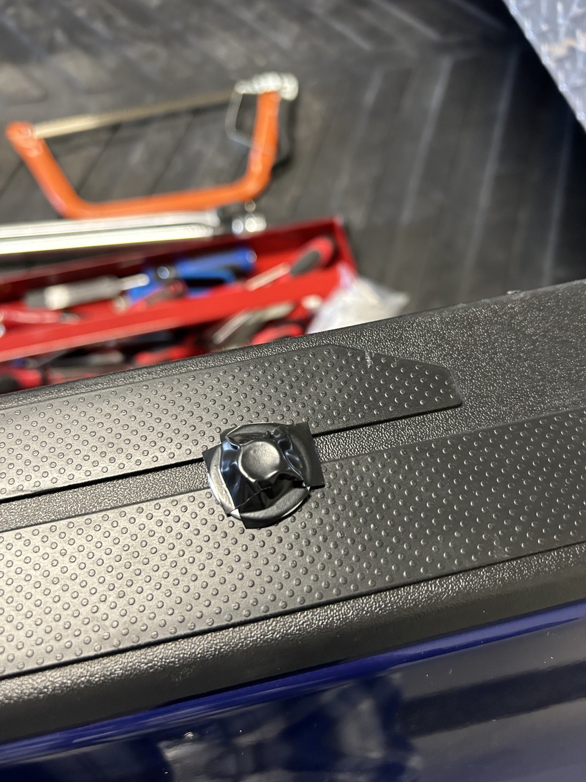

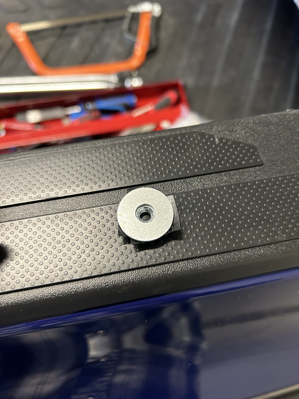

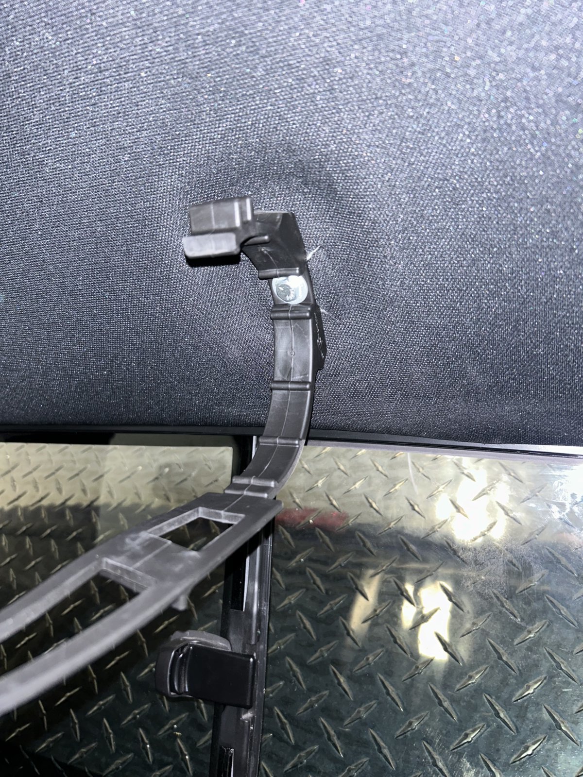

    I wanted to mount my rifle somewhere it would be pretty hidden but easily accessible and completely reversible. I haven’t seen it done before on a Tacoma this way (maybe it has been) and it cost me $25 and is extremely durable so I’m pretty proud of myself. The hardest part was sliding my hand behind the headliner to hold the washer and nut in place behind the factory mount while trying to simultaneously support the clamp, ratchet it, and make it thread into the nut blind. After some trial and error I decided to tape the nut to the washer so I could hold both at once with my two fingers while I slid it behind the headliner and then get it started on the threads and use a ratchet to get it the rest of the way. Worked really well and in the future I can undo it, pop the plastic hooks back in and voila back to factory. IMG_5768.jpg

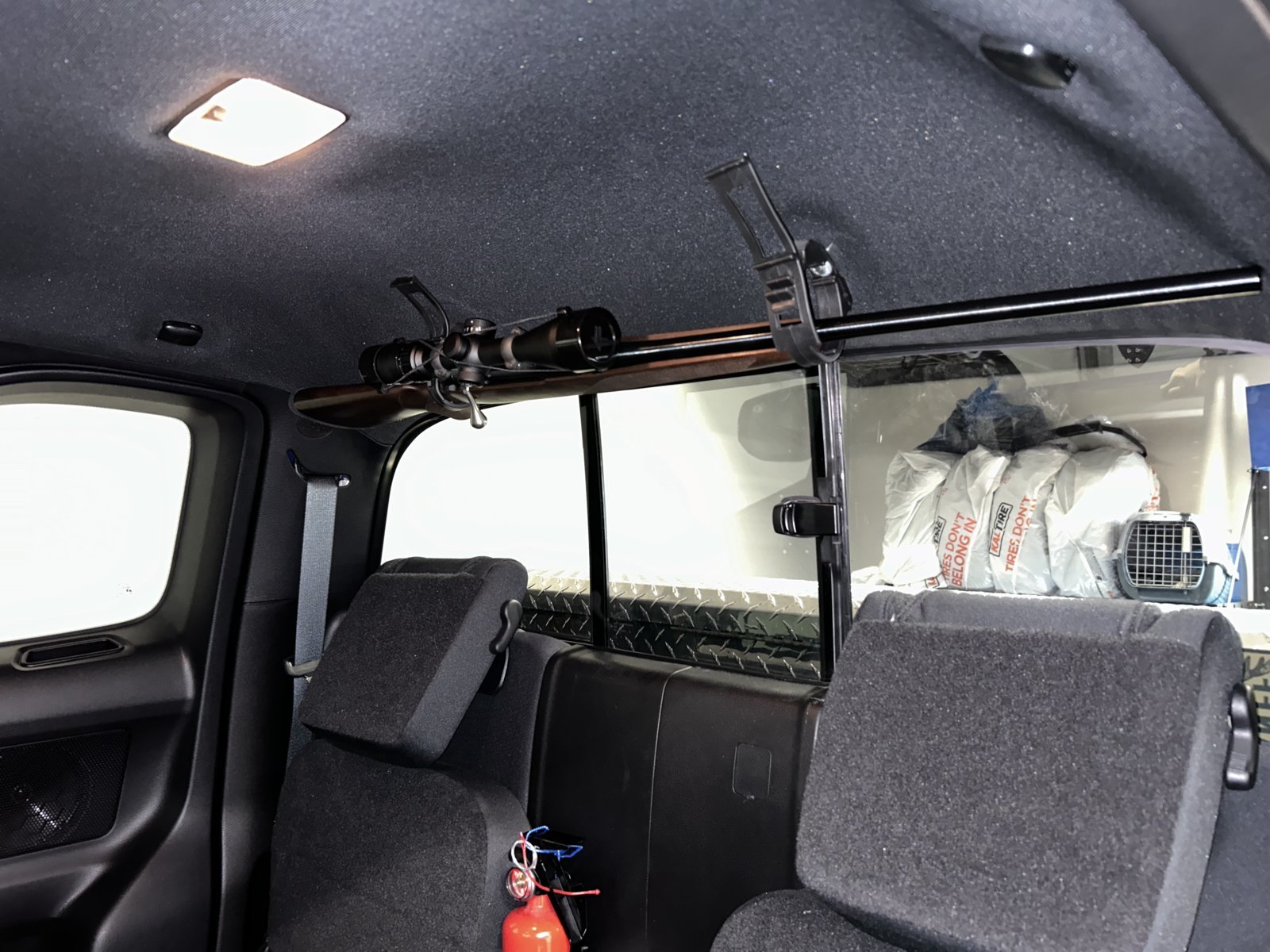

    finished results! Very hard to see from outside the truck and I can pull on it as hard as I want it doesn’t come undone or fall down.
    edit: you don’t have to cut the headliner at all like I did. I did that while I was experimenting with ways to get the washer and nut in behind that mount. If you tape them together as shown, then slide your hand between the headliner and the roof starting at the rear window, you can position the washer and nut while the other hand puts the clamp with bolt already threaded through it into place. No cutting required.

    I did cut the liner but only on one side because the factory hole through the liner is smaller on the drivers side and way bigger on passenger side for some reason… BUT when you put the factory plastic hooks back in it fully covers it so you’d never know :thumbsup:

    That’s too obviously visible and I’m in Canada so they’re pretty anal about everything guns. You don’t HAVE to cut the headliner, I just did that when I was still trying to go from the front instead of sliding my hand in from behind the liner. You can do it without cutting anything as I only cut the drivers side and it’s hidden when you put factory hooks back in.

    Yeah while I probably wouldn't get arrested for having it in the back window, so many Canadians would call the cops on me I’d eventually get charged with something for being annoying and stirring up a kerfuffle.
    the rifle here is so high up on the ceiling combined with window tint it’s almost impossible to see from outside the truck even on sunny days.
