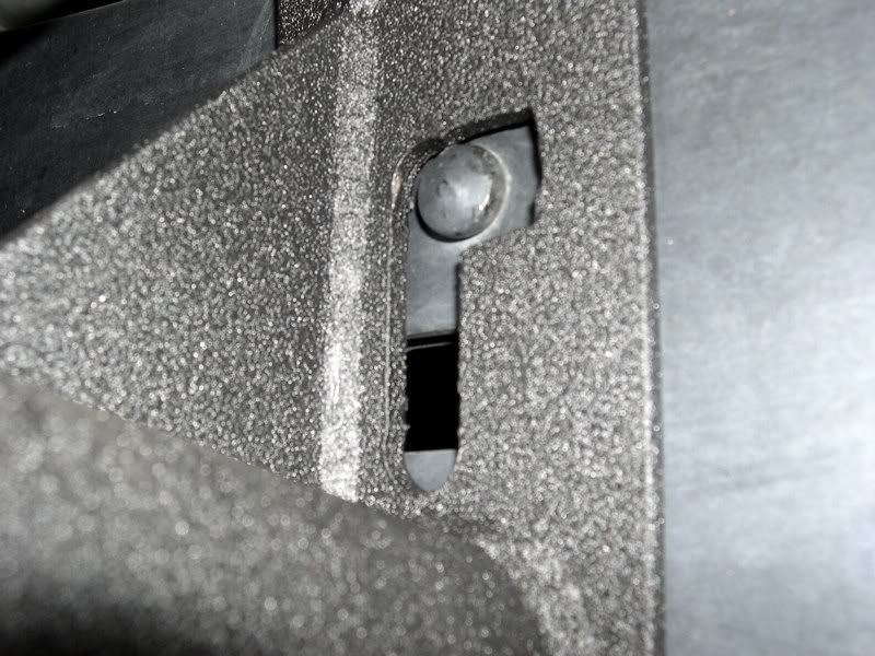

    :thumbsup: Demello's Bolt-ons
    Mine are being built this week! :D I bought the Bolt-ons but requested semi gloss powder coat black instead of wrinkle finish as pictured. Jason goes out of his way to use factory frame holes plus he clearences the gussets for existing rivets so you don't have to grind them down. It is recommended that you drill the holes for the bottom mounting bolts for maximum strength.

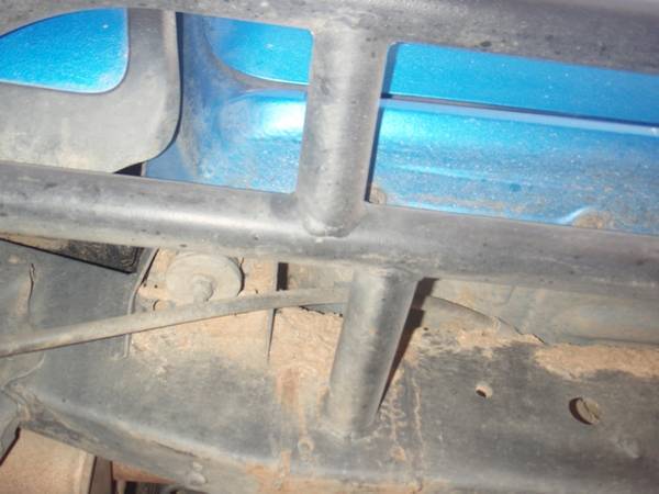

    Search "sleeve" type sliders. If you find anything about revenge fab- skip those. But you'll get the idea.
    They have a boxed end with bolt holes over the top of the frame- Might be what you are looking for...

    Have a look at Avid, they have sliders that bolt onto the factory running board mounting holes. They do make a point of explaining that the bolt on's are not intended to support the weight of the truck. They have weld on sliders too.
