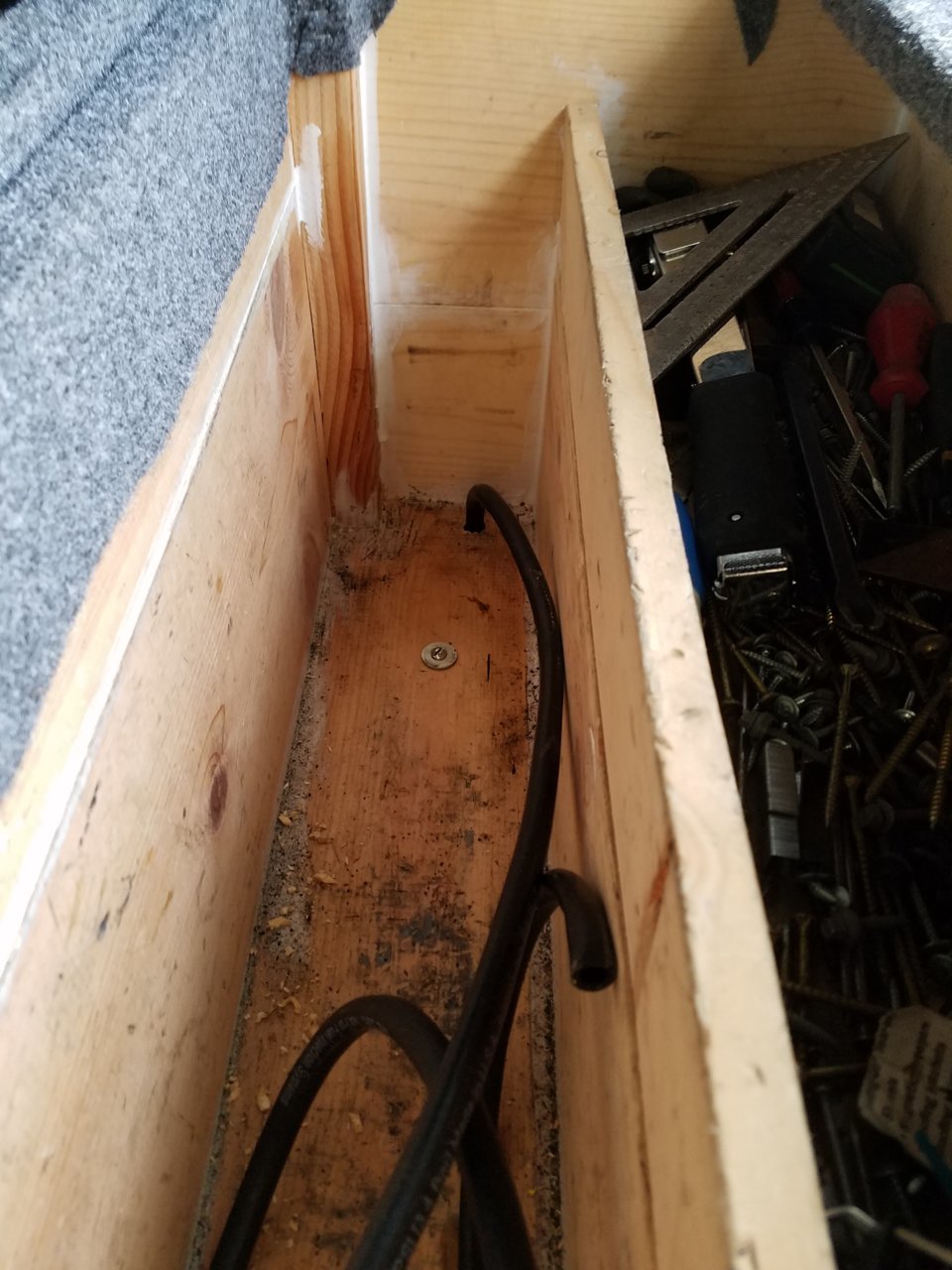

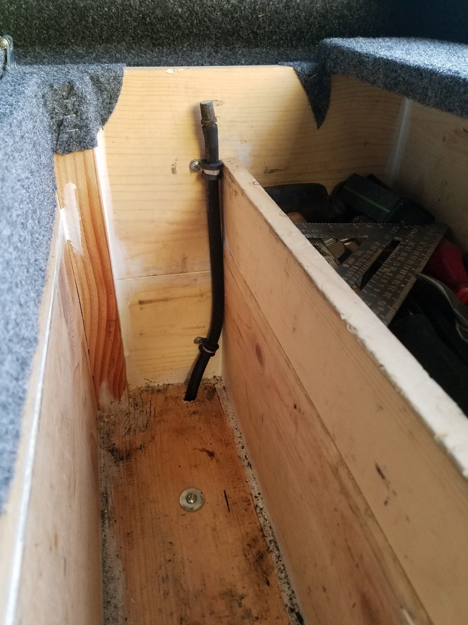

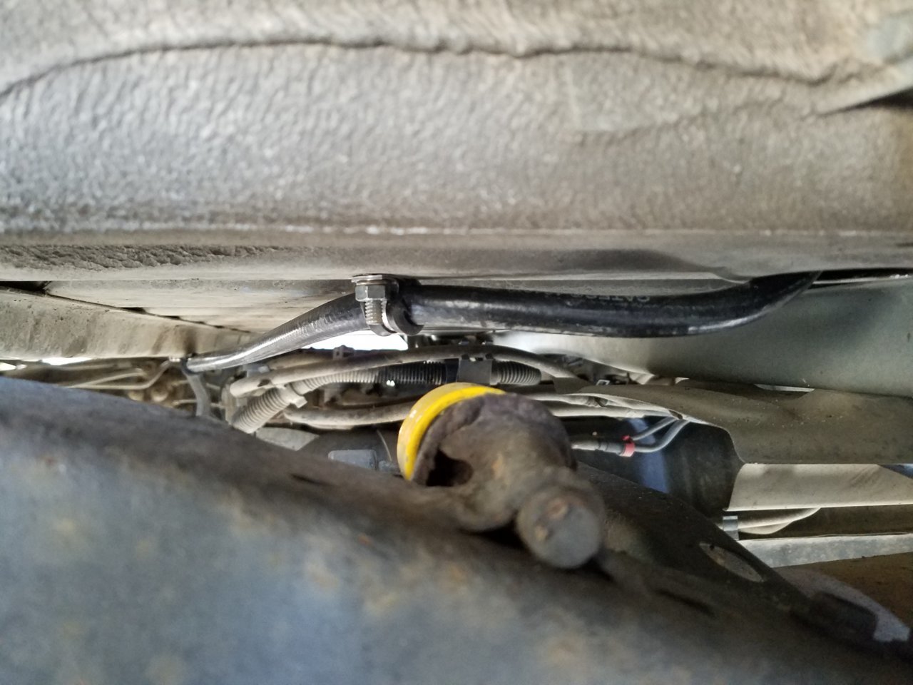

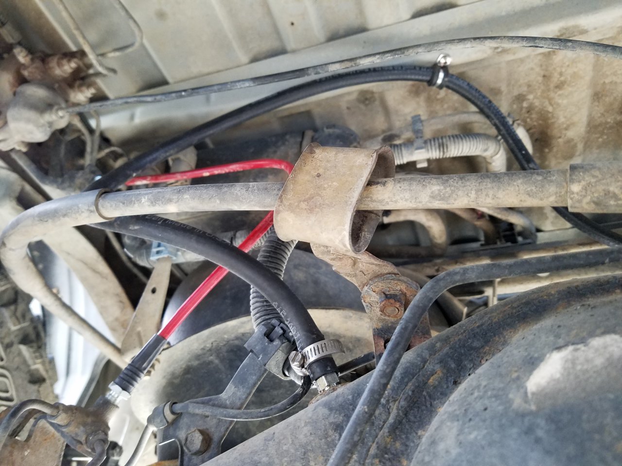

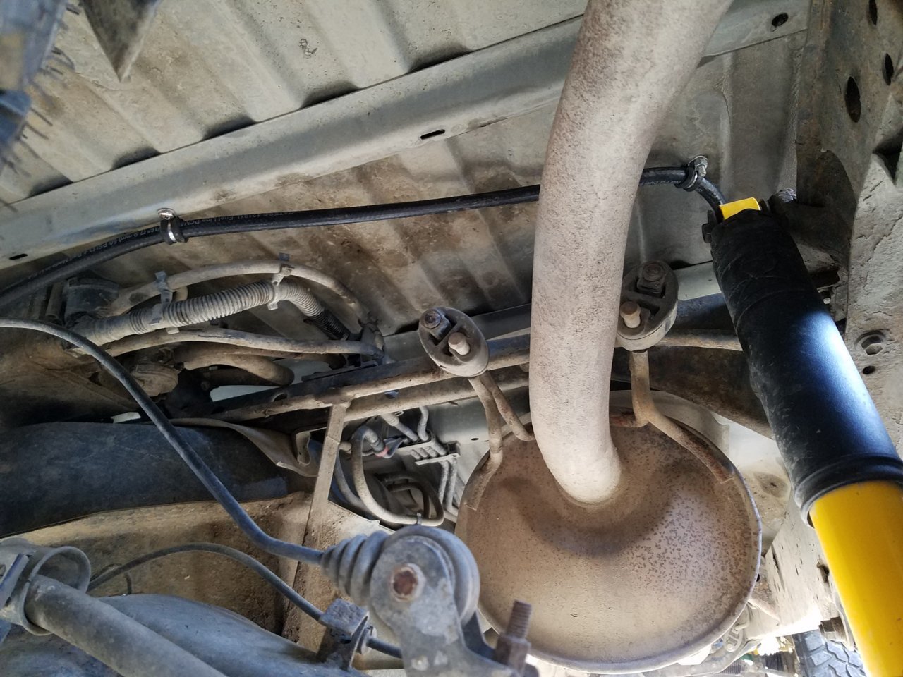

    Did a little work today I have been putting off.
    Rear diff breather mod, routed up to the inside of the tool box. ($20)
    Crazy shit was, when i took the factory one off the diff, it let out a huge hiss! It wasnt working at all!
    Kinda scary!
    Got the oem breather cleaned up and working again for a temporary cap until I find a solution I like.

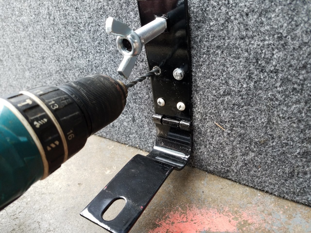

    Also , replaced the temporary screws holding the highlift jack in place with permanent ones. I was waiting to see if thats really where I wanted it mounted. It is ;)

    Well sounds like you caught it in time and didn’t push the oil out the seals
    Taco Roofer[OP] likes this.

    Maner
    Poolville Texas
    Everything looks great

    Eh... this explains the oil on the old wheels.
    I'm gonna dive into that next weekend and make sure they are still okay.
    I'll finish the tranny, transfer case and front diff breather next weekend to.

    Oh heck it was pushing it out

    Yeah. I think it might have been.
    Not the end of the world though, I'll flush everything, check the seals and just give it all a good once over.

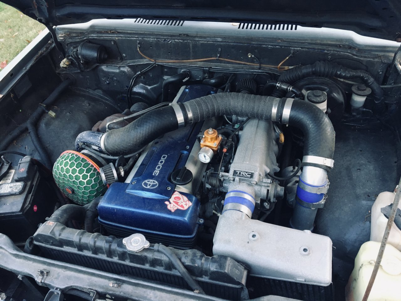

    Nicely done!
    That is a really clean job!
    I hate it when people swap and it looks like they just threw everything up into the engine bay! Lol
