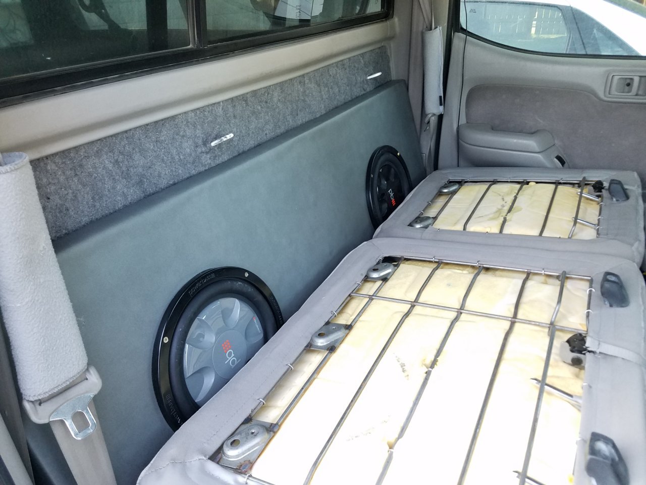

    Anywho, what's been going on with my rig? Really notta a lotta, I did upgrade the stereo finally. I got tired of hitting highway speeds and not being able to hear it over the humm of my 33's , my lumber rack and canopy!
    So I did what they said couldn't be done (at least that's what the local stereo shop said haha) I added 2 10's behind the back seats and threw 1600 watts on a 2 ohm setup at them!
    Yes, i can hear you now and feel you now lol... loud and f*cking clear
  3. Aug 29, 2021 at 7:41 AM
    #63
    Taco Roofer
    Taco Roofer [OP] Well-Known Member
    Feb 15, 2020
    #319348
    396
    Noah
    Southern Oregon
    2004 Tacoma 4dr 4x4
    The work beast and weekend warrior rig.

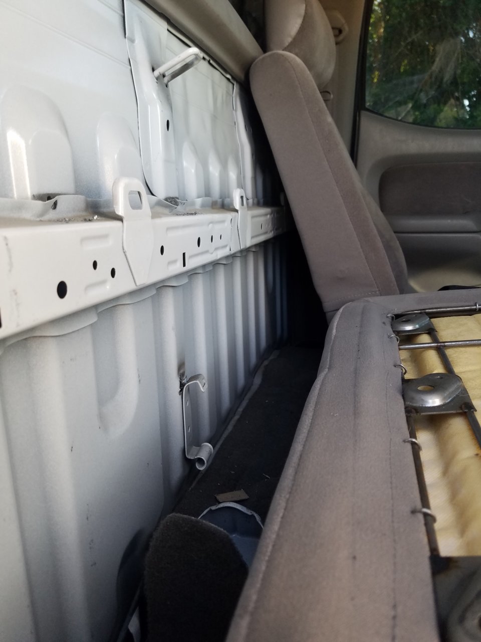

    Heres a few pix... if anyone wants the specs to build their own, let me know.
    The guy at the local stereo shop helped me set up the deck frequencys and when he cranked it he said "holy shit! This sounds incredible!" So I guess I did good figuring out my air specs and what not.

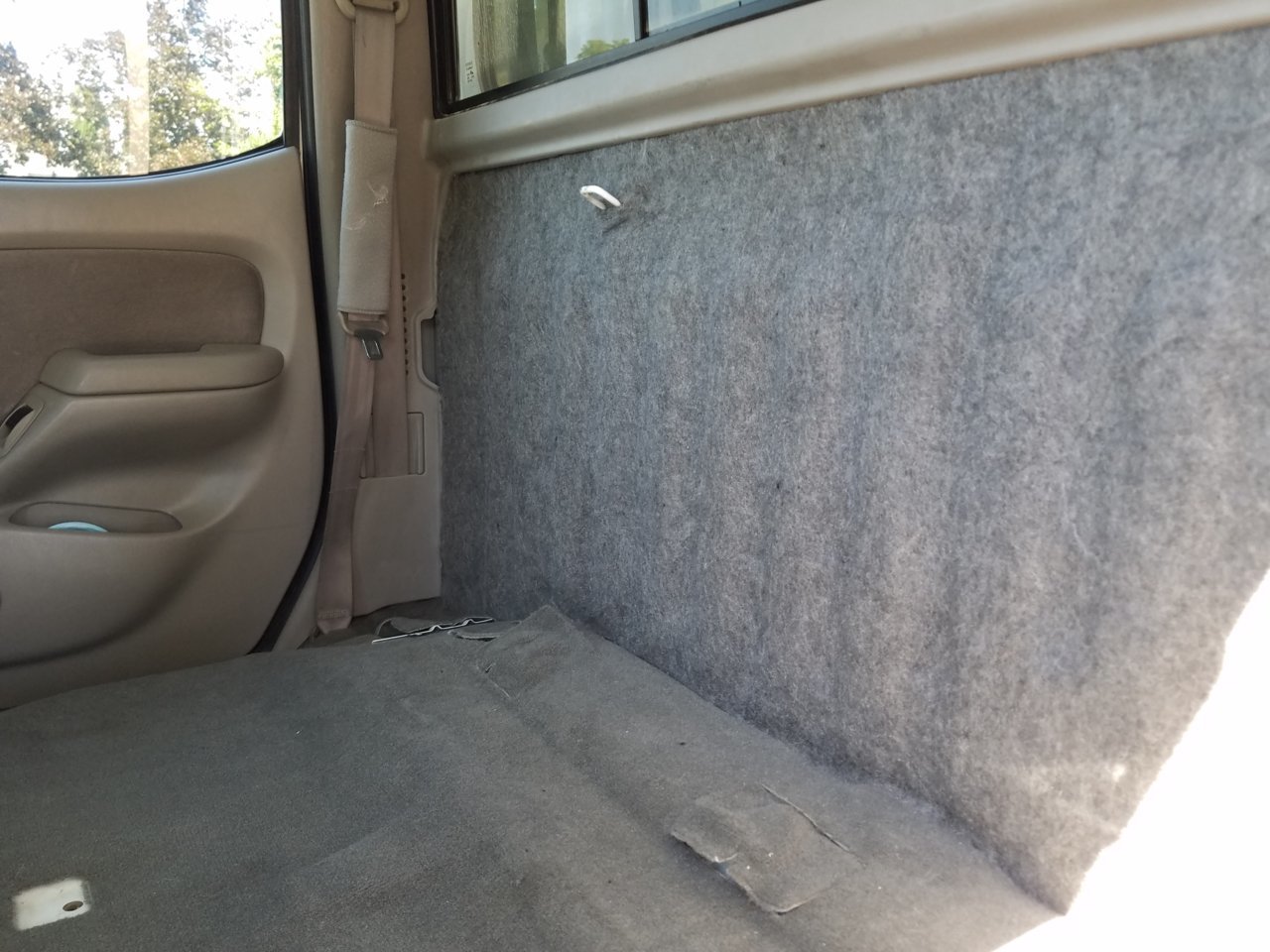

    Start by gutting everything behind your rear seat. Theres no room in these 1st gen double cabs.20200712_082456.jpg
    Next, throw in some mass backing to make sure your truck doesnt rattle like some riced out crackhead Honda lol.
    You'll have to remove the plastic backs on your rear seats... Oh the sacrifices we make.

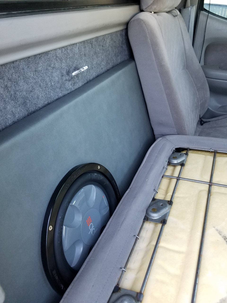

    Build your box, put in some cheap 10's and enjoy!

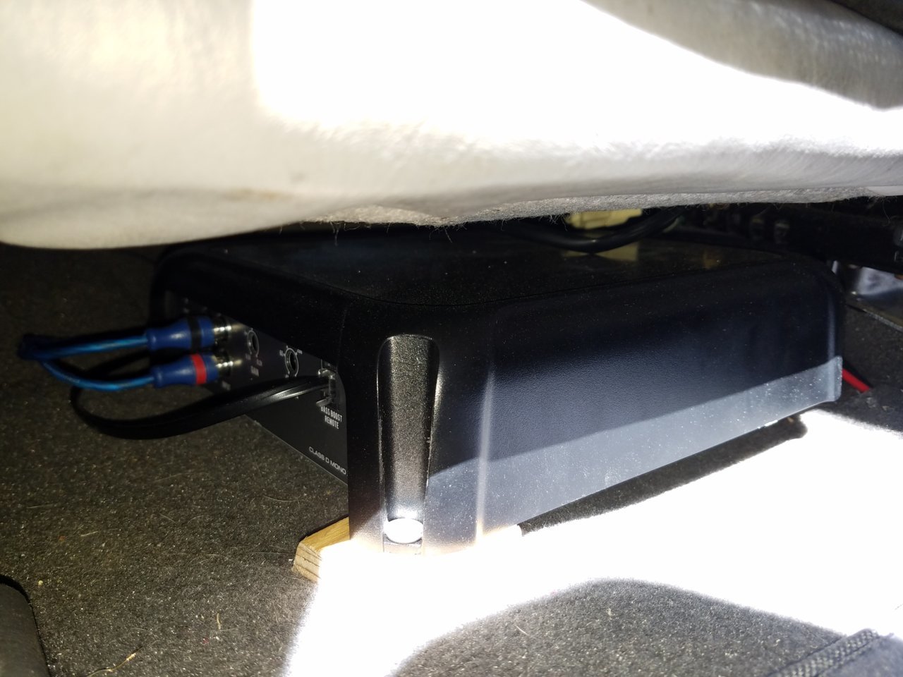

    I ran the amp under the drivers seat. A little shim of plywood helped lift it off the carpet so that air could circulate around it better and help keep it cool. Plus I didnt want any moisture getting to it, our 1st gens have a weird thing with collecting water in the winter just under the front seats.
    That's it!
    Took a day to build, a little trial and error and yahtzee! Now I can actually hear what I want when driving down the freeway.

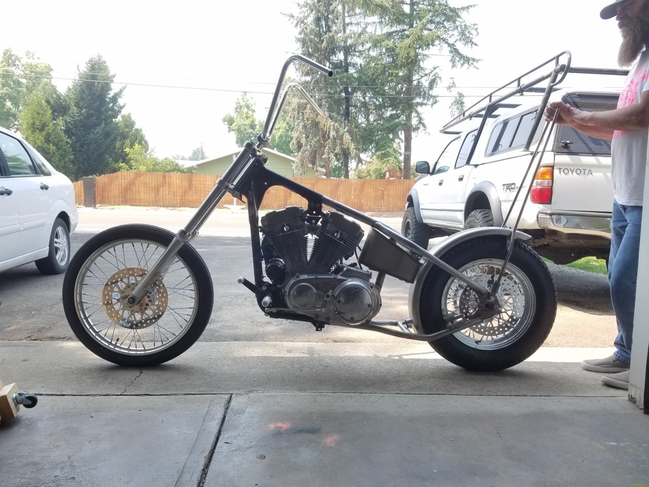

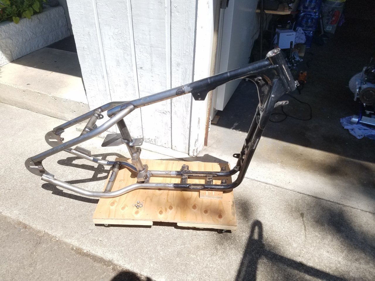

    Here's the my main squeeze right now. I picked it up in May and started stripping it down.
    It was a sh*t show basket case but the price was right.
    When I say stripped it down, I meant it.
    Heres where it sits last weekend. Still waiting on a few more parts to finish the mock up before it gets disassembled and painted.
    I'd say it's almost done but I'm gonna be putting it on the back burner for a bit as hunting season and a few Tacoma projects are going to be taking priority pretty soon.

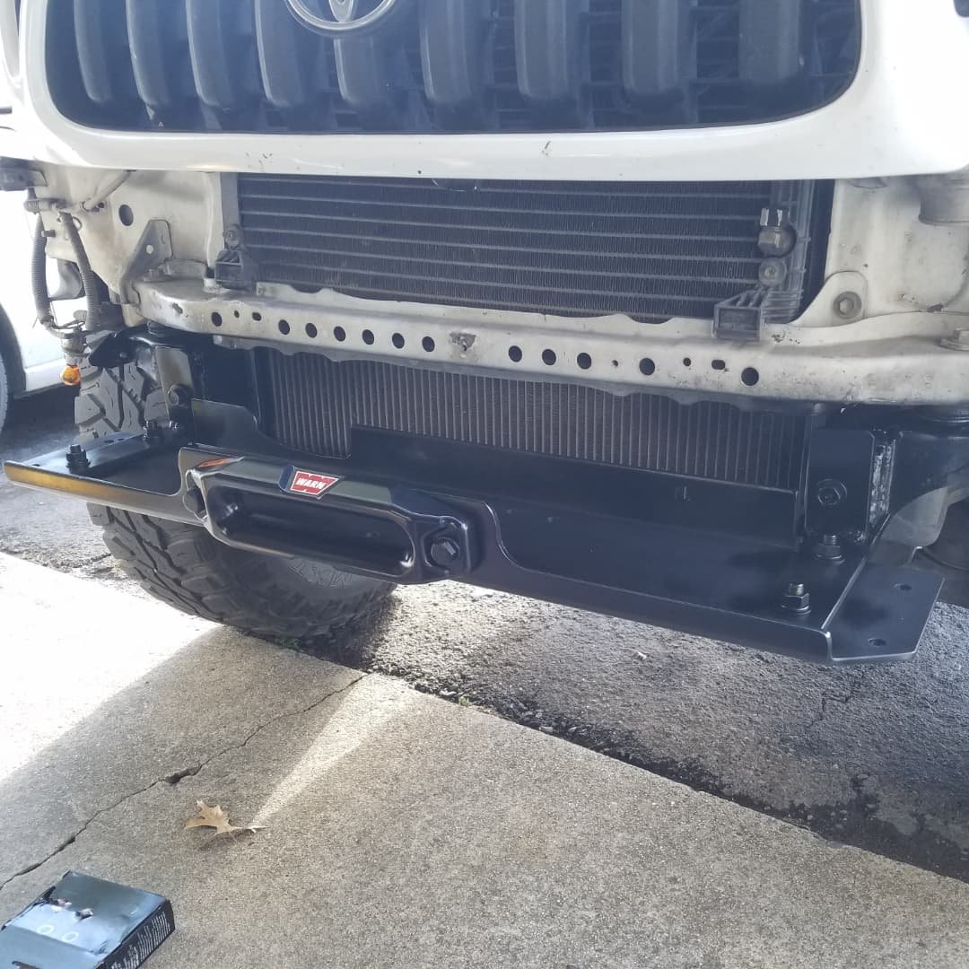

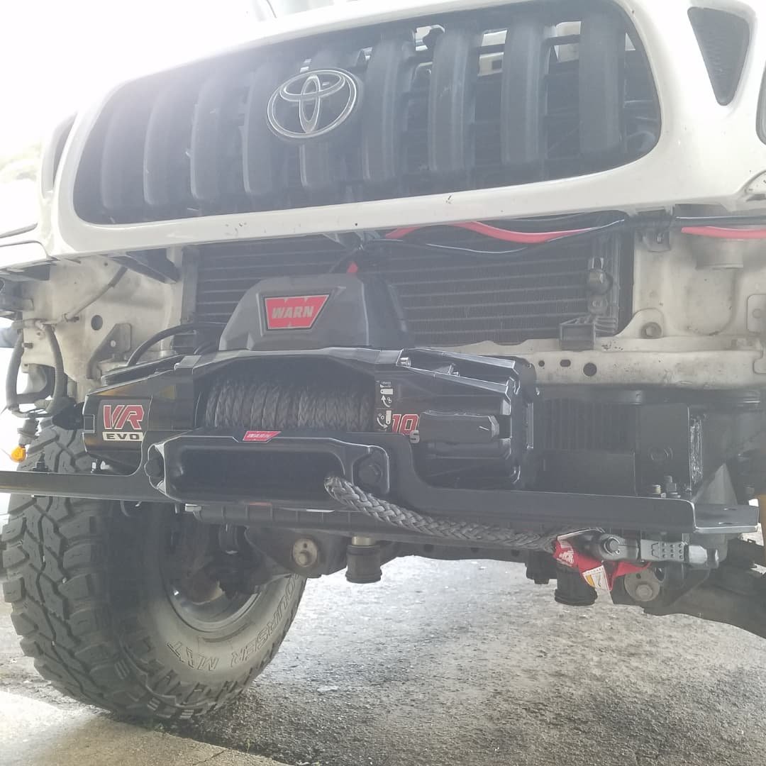

    Warn Evo 10S installed ...

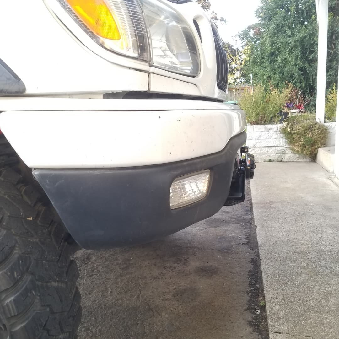

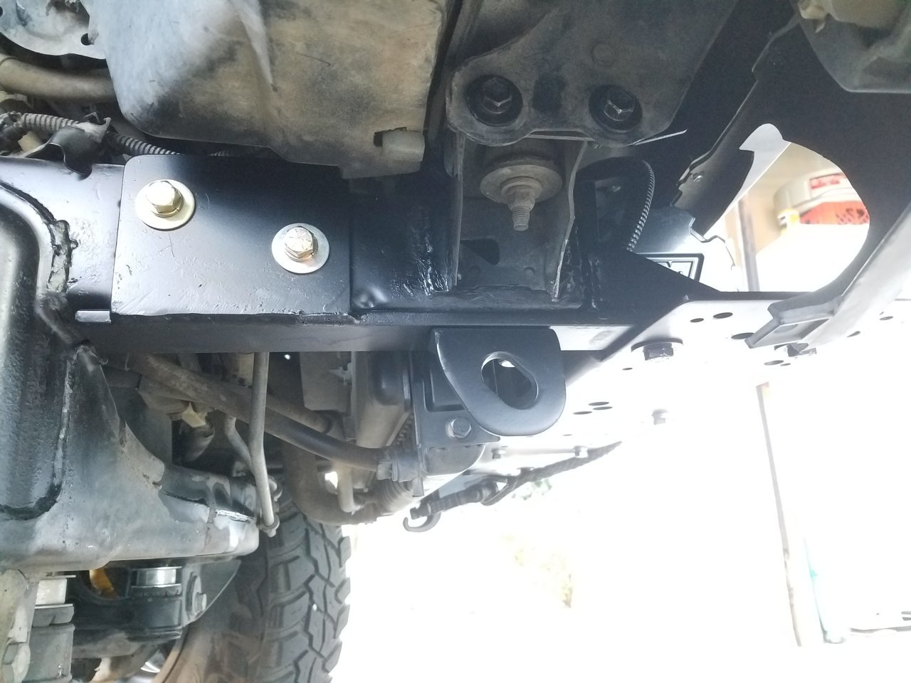

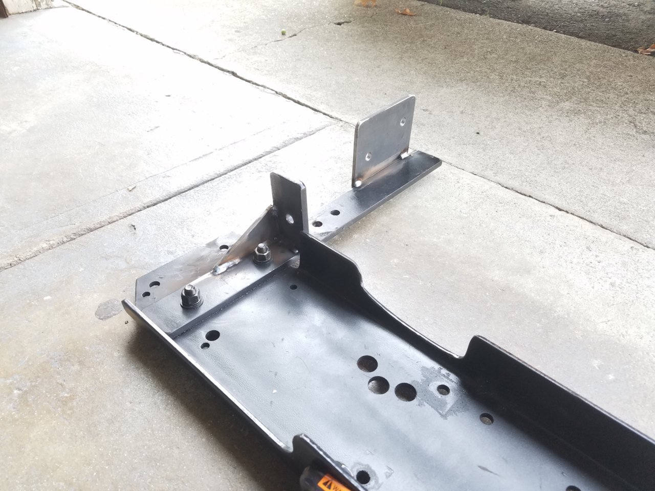

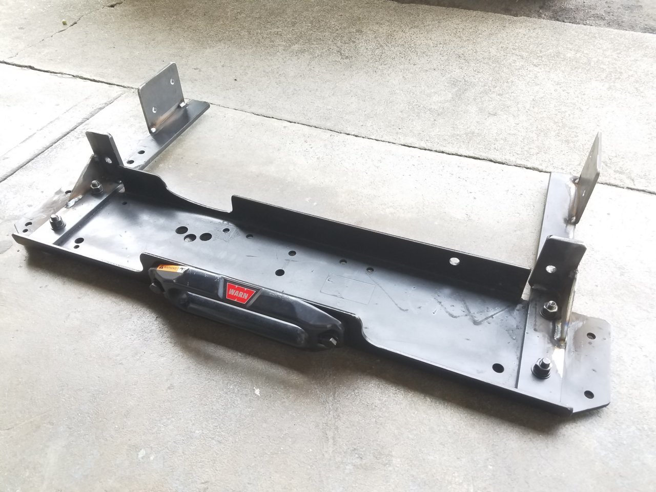

    Alright, I drove around last week with the winch mounted to see what wiring was going to rub and to think about adding additional bracing on the mount.
    End result, all the wiring rubs on these trucks lol, so everything got wrapped in loom.
    Additional bracing and the end product. 10 bolts total, 5 on each side. Should hold, we'll see.

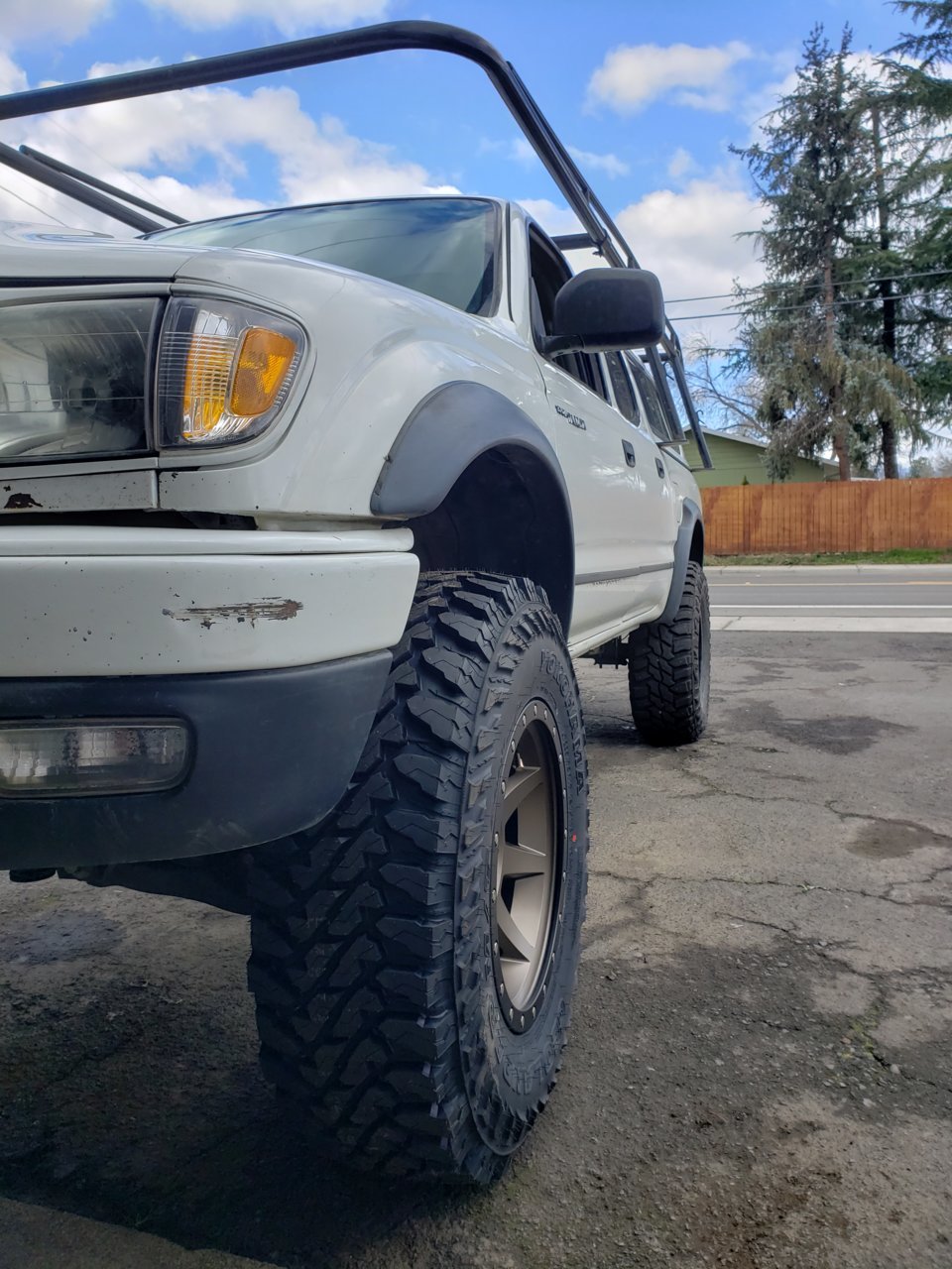

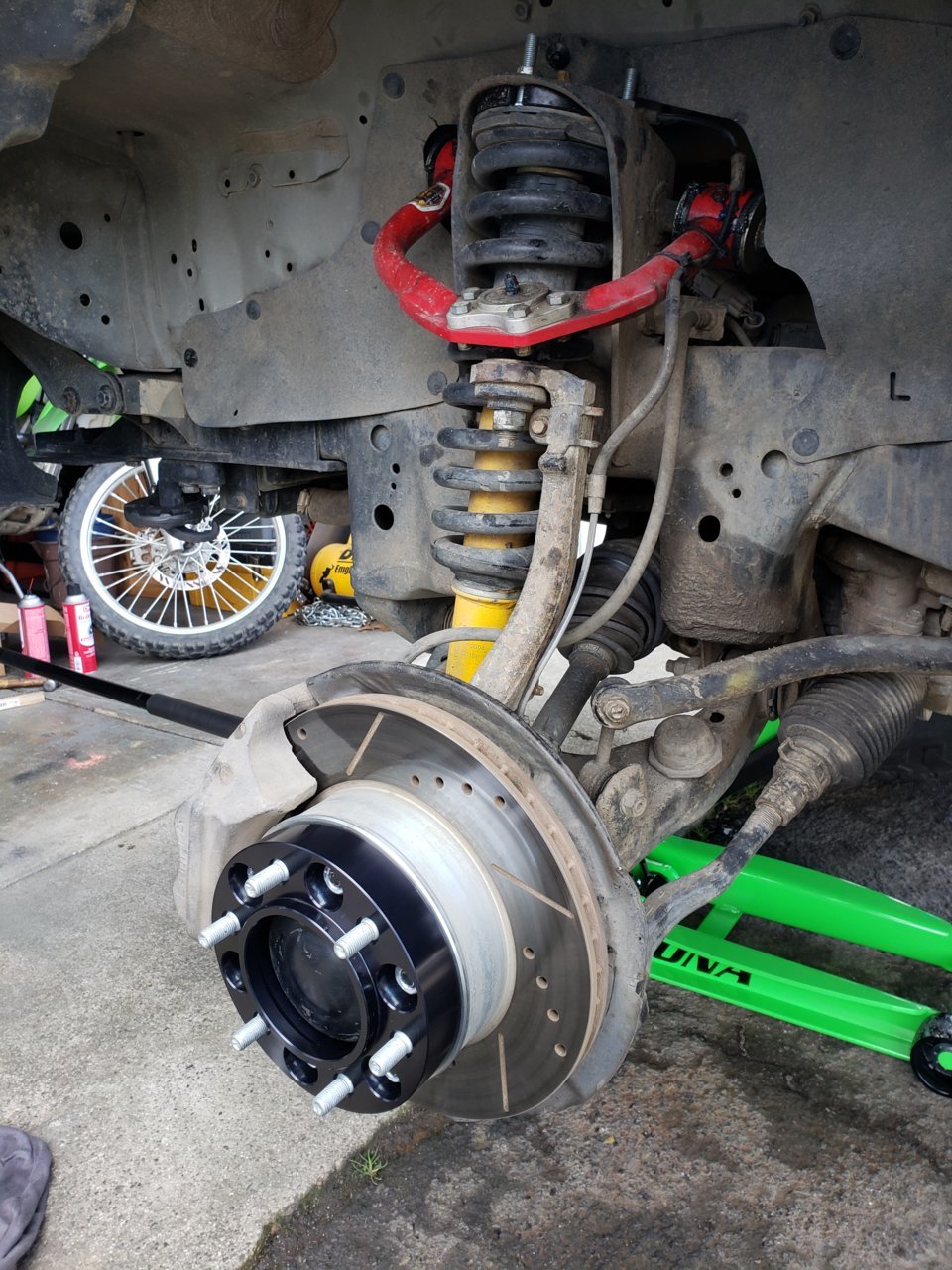

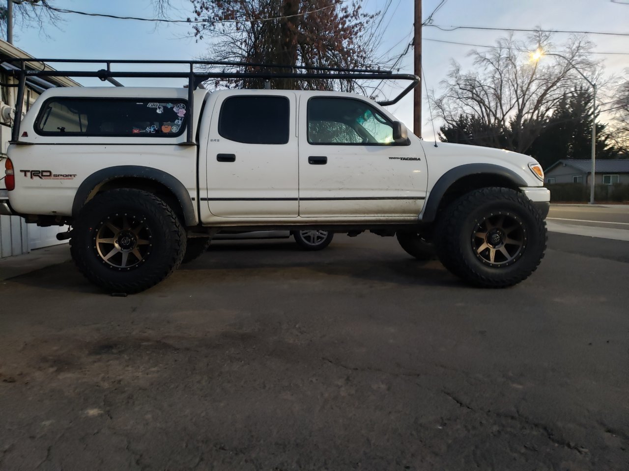

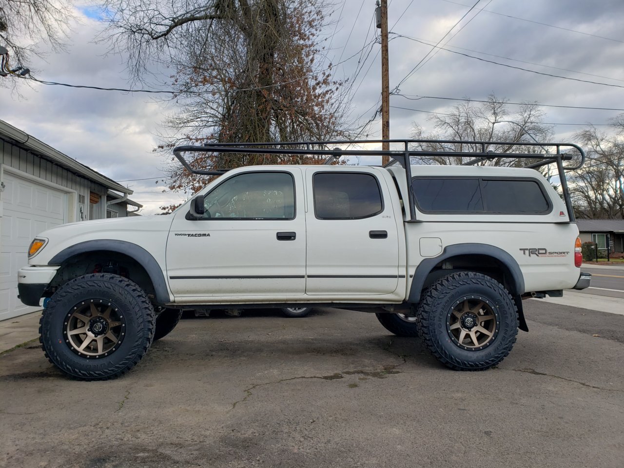

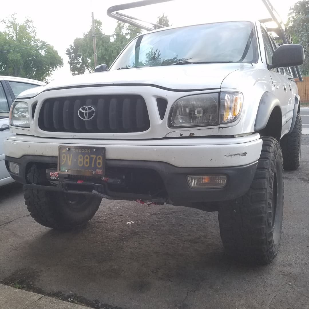

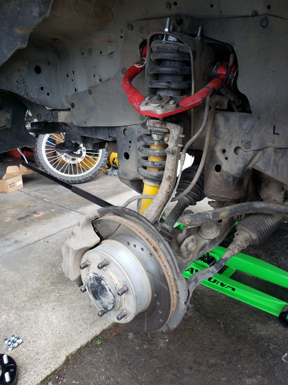

    Its been an incredibly busy last 3 weeks but more progress on the truck!
    *Installed new Lower Ball Joints
    *New Center Support Bearing (carrier bearing)
    *Installed a 1/2" top plate spacer on the front coils and longer studs on the coils
    *1/2" spacer on the rear leaf pack and longer U-bolts.
    *installed 1-1/4" Spidertrax wheel spacers on the front and rear
    *New wheels and tires.
    -Icon Rebounds (bronze) 17x8.5
    -Yokahama Geolandar G003 mt 285/75/17
    -Had to trim the plastic front bumper a hair and then do some more grinding to the cab side

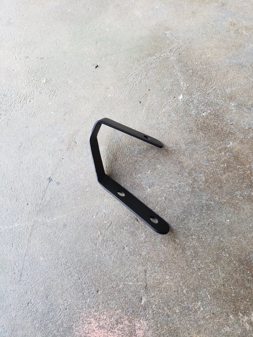

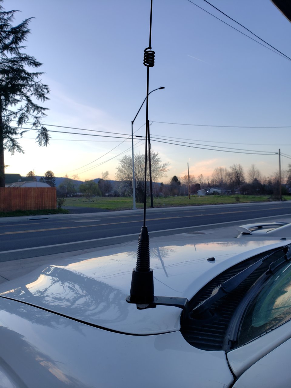

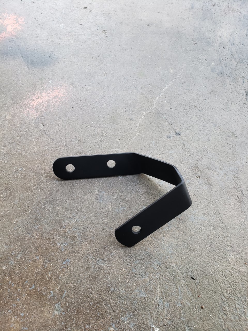

    *Fabricated a new antenna/ditch light bracket
    *installed a new 6db Midland gmrs antenna
    Measuring before and after, the truck went up another 2" overall. It now has a breakover angle of 31 which is better than it was. The truck already had a 3" lift on it but after it settled in I would say it was closer to 2.5 or a little less.
    And pix...
