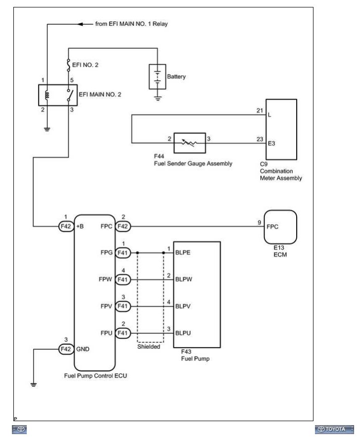

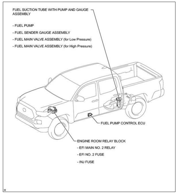

    There is no official fuel pump relay. There is a fuel pump control ECU mounted to the frame on the left side ahead of the tank. Under the doors. That fuel pump control ECU has a connector on it that is power, ground, and fuel pump control. Power comes from the "EFI main no. 2" relay which is in the box under the hood. That relay is triggered by "EFI main no. 1" relay which is also under the hood. Ground is just ground. Fuel pump control "FPC" comes from the ECM. I'm not sure what exactly the ECM sends to operate the ECU. Not sure if it's a ground control, 12V, etc.
    In the high pressure fuel pump section of the FSM, there is a portion that tells you to turn the pump on using techstream. Not sure if that works on the in-tank pump or only the high pressure direct injection pump.
