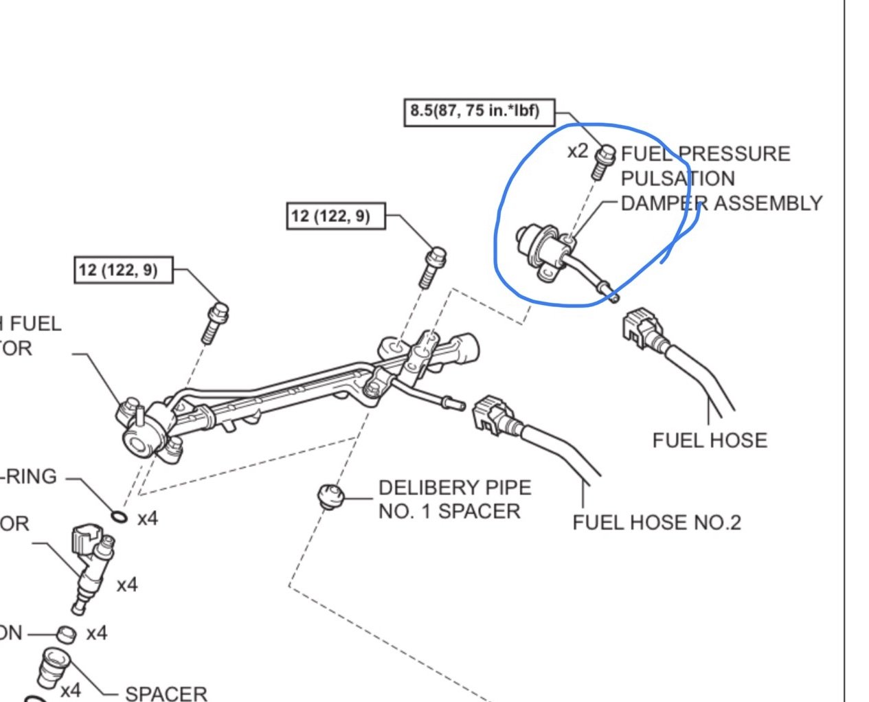

    60 psi?
    The pressure should be no more than 42 psi.
    The Fuel Damper is before the regulator. It’s possible it may be bad.
    But I haven’t heard of one failing often.

    Where would that damper be located?

  12. Mar 3, 2020 at 5:11 PM
    JuanLocoTaco06
    JuanLocoTaco06 [OP] Member
    Dec 12, 2019
    #313187
    20
    2006 Sr stock everything
    Fuel hose no 2 has fuel coming out and that's the port i tested from and fuel does come out from here. But i install that fuel hose no.2 onto the fuel regulator and crank it and get no fuel out of the exit port of the regulator and this is with me not installing it back onto the injector rails and just cranking to see if I get fuel up to that point

    If you dead head the pump the pressure will read in the 60's range. To check fuel pressure you should tee into the gas line.
    I don't think you are looking at the regulator correctly. The only time fuel should be going past the regulator is when it is bypassing.
    Basic fuel pressure regulator circuit:

    Install a Tee between the Fuel Hose and the Pulse Damper Assy and connect the gauge there to read fuel pressure.
    Fuel hose # 2 goes back to the tank from the rail downstream of the regulator.
    This is the loop:
    Fuel Tank >> Pump >> Fuel Hose >> Pulse Damper >> Rail >> Injectors >> Regulator >> Fuel Tank.

    Really I thought it went tank pump hose 2 to regulator rail damper hose 1 back to tank...

    It would be working backwards.
    You would have very little fuel pressure that way.
    Here is a better explanation.
    https://www.turbosmart.com/news/how-does-an-fpr-work/

    What color is the fuel hose no. 2 green or yellow? Those hoses have tabs on it and are color coded. Just making sure they are going to the right location.
