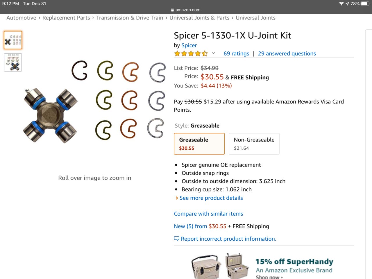

    Or, instead of purchasing an older truck, just install these joints with fittings on the 3rd gen.10C3D04F-1447-4FE3-8AE9-607E059ADE56.jpg

    Oddly enough, my other truck has non-greasable ujoints, has towed, has been in mud. And at 148,000 miles, the joints are fine. Maybe you need to adjust your expectations to match advances in engineering and manufacturing. We used to grease ujoints all the time on trucks growing up, but things change.

    So true. It could go 15, or 20 years with sealed joints.
    But, for those people who own a grease gun and like to spend some time checking out the underside of their truck, greasing can’t hurt. And maybe it’ll make it to 300,000 miles on the same joints without problems.
