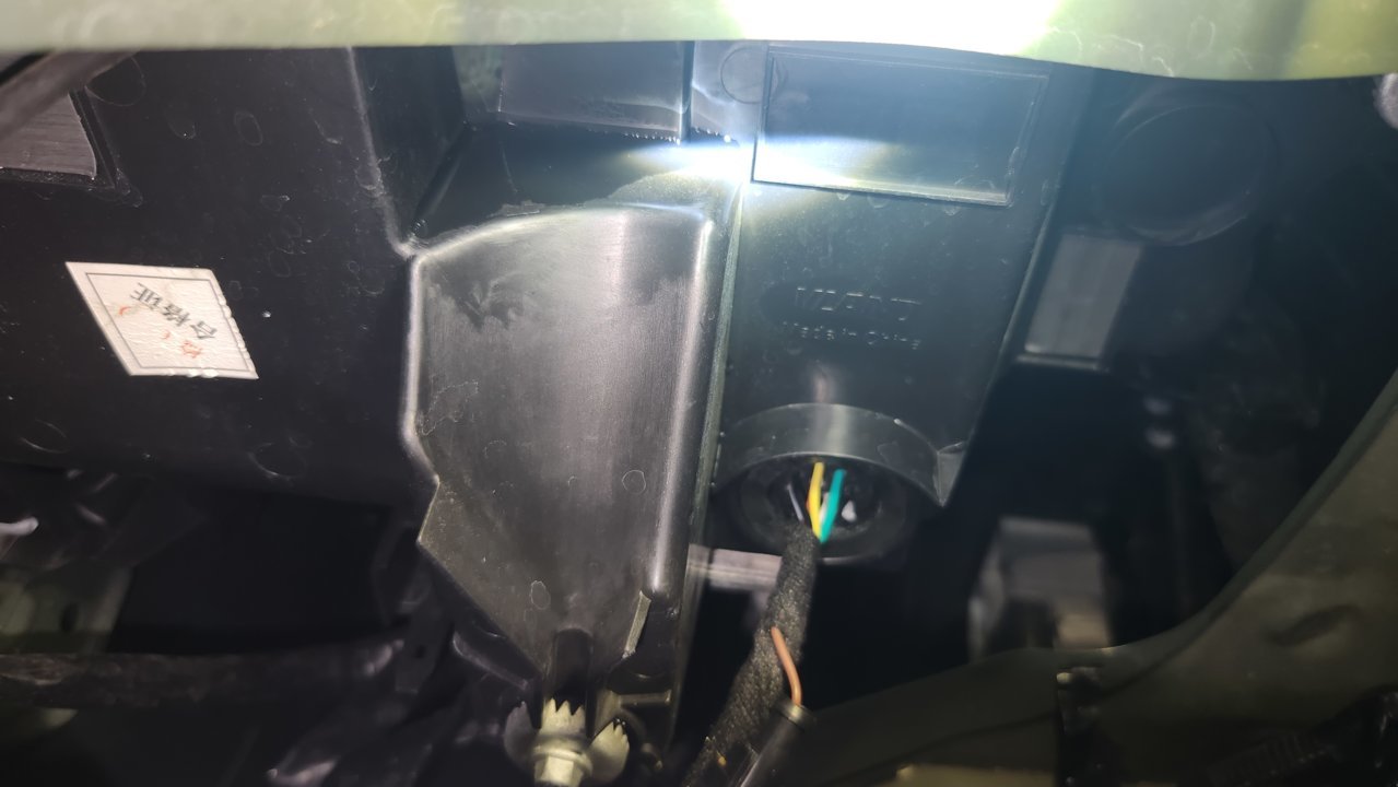

    Hi,
    Ive got a 22 Tacoma TRD sport and its headlights really suck. I ordered new bulbs but to my surprise couldnt find them on the back of the headlight housing. It looks like its already got LEDs. Is this oem? The manual shows the bulbs like Im expecting.

    The LEDs are not replaceable and are the gold standard. Are those LEDs OEM?

    Those appear to be the OEM LED headlights. They are pretty much the best headlights as far as light output goes for our trucks. Not sure why they aren't providing enough light. Is the truck lifted? Are they aimed properly?

    You only have three reflector buckets for low beams, OEM has 5, first sign it's not OEM. And the wiring doesn't wire in like that in OEM

    He is correct, those look to be aftermarket knock offs and likely explain the poor performance.
    Swap those out with Toyota LEDs or go back to the cheaper Halogen housings and run H9s.
    The stickied thread on 3rd gen lights is a good read as to why you don't want to put just any old light bulb in.

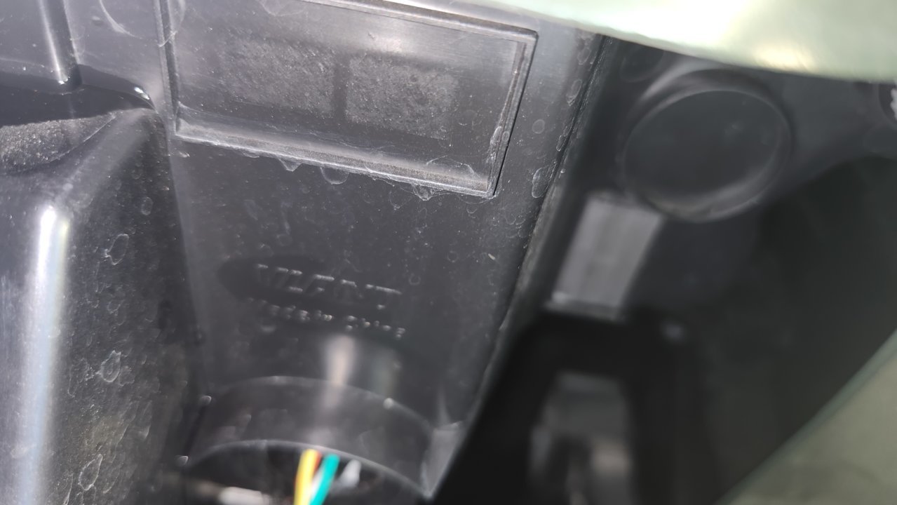

    Taking some more pics...it says "made in china" stamped in the plastic mold... why would someone replace this? 20230731_152448.jpg 20230731_152350.jpg

    Because they assume brighter whiter LEDs are always better.

    Looks like someone just liked the look and got them on Amazon or the like
    https://www.amazon.com/VLAND-Headlights-Generation-Reflective-Plug-n-Play/dp/B08HN8P5HJ?th=1
    They probably are junk for light output, as you noted....so finding any OEM assemblies is probably the best course of action.
