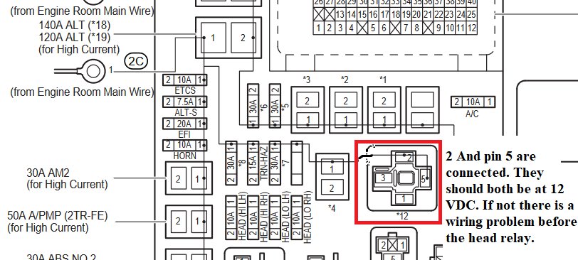

    This may help: The white wires ( Low Beams ) and the red wires with the black stripe ( Hi Beams ) goes to the headlight fuses in image # 2.

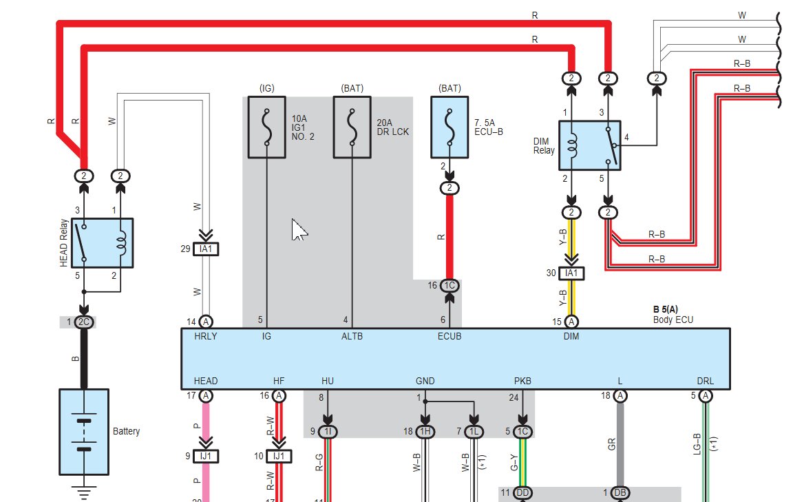

    If you look at the schematic I posted earlier. The Head Relay should have 12 VDC at Pin # 5 and # 2 ALL the time if the battery isn't dead.
    The Body ECU Controls the ground for relay via the white wire terminal # 1 when you turn on the headlights via the stalk.
    The relay should close when this ground happens and provides 12 VDC through the Red Wires to the DIM Relay Contacts and Coil.
    The DIM Relay selects either High Beams or Low Beams as dictated by the stalk through the body ECU. If you have low beams selected by the dimmer voltage will go through terminals # 3 to # 4 and then on to the fuses and the bulb sockets.

    You should never see 12 volts at pin # 1 as it is the ground return leg for the relay coil through the body ECU.
    It is good that when you jump terminals 5 to 3 the headlights work as normal as that removes everything downstream as working correctly. The problem seems to be in the control circuit and not the light circuit. So yes, the switch is a definite possibility.
    I would first make sure that the terminals are not pressed out the bottom of the fuse panel and are making good contact as having to press on the relay seems odd like it isn't plugging in correctly. Or the white wire between the relay coil and the body ECU or one of its terminal ends.

    Considering all that you have done I only have one other idea and that is the body ECU behind the interior fuse panel junction box. That is probably where you are hearing the clicking from.
    If you remove that lower panel and get in behind the fuse panel you could check for a poor connection on a plug or something. The Body ECU is also behind there.

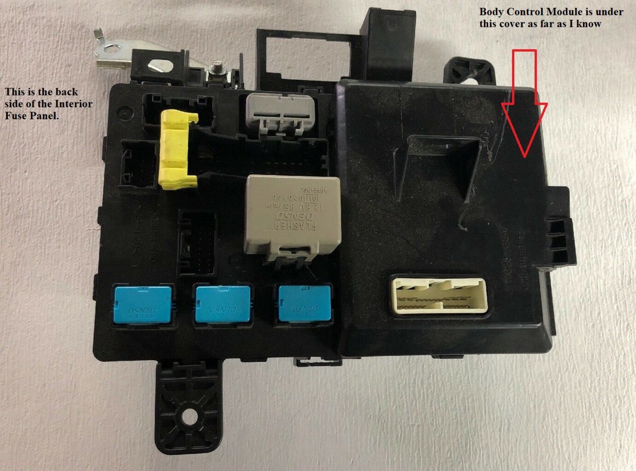

    Update: still no luck. There's no body ECU hiding behind that in-cab fuse panel, just a circuit board, looking for them on the web makes it look like a standard sealed up ECU.
    The best reference I can get to one is from the diagram below but Toyota won't give me the option to buy it or the full part number just the first half of the number, 89221 , looks like it's on the left of the foot well and not behind that fuse block? https://parts.toyota.com/a/Toyota_2...1571/SWITCH--RELAY--COMPUTER/674470-8401.html

    I'm pretty sure that circuit board on the back of the interior fuse panel is the body control module.

    Update: After several weeks of waiting I finally received a pre-enjoyed under dash fuse panel which includes the Body Control Module on it's backside. When installed, solved all issues immediately. Not even a need to re-program the key fob. Hesitant to reconnect the remote starter module, still no clue as to what caused the Body Control to fail!
    For troubleshooters in the future: Jumping the Head relay terminals 3 and 5 in the engine compartment allowed me to confirm that everything downstream of the under hood relay was working. Plugging in (no physical ground so no need to install) a new column switch allowed me to eliminate the switch as the issue. Local NAPA took that $155 switch part back with a 10% restock fee. No Key Fob functions, Windows that worked regardless of key in or out, and a fried heater fuse under hood, all pointed the issue at that buried module under dash. Stress and annoyance expense can't be calculated...
