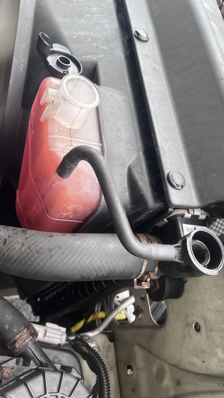

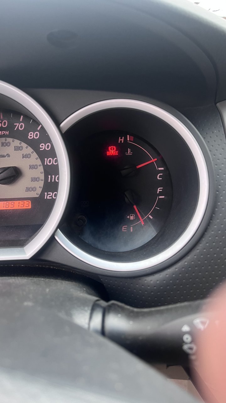

    First off I know there are probably plenty of posts with similar issues but I’m out of town and looking to pinpoint this issue and haven’t been able to find the same problem.
    I think I have a thermostat issue.
    2010 2.7L 5 spd
    I live in NY
    Stopped at a rest area and when I restarted the truck the engine temp went up slightly but I had no heat. As soon as I gave it throttle, engine temp went back to normal, still no heat.
    I had somewhat warm air a couple times when driving and engine temp stayed normal. After shutting truck off I watched coolant temp and it rose slightly again.
    checked coolant hoses, bottom hose had no pressure and top hose felt stiff.
    Coolant reservoir was at max level line before the trip but was filled all the way up to the cap when I stopped. Also noticed some bubbles slowly entering the reservoir when checking things over. I have found no leaks so far.
    Checked oil didn’t notice any coolant in the oil or oil in the coolant.
    Any help would be great, just trying to fix this issue and make it home in a couple days

    Update: started the truck this morning, radiator looks like it might be low, reservoir tank is still over full(it wasn’t before the heat went out). Both heater core lines through the firewall were warm. Ran truck for around 20 minutes with radiator cap off. And never got past 1/4 on the temp gauge. It would actually drop I small amount if I gave it throttle. Had some heat this morning. The two main radiator hoses never got warm. Going to pick up a thermostat and drain and fill the system. I’ll update again later and thanks again everyone, not fun breaking down away from home.

    Doolars to donuts, your thermostst is stuck open. I'm curious as to why the resevoir would overfill.

    If there is a leak somewhere the coolant will get pushed into the expansion tank when warming up, but when it cools down instead of sucking the coolant back into the radiator it will suck air in through the leak. So you end up with empty space under the rad cap and too much coolant in the exp tank

    Woofer2609 that’s what I’m leaning towards, and the overfilled reservoir had me wondering to.
