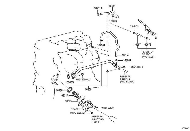

    Picket up a coolant filler funnel and the thermostat and gaskets I’m burping it now I have heat back and it hasen’t overheated yet. Also used a blaster and took the extra coolant out of the reservoir

    Where is the bypass pipe I haven’t seen that yet
