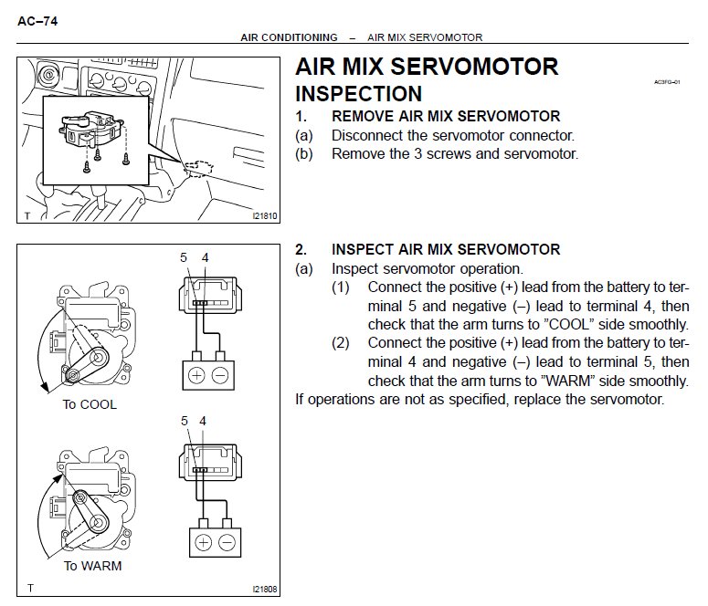

    You're going to have to take a close look at the servo motor. While it's possible your cable is seized inside the sheathing it is way more likely you need a new servo motor. When diagnosing mine I removed the cable from the arm on the servo motor, left the electronic connector connected an pulled the 3 screws holding the servo in place (phillips head screwdriver and a mirror - stubby phillips head helps a lot on the screw in the back) . Then while holding the unit in my hand turned the dial from cold to hot and the arm did not move. At this point you can try to move the cable in the sheathing - mine moved back and forth easily by hand so I knew it wasn't seized. But the arm not moving also meant the servo was kaput.
    I'm not an expert but I believe the servo motor does 2 things - the arm moves opening the valve on the firewall letting hot coolant into the heater core. It also directs the airflow through the heater core. So if it's not working then even though you opened the valve by hand the blend door still has not moved to direct the air through the heater core. Therefore no heat. Do a search on the autozone website for "blend door actuator" and put your vehicle info in. Can probably find one on the shelf at a store near you and I believe they're about $40.
    This is not "throwing parts at it". If your cable isn't seized in the sheathing and turning your dial from hot to cold doesn't move the cable then you need one of these anyway. You can also test it per the FSM procedure.

    Well I pulled the motor and checked it out, it does operate like it should but everything that the motor operates is very sticky, so I worked it all a bit and got the truck to blow heat. I need to use some wd40 or something to lube it all up.
