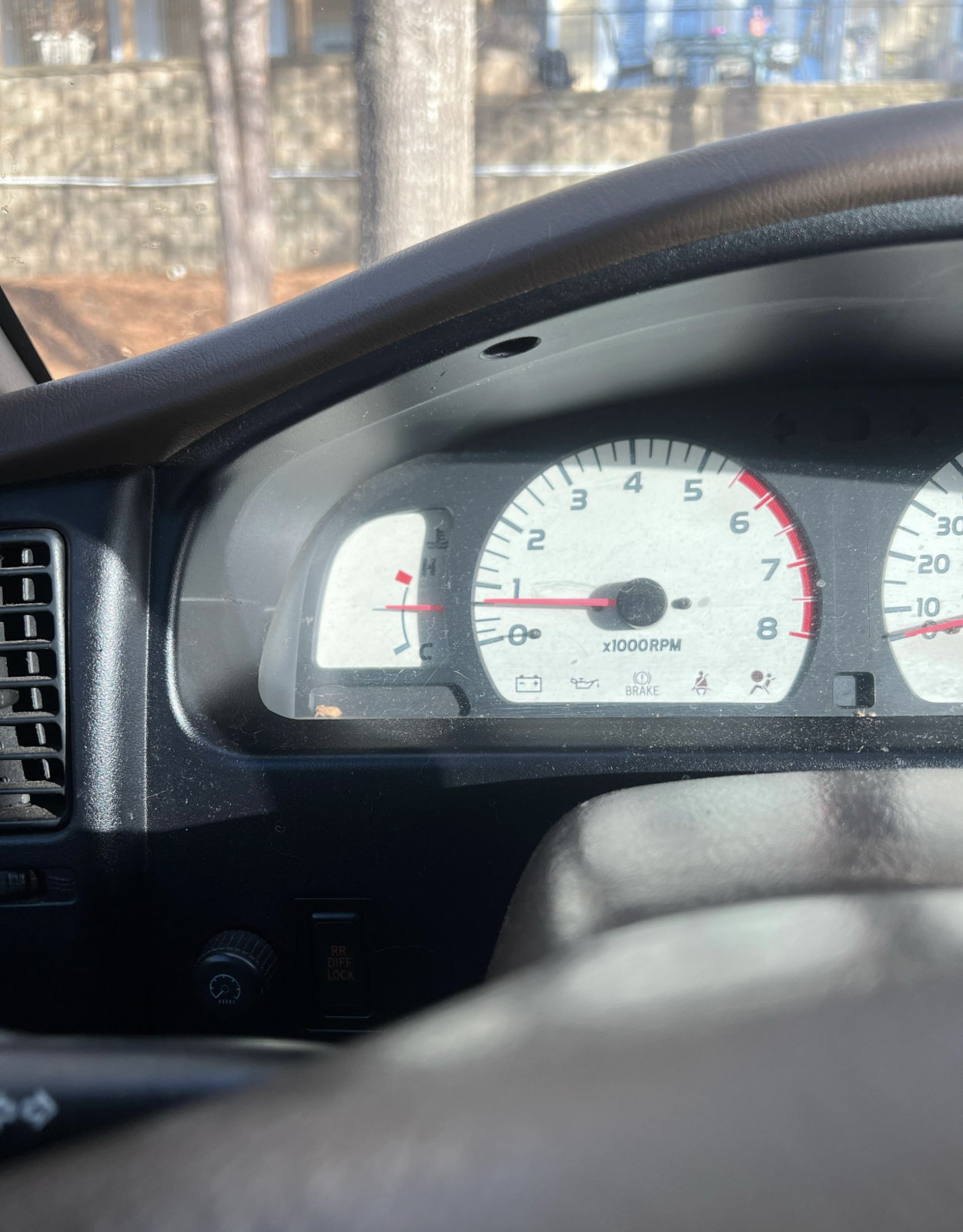

    It is almost January and I still have no heat . Right now the only thing I’ve done is flush the coolant and heater core assuming that was the problem and when I flushed the coolant and burped the system and then flushed the heater core I had heat for about a day or 2. It looks like I’m getting coolant to and from my heater core and my valve or whatever it’s called for my heat functions properly . I get good blowing ac but my heat doesn’t work , and when the heat is on it blows super weak and isn’t really hot . Someone recommended a thermostat first , I was just about to replace the heater core but not anymore until I verify a problem. The needle sits a little high and it’s making me frustrated. Please help I’m FREEZING

    A stuck open thermostat wouldn't allow the truck to warm up or atleast it would take forever to get to temp in these now winter temps. A thermostat stuck closed would cause overheating or a quick rise in eng temps. Although I don't believe the thermostat is your issue it doesn't hurt to change it. You flushed the heater core so that's not it. How's the coolant levels when the truck is at operating temp? If levels are good it could also be a failing water pump.

    So I’ve always had a good coolant level. And the temp isn’t the only thing that increases with rpm’s, it blows harder. I was thinking of flushing the coolant system again and getting a new heater core just because I don’t believe the coolant has ever been replaced . So I will try that spill funnel . And the coolant system itself just seems really dirty so I am going to try and super flush the system . Along with a new thermostat just for the needle gauge problem.but I want to entertain that water pump idea , could it be failing and only operating properly at higher rpm’s?
