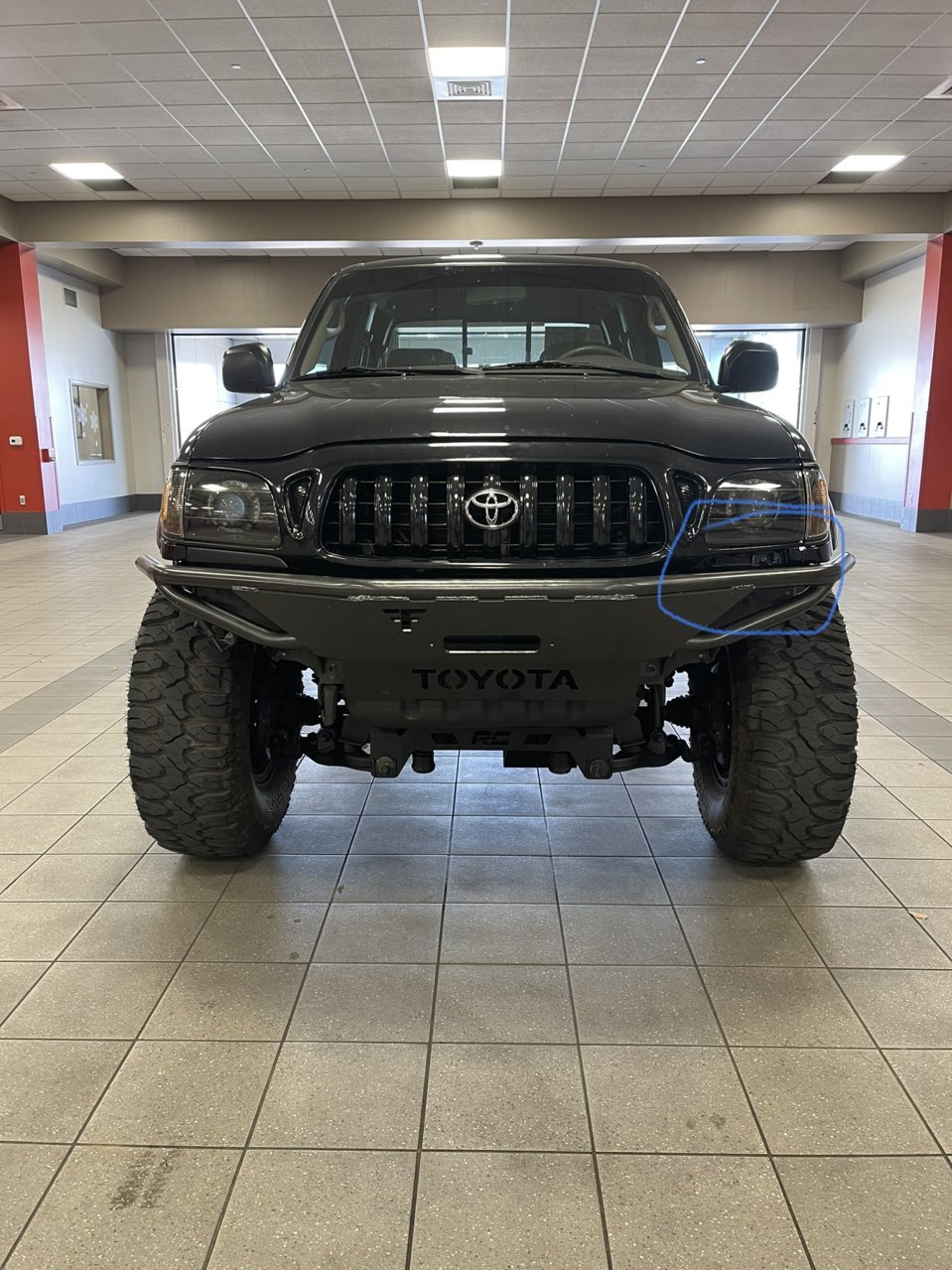

    First post! New Toyota Tacoma driver and been loving the journey so far but I have small issue that’s not allowing me to pass vehicle inspection and I believe the problem for the high beam indicator light is not appearing on dash because of the aftermarket headlights and the way it’s wired, I bought the vehicle like this and learning as I go!
    And I do believe for the check engine light bulb can be replaced but I hear it’s difficult to get too but anyways would love some feedback hope to hear back!

    For the headlights, disconnect the battery before playing with those. If they are HID could be high voltage going through them. I'd disconnect the oem plugs where they meet the aftermarket wiring. Install OEM spec bulbs/sockets to the oem wiring. See if that resolves your issues. Might be cheaper to just buy used headlight assemblies with bulbs.

    You'd have to do some digging on which aftermarket headlight system is installed to know if it supports proper high/low wiring, but I'd be willing to bet it doesn't. So as the others have suggested, get yourself some aftermarket housings, and convert that back to stock until you can do a proper upgrade.
    What makes you think your check engine light is out? Does it illuminate at all between inserting the key into the ignition and starting the truck?
    If it's out, it might be out because someone wanted it to be out. If you have a ODBII reader, hook that up and see if you have any codes. You want to make sure the seller/previous owner is not hiding anything else.
