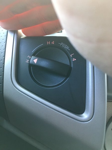

    That's a mod for the 4x4 knob lights? It looks great! How did you do it?
  18. Dec 3, 2015 at 12:20 PM
    #18
    Dckr3w93
    Dckr3w93 Member
    Sep 6, 2015
    #163568
    16
    Jordan
    2005 silver Tacoma TRD sport access cab
    Nitto trail grappler 265/70/r17 tires BHLM Yellow fogs Double din radio

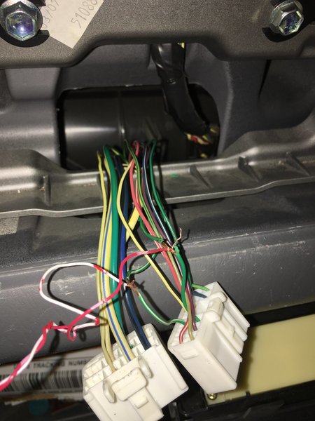

    A guy on here sells them if you want the link I can give you it. He sells the stock color for 35 and custom color I think is 45. All it is is an LED board that you put inside the 4x4 switch and two wires and wire them to the AC wires

    Yes that was before I was all done lol it was to show someone else how I wired them lol.
