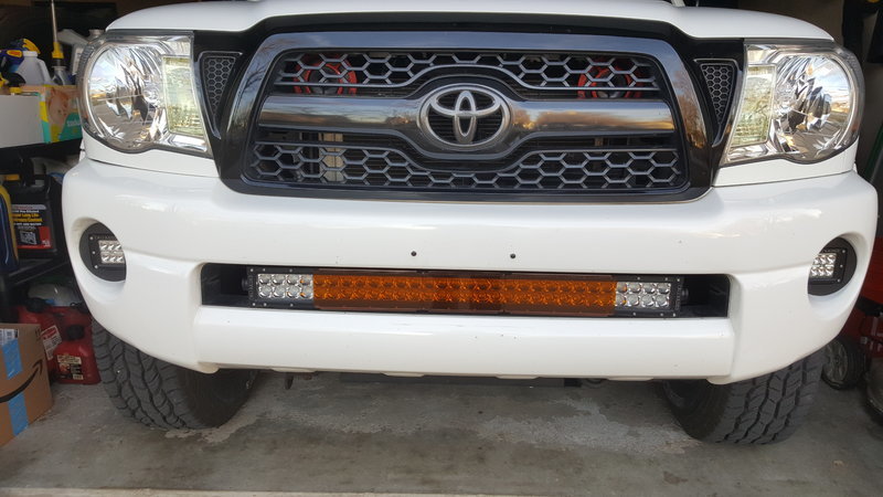

    In case anyone was curious, Apex and n-fab is possible. Because we all need more lights!

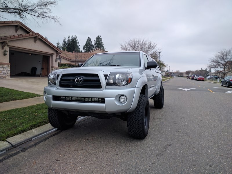

    I bought these brackets along with a 30 inch light bar from a forum member and I do have to say, these brackets are worth every dollar, bolt right up and the fitment is 100%, super easy install and all you need to remove is the grille to get access, which takes less than 5 to remove, would definitely recommend these and love this stealth setup a lot!
