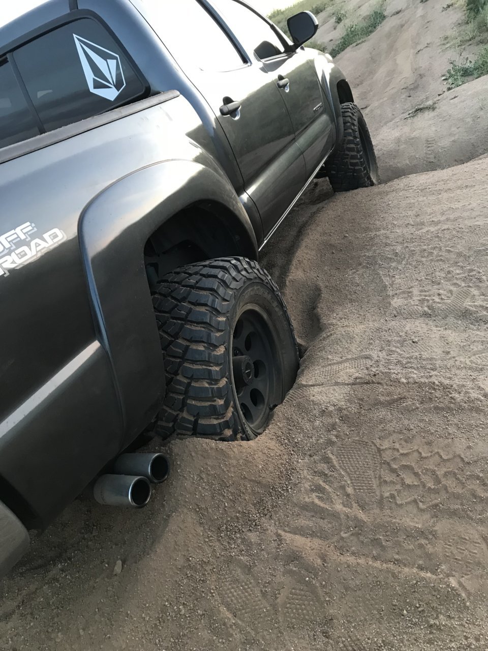

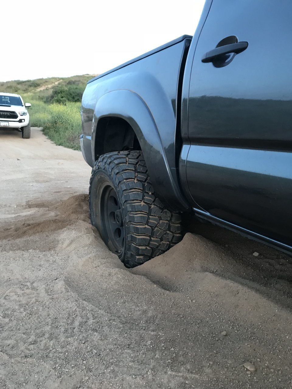

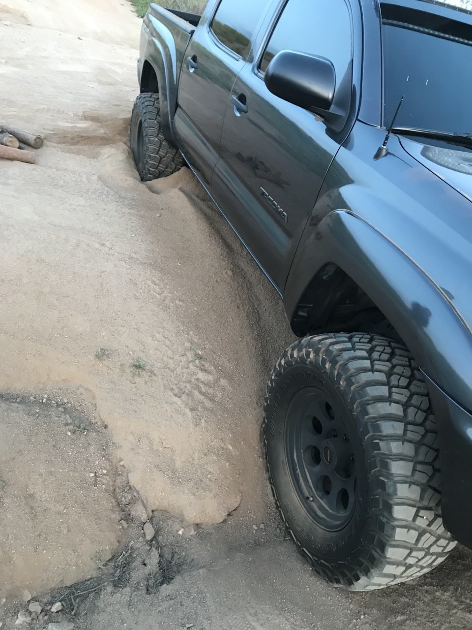

    Wow I just got out right before night time! Thanks for the help guys I literally tried everything you guys suggested me. I got some wood planks my friend brought some shovels and we started digging the back tires and also took out 12-15 psi from my tires and it helped a bit but I wasn’t getting any traction still so luckily some good people who live around those trials saw us and helped me out brought me some straps and one of my friends that was with me gave me a pull with their Tacoma and and i barley made it out.
    Going to take this as a learning expirence to be more careful either give it enough gas to not get stuck or avoid a trail that looks bad.
    Thanks guys for help and suggestion very much appriciated!! :thumbsup:

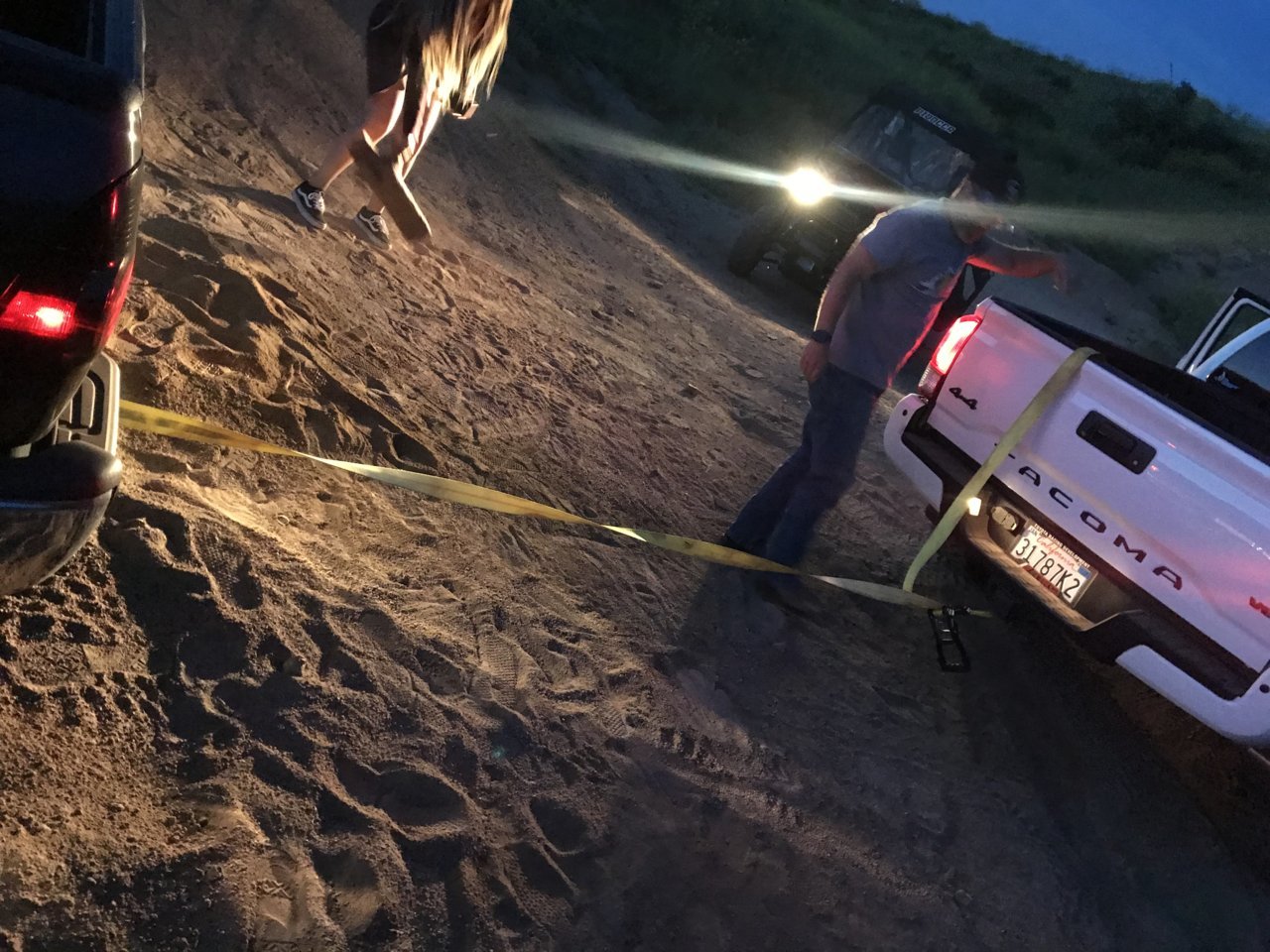

    Why was that strap hooked around that tail gate????

    It's not. Looks like the excess of that strap is thrown in the bed. Some weird d-ring setup,though

    That looks like a ratchet strap:eek:

    Holy crap! You're right. That is very unwise

    Yeah it looks like they used a ratchet strap as a recovery strap lol. Not a good idea. Unless I'm seeing it wrong.

    Dang, you're right. Wtffff

    I zoomed in close. It definitely is a ratchet strap

    Well damn I've done all my recoveries wrong, guess I need more ratchet straps

    Yeah you made me take a second look after I posted my question..... I was like no fucking way.... and that dude is just standing there. No towel or floor mat over the strap incase it breaks.

    I don't understand how they couldn't dig him out. He wasn't that deep.

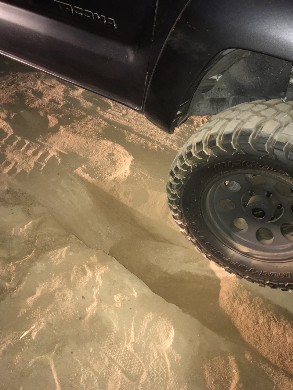

    From the looks of your pictures, you tried to drive through a small trench with the front tires and started to spin the rear, and ended up stuck?
    In the future, don't hit something like that square (both front tires at the same time) if you don't have to. Turn slightly so you'll hit with passenger front tire, then after its through, driver front hits it, that way you'll have a better chance of not getting stuck again.
    Or just back up a little and hit it at about 25mph or more. :D

    No front tire spin on a 2wd. So its 25 mph or nothing.
