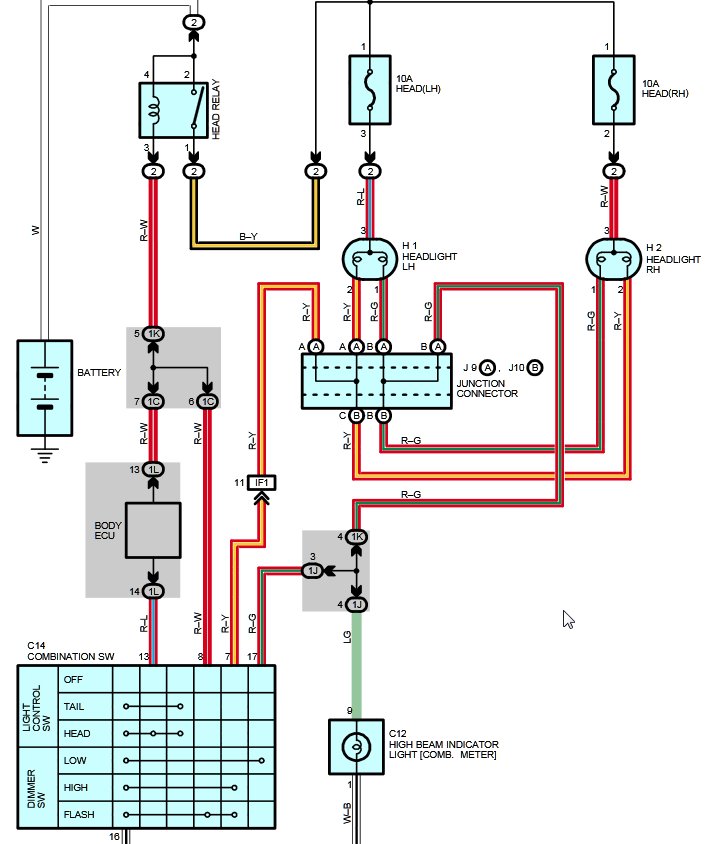

    UPDATE ...
    It wasnt the bulbs, they lasted 4 miles then went out again....i think its in the combo switch or the plug, wiggled the stalk and they worked, shut the truck off , when i restarted it lights were back to screwed up again ...no low beams , so gonna take it apart again today and check the harness, ill post updates...

    It was the red with white stripped wire on the plug to the combo switch...its either loose or coroded, i fiddle with it and low beams come on ....guess ill have to order a new plug and splice it in...

    Is it custom wiring? Unless the wiring has been modified red-white is used only for flash (turns on head relay bypassing Body ECU). The head relay can be turned on by turning light control switch to HEAD (grounding red-blue wire from Body ECU) or by grounding red-white wire through flash switch. The only difference between these two is that BODY ECU has some logic to automatically turn off lights after engine is off and you lock the car. Early models don't have Body ECU and red-blue wire is directly connected with red-white.
    You mentioned in the original post that red-green is also burned. Check all wires and contacts in that connector, there may be more of loose / corroded contacts. I mentioned before, that Toyota did really crappy job on designing that circuit - with age under high amp load contacts and connectors get hot and can corrode, even burn.
    By the way the same flaw is in turn signal circuit - the entire current from both turn bulbs (21W each) is running through that poor switch. That is the main reason why I switched my blinkers to LED and why I'm preparing to do the headlight harness mod (I would rather burn bulbs than the switch).
