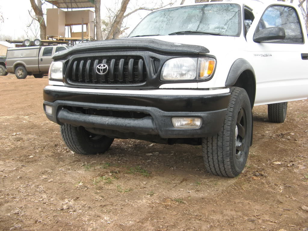

    Well I finally got rid of the horrible chrome grille and front bumper. I think it looks 100000000X better. I bought a new black grill off ebay and painted the bumper with self etching primer and gloss black paint.

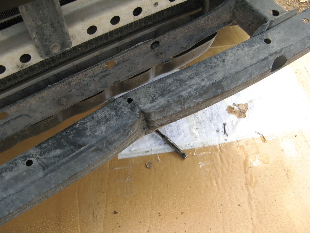

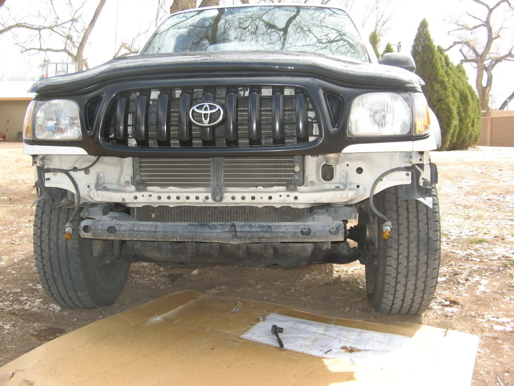

    During: I found that the truck has been in a minor accident by the previous owner..
    After:

    Looks Good You Should Paint The Fender Flarzes And The Lower Valence To!?

    Thanks, Yeah, the lower valence is really dirty right now. When its clean it looks nice and black. Im still deciding on what to do with the flares.

    I did what the guy who started the "I hate chrome" thread did. I took an orbital sander to the bumper to scuff it up really well. It is very important that there are no shiny spots. Then I sprayed a few coats of rustoleum self-etching primer (got at autozone), let that dry over night and sprayed a few coats of gloss black on top. Well see how long it lasts.

    I just did it today and drove 90 miles back to school (70 mph freeway). All is good so far.

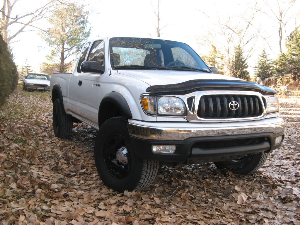

    Looks awesome man, Did you paint the rims aswell?

    Yes. That was probably 2 months ago. They still look great.

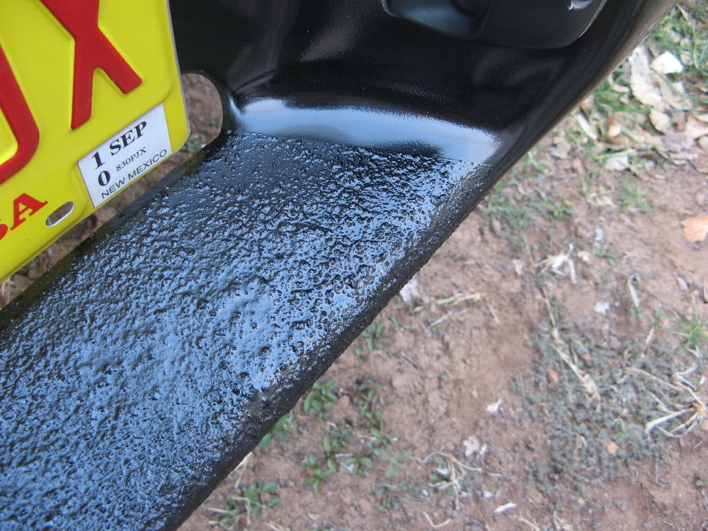

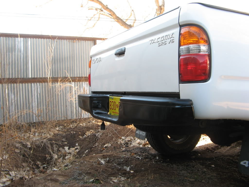

    Okay, I finally got around to doing the rear yesterday. I used the same process as on the front bumper but I also added some herculiner by the plate because I step there a lot getting things out of the bed.

    I like the I Hate Chrome look! The back bumper has a good addition that I will add to my 04, I like the traction aid below the plate for getting up into the bed. How did you do that? Where did you get the herculiner and how did you get the rough finish?
