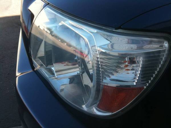

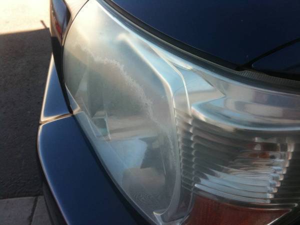

    So I had some extra time at work today and after washing & waxing the Tacoma I was staring at my headlamps and was disappointed by the fogginess. So I talked to our paint/body guy and he showed my how to do it. Just got some very fine sand paper and wet sanded the lenses by hand. Then used a power buffer and some buffing compound from Meguiars. Very happy with the results. Took about 10 mins. Been needing to do this for over a year, should have done it sooner.
    Before:
    After:
    My advice on this would be to do the headlamps before the wash. I had to re-wash the front end after I was done with them.

    what grit did you wind up going with. planning on washing tomorrow and this needs to get done on my truck as well

    To be honest I don't know the exact grit. It was VERY soft and smooth. Didn't really feel like sandpaper at all. And you don't have to worry about messing up the body/paint around the lens the sandpaper is way to soft to hurt it.
    Edit: I googled and found this video. Says 1600 or 600. I think it depends on how bad the fogging is.
    http://www.ehow.com/video_2327659_headlight-restoration-600-grit-sandpaper.html
    http://www.ehow.com/video_2327662_headlight-restoration-1600-grit-sandpaper.html

    So like a 1500 or 2000 grit?

    I was just editing my above post. Yeah, 1500 or 2000 should work. Just depends on the severity of the fogginess.

    could possibility be a wet paper what color was the paper?

    It was a very light green color.
