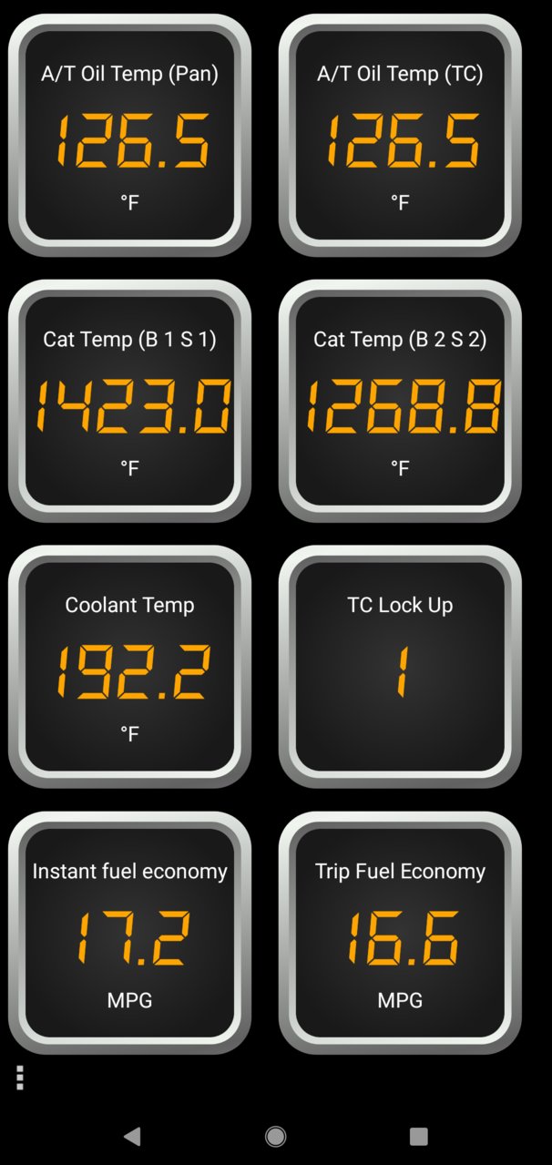

    That's the theory but in my experience having a giant cooler with an internal thermostat still results in very low temperatures when not working the truck. in the summer with road temps easily hitting 120°F I see maybe 160°F driving around, 180-190°F towing heavy around town.
    In the winter I haul a race car on a flat bed, tools, camping gear, etc 4 hours away. See attached.

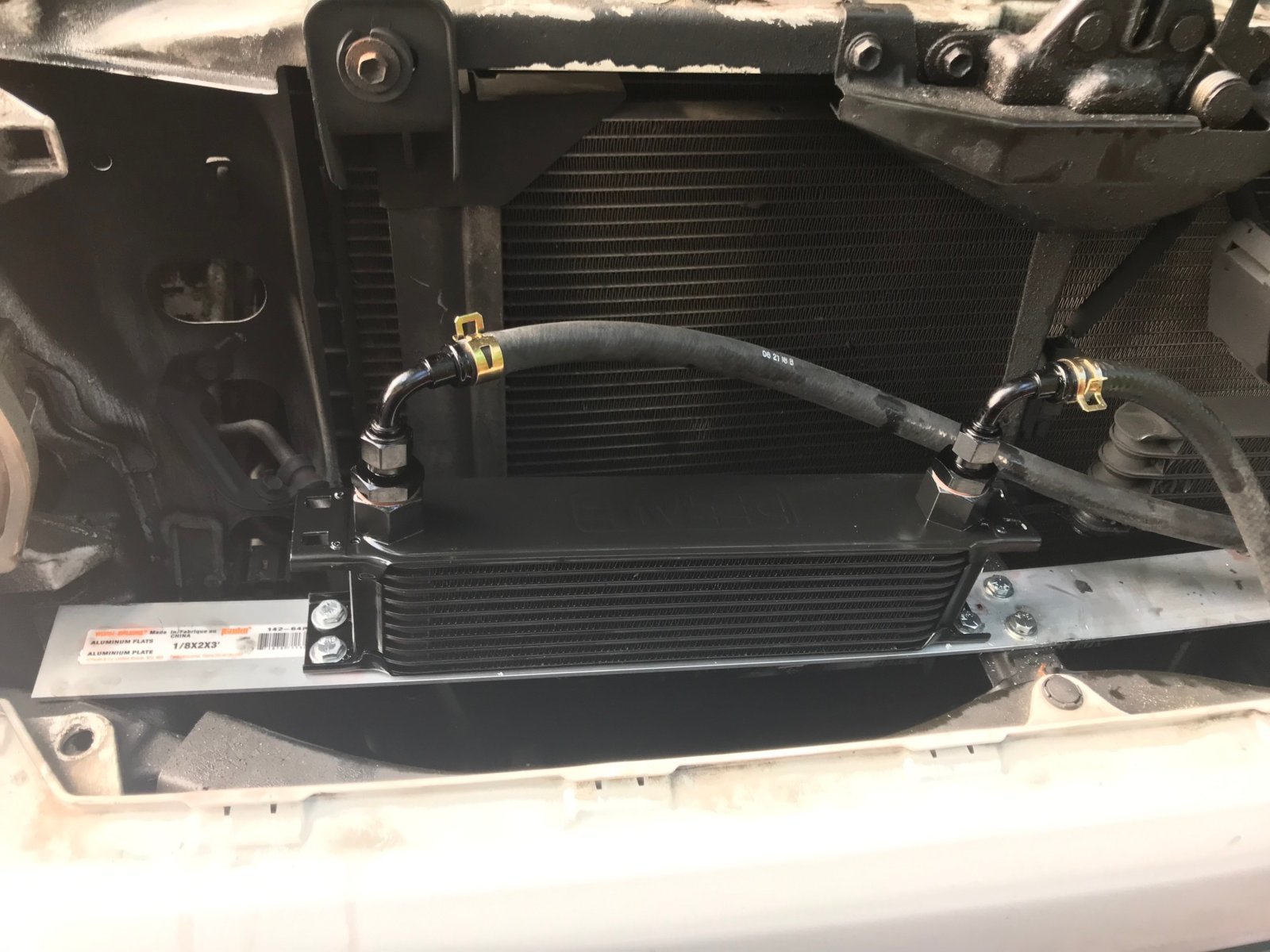

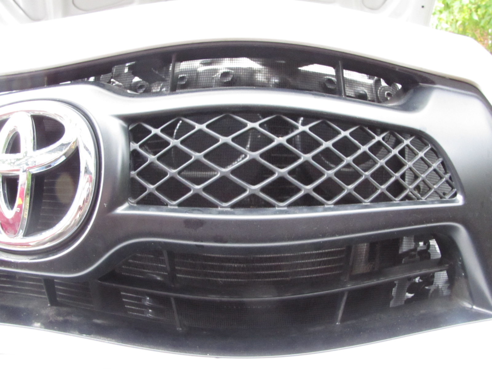

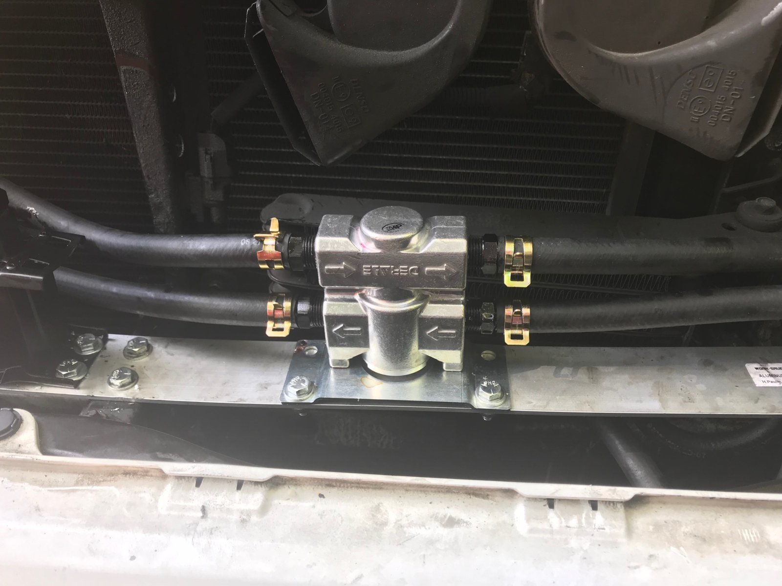

    Oops, noticed that this wasn't actually directed at me. And this is the 3rd gen forum. But i am sure some of its adaptable to those also (except for the mention of the factory 2nd gen tow package atf cooler)
    For sure thats what us forum members are here for :thumbsup:
    1 1/8"X2"X3' aluminum flat . Bolt to center support and just sits on frame both ends (third picture show this best)
    1 Derale 13401 Series 10000 Stacked Plate Transmission Oil Cooler 10 Row
    1 Derale 1060 Transmission Fluid Thermostat 3/8″ FPT Ports
    2 EVIL ENERGY 6AN 90 Deg Fittings Hose End Push Lock Black for 3/8 Inch ID Nylon Rubber CPE Fuel Line
    10 1/4"X20 bolts and nylock nuts
    1 3/8 inch magnefine inline filter
    1 Derale part # 13026 3/8" Fluid Control Thermostat Mount Kit
    10 plus steel spring band clamps
    Lots of 3/8 in transmission cooler line
    The rad/condenser look perfect because I took off the front panel (the one with toyota logo on it and zip tied fiberglass window screening to it. It do this to every car i have owned. Best mod you can do for like $5
    Routing. Hot line from trans into OEM cooler. Then out to thermostat. Then to derale cooler and back to thermostat. From there it goes thru the magnefine and back to transmission. If you have any other questions just ask......
    Temp has never gone over 175 although I have yet to do any towing. If I was to do this again I would add the thermostat in the loop after the out line from rad and before any of the coolers. In the winter it can run a little cool (140F). And this was before I added on the additional cooler. I like the new trans where the output is actually controlled by a thermostat in the transmission itself.
