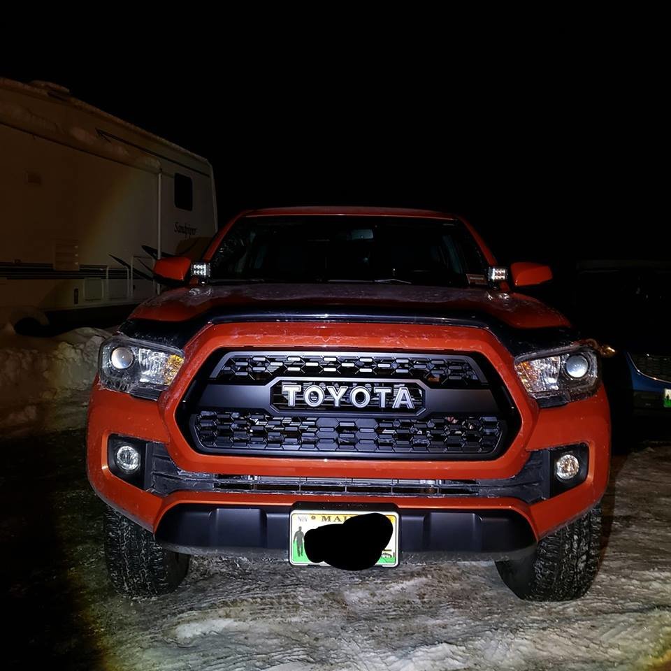

    Cali raised Ditch light brackets, adn their 28watt ditch lights, wiring harness, and relay mount, along with a factory style switch $165
    I worked a bunch of Overtime at work, and I hated the chrome grille...
    TRD PRO grille from $140

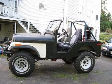

    this is what i came from.. fully modified 1974 CJ-5.. edelbrock 650CFM 4bbl carb, adeabrock performer intake, AMC 360 V-8, true dual 2.5" turbo 40's, Ford T-18a, D-20 transfer case, NTD44 rear lincoln locked, stock D30 front, front disc brake conversion, 32" mud king radials, she's a beast, but not practical at all.. and horrid fuel mileage (like 12MPG)..

    YES, the jeep is sitting in my driveway.. although looking to sell it soon, just dont have time for it. and its needing some work. nothing major, but a bunch of small stuff.. have a BUNCH of upgrades for it too.. just no time or money to put into it.
    AMC 360 V-8:upgrades
    bulltear SS oil pump midplate
    Bulltear HRC cut/matched oil pump gears
    bulltear matched timing gear set
    bulltear oil filter relocation kit
    bulltear oil cooler (not installed)
    edelbrock 650CFM 4 barrel carb with offroad needle/seat kit installed (less likely to stall on hills/inclines)
    edelbrock performer intake
    HEI ignition
    1 wire GM alternator (need to fab up a better mount than a long bolt and stacked washers..)
    Trans: 1984 Ford T-18A (ford F-250) fully rebuilt less than 2k miles ago, new Novak adapters output shaft.
    T-Case: D-20 transfer case-rebuilt less than 2k miles ago stripped, (painted, oil level tube installed, really needs a twin stick setup on it)
    rear axle: NTD44 rear axle welded spiders 3.73 gears( goes ok, but with anything larger than the 32" mud kings I'd regear to 4.10, or 4.56 gears) has the larger 11x2" drum brakes and uses the stronger u-bolt style pinion yoke
    *rear disc brake converstion from SSBC (not installed)
    *all parking brake cables were brand new when rebuilt in 2005
    front axle: NTD30 front open diff 3.73 gears (new bearings, and rebuilt in 2004) converted to front disc brakes from a 1976 CJ-5 (knuckles out) warn premium hubs (5 bolt i believe).
    Steering: converted to power steering (try and find a 1980's AMC 360 power steering bracket that is not cracked...) new PS box, and lines fora 1976? CJ-7. (steering shaft was shifted lower approx 2 inches lower for a lower steering wheel).
    Wheels: american racing 15x8" white steelies (unsure on backspacing/offset)
    Tires: 32x11.5" mud king radials only 2k mile on them.
    Frame: stock other than the custom rear crossmember I made from 1/4" plate steel, and custom rear high clearance rear bumper with weld through shackles) have front bumper to match, but had to remove to mount my tabor 9500 winch.
    body: Fiberglass with 2 inch body lift steel windshield frame, steel hood (original), steel grille (original), fiberglass fenders
    electrical: Painless 12 circuit wiring harness (need to be cleaned up, and ends propely terminated (soldering)
    Brakes: manual brakes with correct proportioning valve for front discs
    uppgrades I have yet to do...
    *Scout II Dana 44 widetrack axles (will push tires out 4" each side)
    *Oil cooler
    *Majave heater installed but not hooked up for blower/switch
    *partial top (no doors/frames)
    *New brake lines (3/16 copper corrosion resistant line full package, want to replace all the 48" sections of coated/aluminized line and multiple junctions (cleaner look)
    *New driveshafts (the one on it, they work, but are a bit too loose (splines/play in shaft for my liking) and the rear shaft need a DC joint in it (too steep an angle on such a short shaft).
    *rebuild carb (starts up, but wont stay running think the idle ciruit has a clog, and its been a while
    *remove mechanical fuel pump (has an electric micro pump that is more than sufficient with areturn so it does not burn out (also needs hard lines run, strictly rubber line only from tank to the stock mechanical pump. tank,a nd skid are (brand new in 2005)
    *hydraulic clutch (the mechanical bellcrank linkage SUCKS!!!.. when you get off angle, and hanging a tire.. the clutch can disengage.. I have the slave, and master cylinder that are supposed to work for it.... just havent had time to do it..)
    its a solid jeep, but definitly a bunch of small projects on it that need attention, I lost my wheeling buddy to marriage, house, and kids 5 years ago.. and just lost interest in getting myself stuck without a buddy to help haul my ass out of a mess...

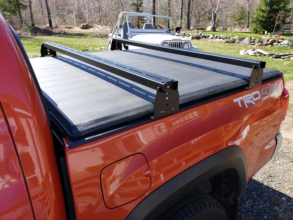

    KBvoodoo high rise tonneau brackets arrived.. beefy!! theyre definitly going to be able to handle my RTT..
  7. May 6, 2019 at 12:44 PM
    Scott17818
    Scott17818 [OP] Well-Known Member
    Oct 29, 2018
    #271032
    1,576
    Scott
    Midcoast Maine
    2016 Tacoma DCSB OR
    methodMR305NV, 265/70/17duratracs, ARB RTT, DITCH Lights
    bed rack is on.. pretty fast shipping from KBvoodoo.. I ordered on 5/1 (late at night 9:30-10:00pm) had the brackets on friday night (5/3 when i got home from work), and the crossbars came in this afternoon 5/6/19, couldnt wait to install them.. just need to get the RTT before I determine their final resting place as I will have to cut back the gasket foam on the tonneau rails the KBVOODOO brackets make it sit too high..and its pretty dense foam... sadly my tonneau has these thich cross bars that kinda make my tonneau cover not a tonneau.. I tried removing them (they velcro in place, so I may wind up making some thinner ones..) but it just flopped around, and kinda thundered like a drum... its definitly strong though.. there is NO FLEX in the crossbeams ( stood on top of them after install (Im 6'3" 260lbs).... and the brackets look/feel like they can take a beating...
    from the shipping labels its roughly 29lbs for the brackets, and 19 for the crossbars.. so 48lbs.. the tent will add approximately 130-165lbs depending on is I carry the annex with me, or not.

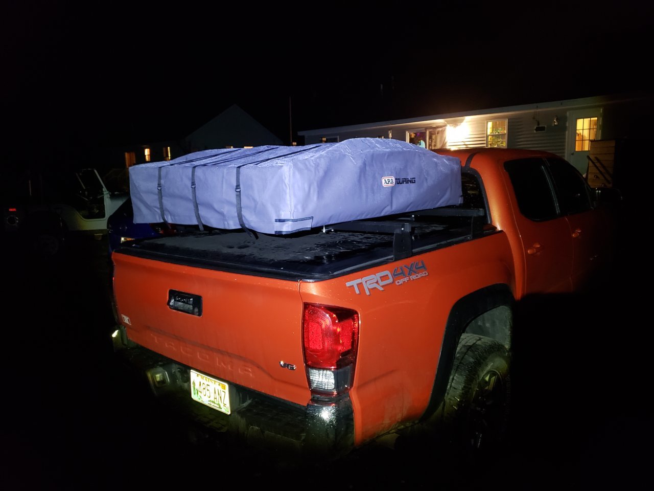

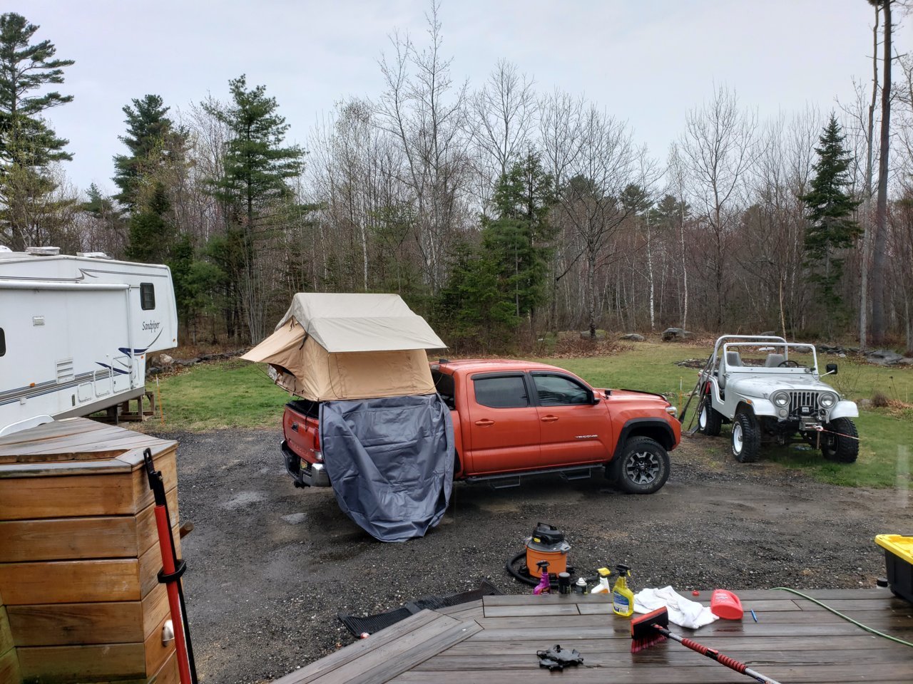

    More progress! My ARB series III Simpson rtt showed up on 5/7... 20190507_134533.jpg
    Boxes arrived!!! Was in the midst of cleaning/ detailing interior when trucker came wandering to the back yard. Backed the truck up to the trailer and just loaded it onto the crossbars... package had slight damaging, but was double boxed.. interior box was unscathed.. set about to continue cleaning the truck.. until it started to rain.. figured it was time to switch gears as I was home alone, and no way to move the 171lb package into the house by myself. 20190507_172624.jpg 20190507_205536.jpg
    All packed up it sits just at the roof line. I do need to replace or cut the ss bolts shorter so I dont have to use the longer strap type mounting and just do 4 bolts to the crossbars.. I packed it up when the rains stopped around 7:30pm.. and then I opened it to air out at work today..
