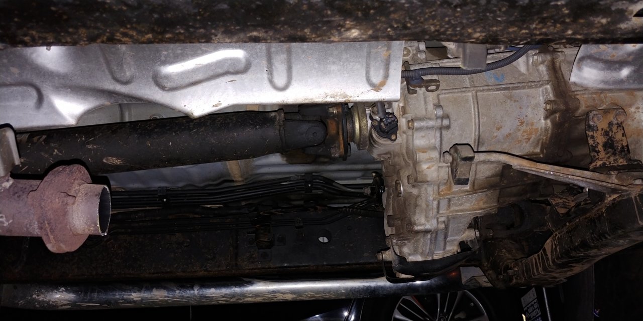

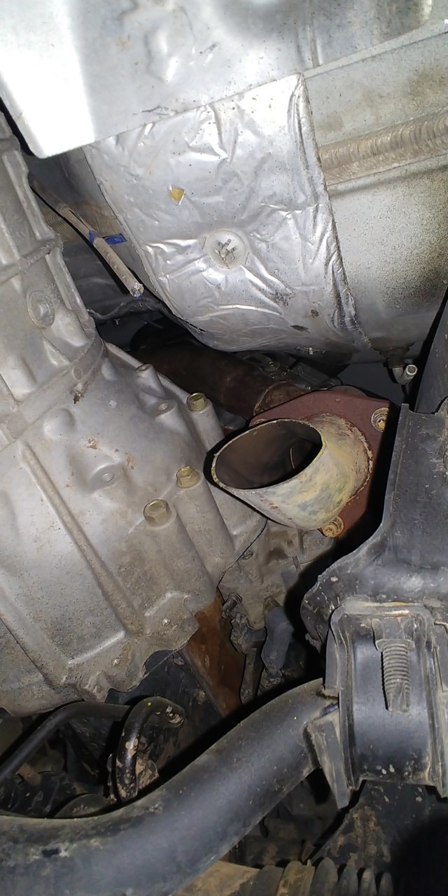

    Can someone address this from the perspective that I got hit by scumbag catalyic converter thieves a20230202_125545.jpg 20230201_183800.jpg nd my pipe is cut from the bend on the passenger side header. Need to drive it 15 miles to my shop and don't want to cause any damage - timing, valves, lifters, camshaft, etc.
