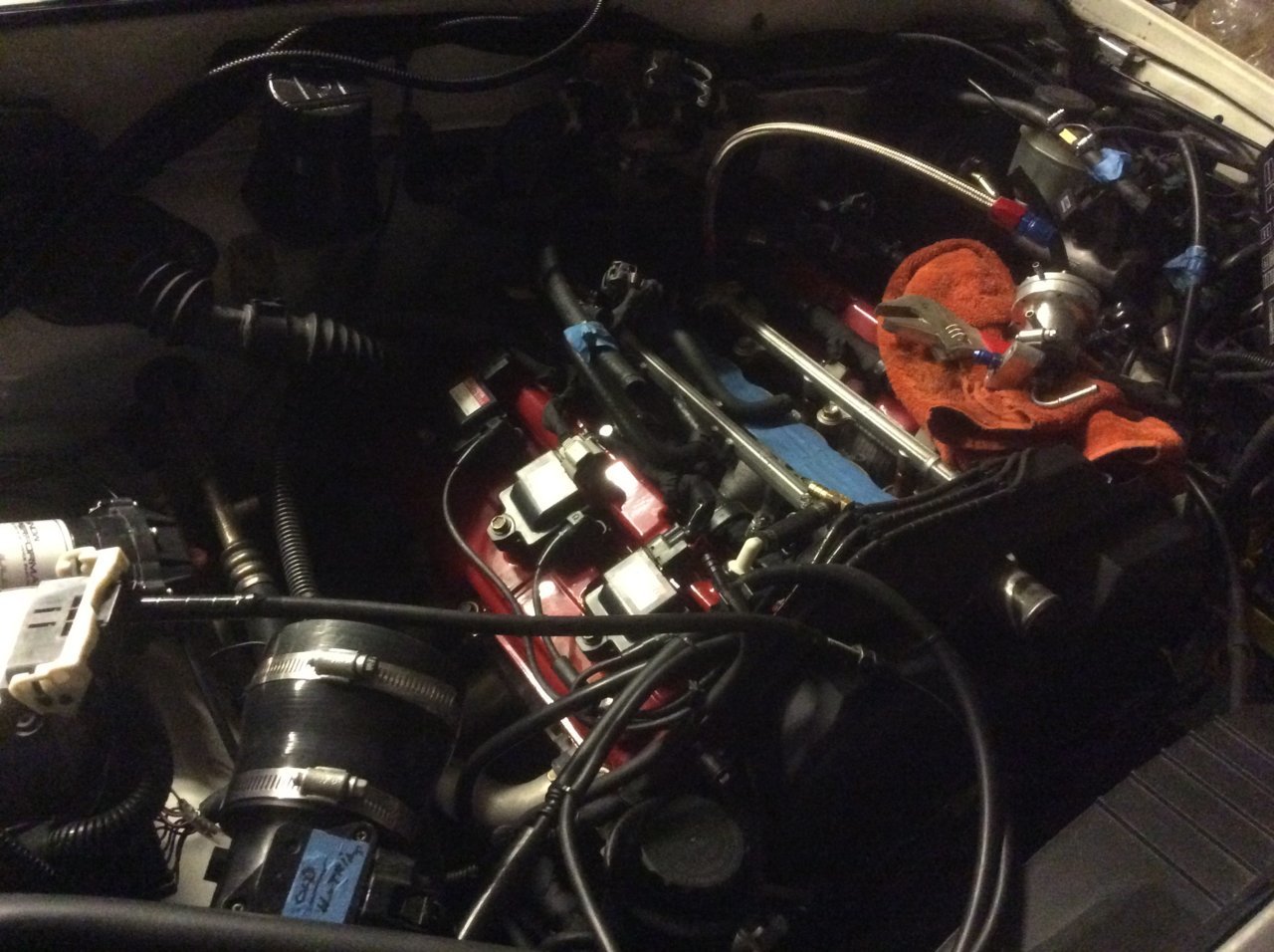

    So maybe you can help me out here, I just put my injectors back in my truck after being cleaned.
    So the intake, supercharger is removed and I want to pressurize the fuel line to make sure
    there are NO leaks before putting the supercharger back on.
    I pulled the starter relay in hopes the starter would be out of the circle and the fuel pump would come
    on but no dice, if I disconnect the starter wires will that work?

    I am pretty sure even when cranking the ECM needs to see the MAF signal so if the air intake is also off.
    If you put battery voltage to the contact of the Circuit opening relay the blue wire goes to the fuel pump looks to be the correct one between 96 and 2000 should get you what you need maybe with a fuse and push button switch .

    Yes, the MAF was connected with the starter relay removed and NO fuel pump working.
    Put voltage to the blue wire for the fuel pump ? Where is this circuit?

    disconnected the small wire at the starter, put the starter relay back in and switched the key to start and you could hear the fuel pump going,
    AND NO LEAKS
