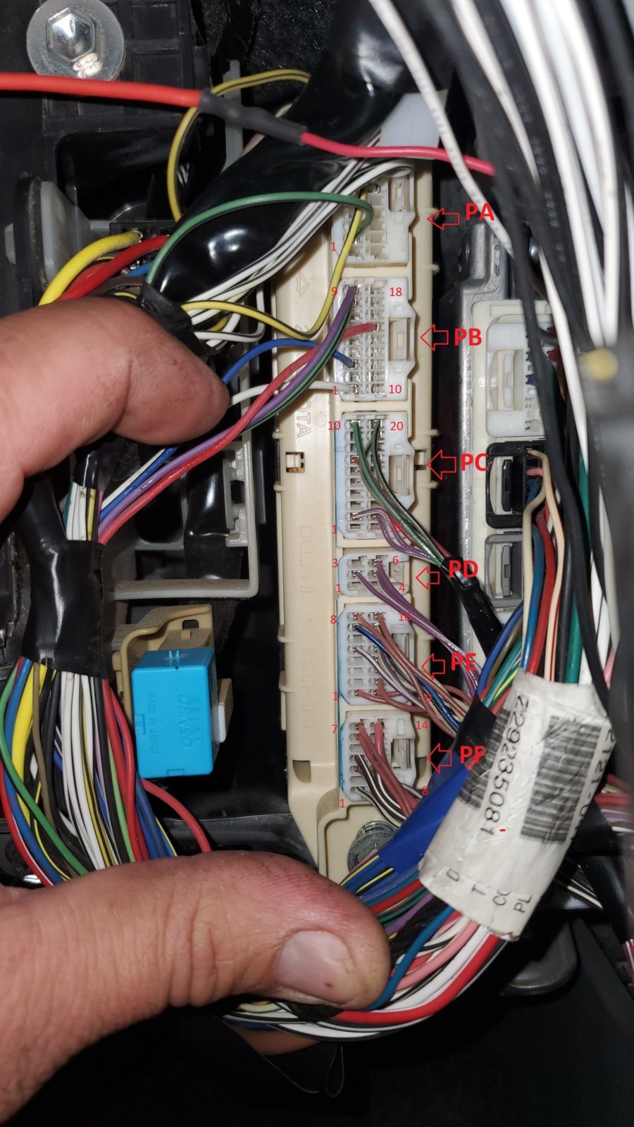

    If you have nothing at the HVAC Controls then check Connector PF Pin 14 (Pink) at the JB No2 behind the glovebox.

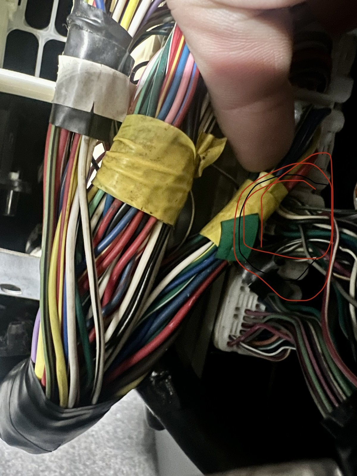

    I tried my best to get a picture of it, but it's the module on the right with the harness one of above the bottom one that isn't receiving power, i believe that has most of the wires that go to the wiring harness for the climate control but receives no power

    Hard to tell for sure but that looks like the PCM not the A/C Amplifier.
