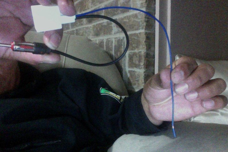

    Anyone know what this wire needs to go to? It is a aftermarket harness for 2013 FM antenna. I am replacing my stock radio with a JVC. Dont know where this blue wire needs to go.

    Sorry, couldnt upload pic.

    Looks like it's for a power antenna or an inline signal booster. It's looking for switched 12VDC from your head unit I believe, probably the power antenna wire on your other harness.
