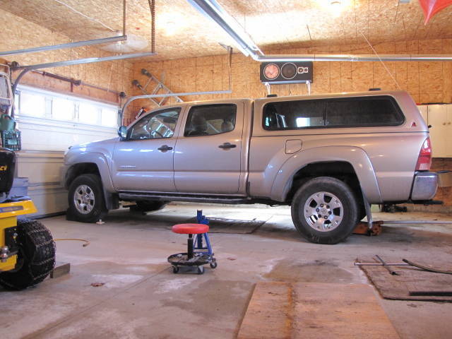

  7. May 6, 2011 at 11:39 AM
    elwood
    elwood "Really, how hard can it be?" Jeremy Clarkson
    Feb 10, 2009
    #13484
    192
    Neal
    ont, canada
    2007 SR5 4x4 LB
    K/N cold air intake, leer cap, running boards, nose gaurd,E brake control, mud flap cut, suspension tsb, Rear diff breather mod,Factory Fog lights, Factory front diff cover
    This was mine half way thru the install. 884 on 9000 shock installed and stock tsb rear. I was thinking it looked not bad and pretty much level before the aal went in. Had thought this could be another way for people to level the truck instead of a spacer. Just thought you might wanted to see this. My floor slopes to the door and those are stock tires. Good luck.
