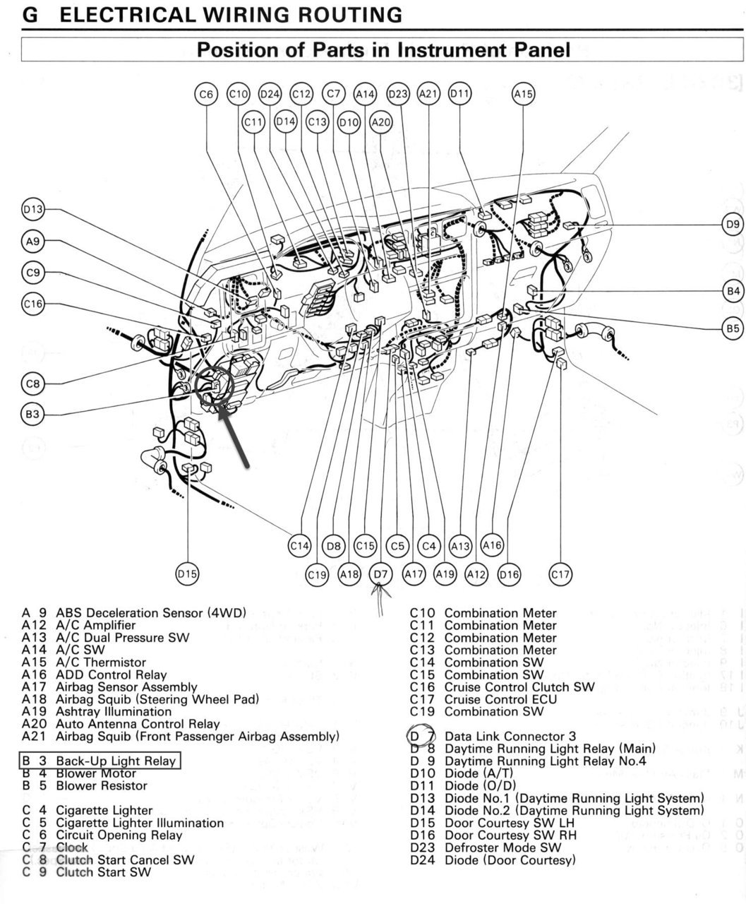

    Please help!
    For the life of me, I can't figure out my reverse lights. The 2000 fsm says to check the backup relay, but I cant find it anywhere! Supposed to be next to fuse block behind kick plate, but there's no relay there. Also cant find the backup switch on the transmission. Just the pnp switch. Bulbs are all good and so are all fuses.

  12. Sep 16, 2019 at 12:00 PM
    skeezix
    skeezix Well-Known Member
    Oct 31, 2010
    #45512
    2,326
    Colorado
    1998 Limited
    Does this help?

  13. Sep 16, 2019 at 3:09 PM
    RedManRocket
    RedManRocket Well-Known Member
    Mar 18, 2015
    #151238
    2,297
    Red
    Sonora, Central Cali
    2002 Double Cab LT
    Esb 5.5 with Kings Mcneil 6.5 fenders Other stuffs
    Only the older models have a back up relay I believe
