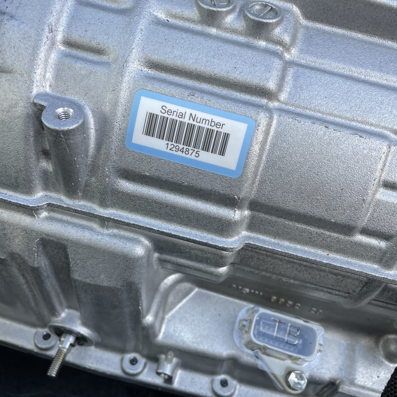

    I ordered a new transmission through an exporter in florida and have a local mechanic installing it this weekend. Attached is photo. Part number says 6818AA, the VIN tag on my truck says A750F. Os there any way to verify that this is the right transmission?

    I would need to see a picture of the complete transmission to identify if its an F model . The serial number in the picture could be Jaspers .

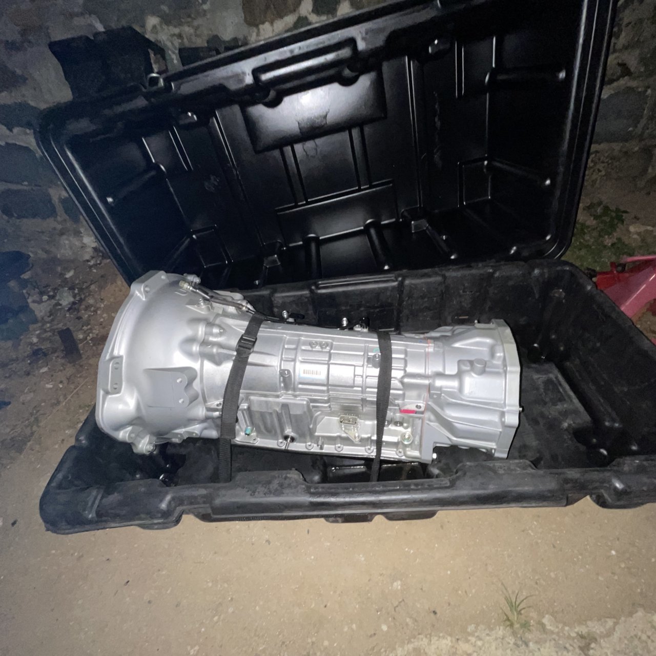

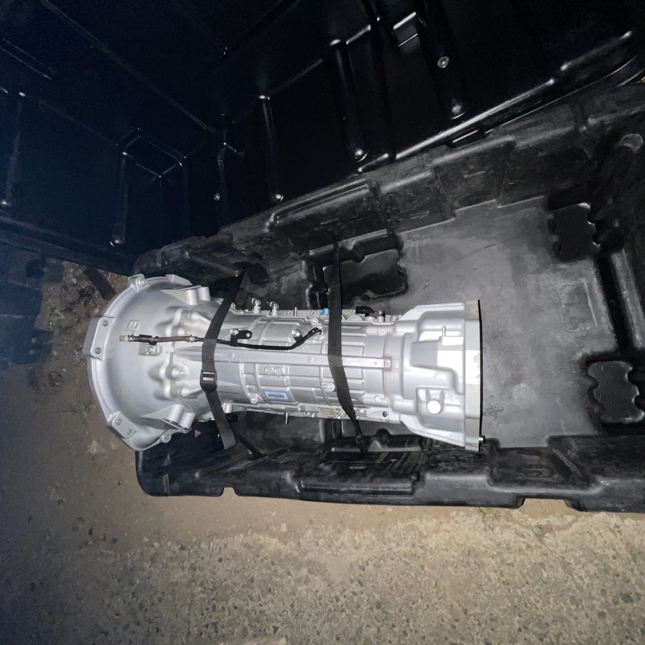

    This is the best I could get at night. D48025DD-7444-4410-B999-541FE0718652.jpg

    Yes sir !!
    That is a 5 speed A750F
