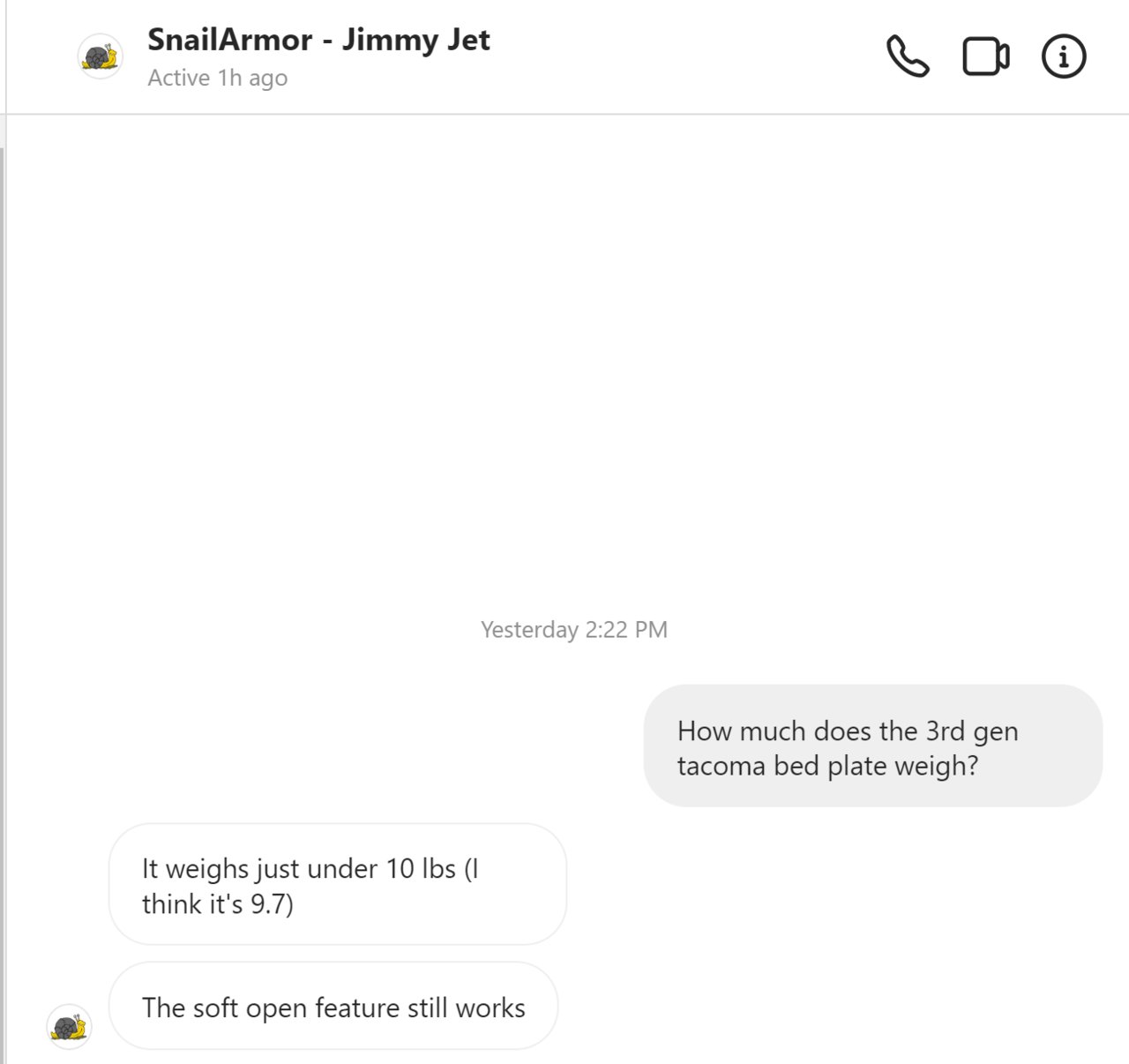

    Can you also weigh it, please?

    I think it's like 11 lbs. Probably says something on the website. As for hot, mine has been sitting in 90 degree sun and just had to crawl back there and it wasn't particularly hot or anything and I was wearing shorts. Now, leaving it open and in the sun probably would get pretty warm but so does black plastic.

    Couldn't get access to a scale, bit it is very comparable to the stock piece after removal.
    I held it in its packaging at arms length single handed. 11 to 13 lbs maybe.

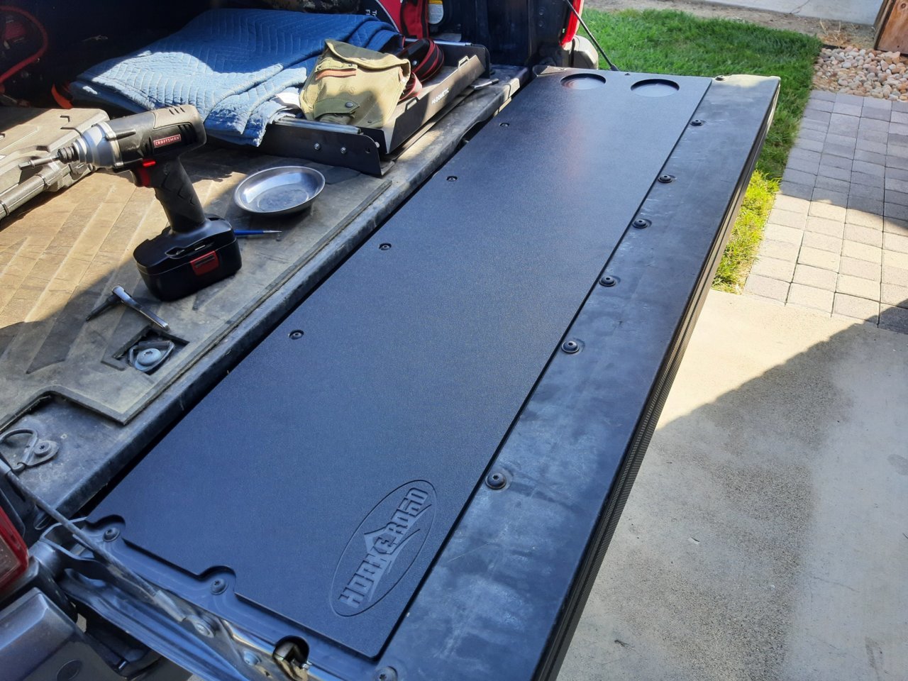

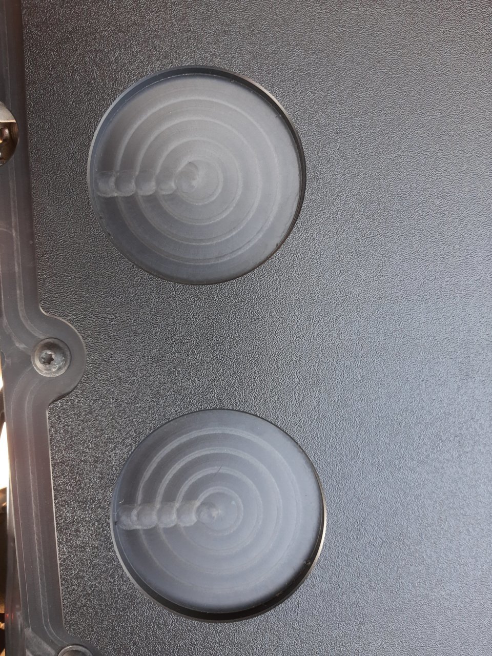

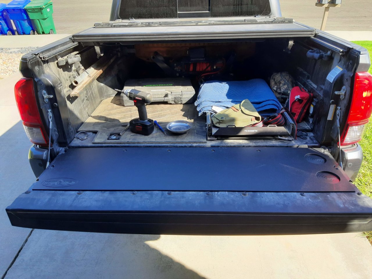

    So I took a risk on this cheapo Amazon product and it's not too bad for $139.99. https://www.amazon.com/dp/B09PVDSPPS?ref=ppx_yo2ov_dt_b_product_details
    It's got a cheesy brand name with not so good finish on the lettering.
    The cup holders also have some minor defects.
    One of the corners was slightly bent but not enough to really bother me. It's on the inside corner where you can't really see it unless you really look hard.

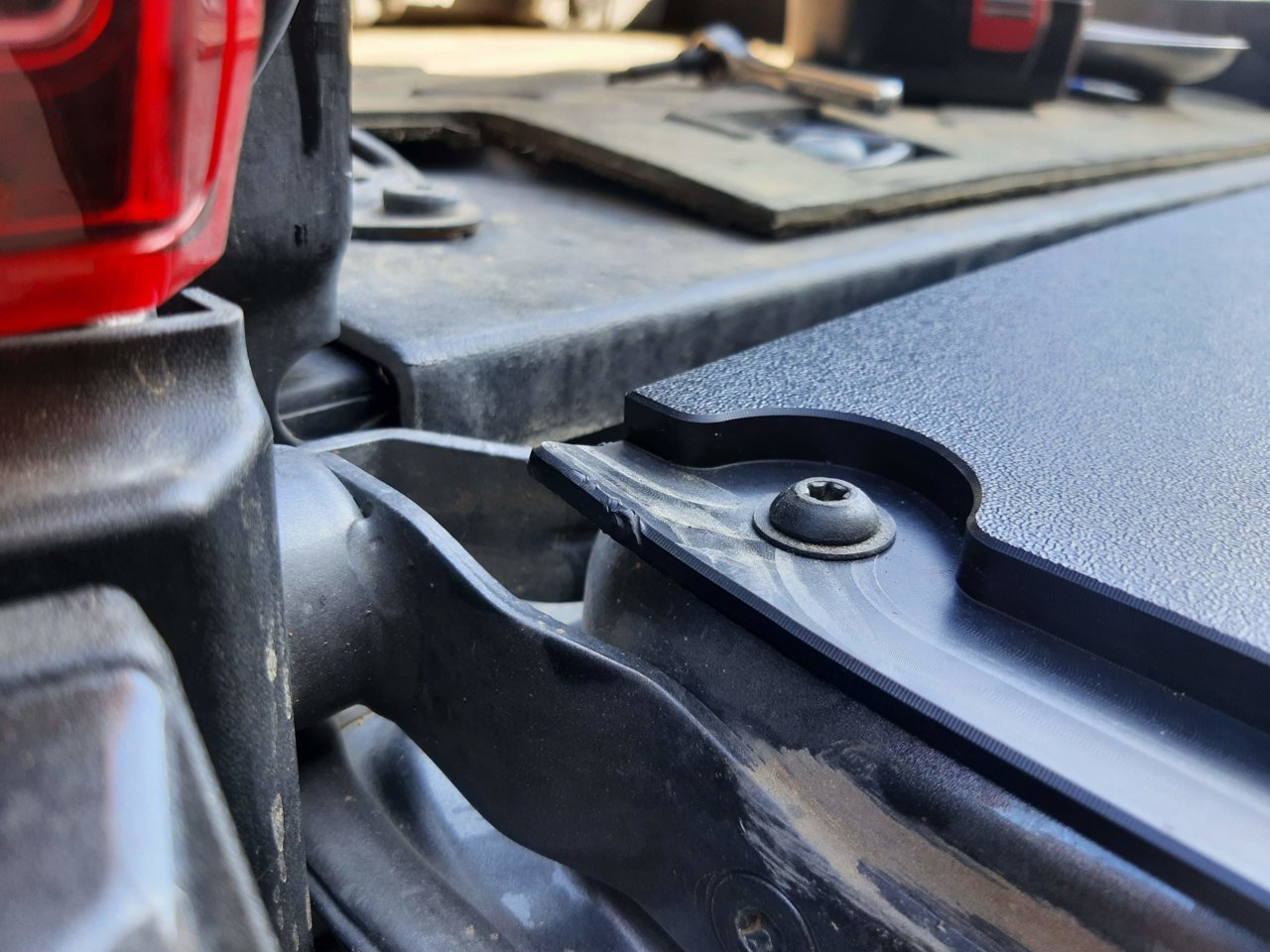

    It reuses the factory hardware which are just screws in plastic backing. Kinda cheap setup from the factory to be honest. I recommend removing and installing these screws by hand because it's really easy to strip the plastic backing if you use any power tools. But I think all the expensive panels on the market also reuse the factory screws and backing.20220821_162353.jpg
    Not all the holes aligned perfectly but it wasn't bad enough for it not to work. I just left all screws loose so I could move the panel around until they all found a home. Then tightened them all down once they were all in. Everything looked aligned at the end.
    It made the tailgate a littler heavier so I noticed the tailgate damper isn't as stiff as before. The tailgate opens a little faster and harder now. Again not enough for me to really care. It may wear out the damper faster but only time will tell. I don't mind supporting the tailgate a little with my hand on the way down.
    Overall you get what you paid for. But I'm hard on my trucks and usually scratch things up pretty quickly. I'm not the type who babies my truck or cares how it looks or what brand things are. I just wanted something functional at a decent price. This gives me a flat surface for cooking and setting my beer down. I was considering an even cheaper DIY setup. But this was so cheap and installed in 10 minutes it just made more sense for me.
    I give it a solid 4 stars. It's cheap and meets my needs but I can't give it 5 stars because of the poor finish.
