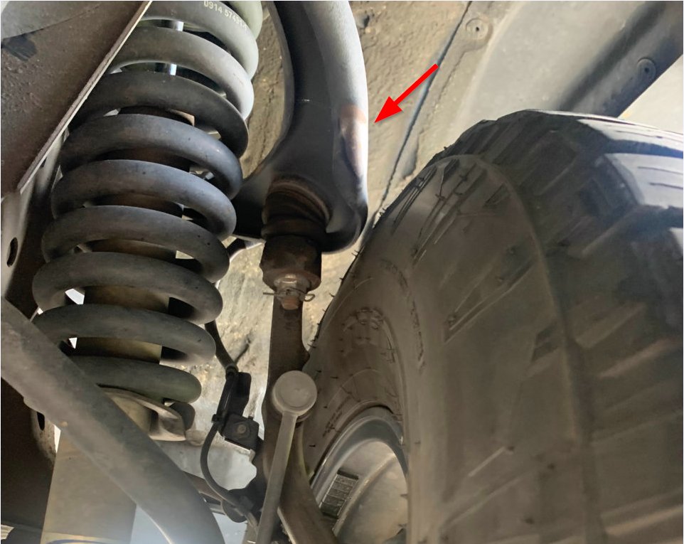

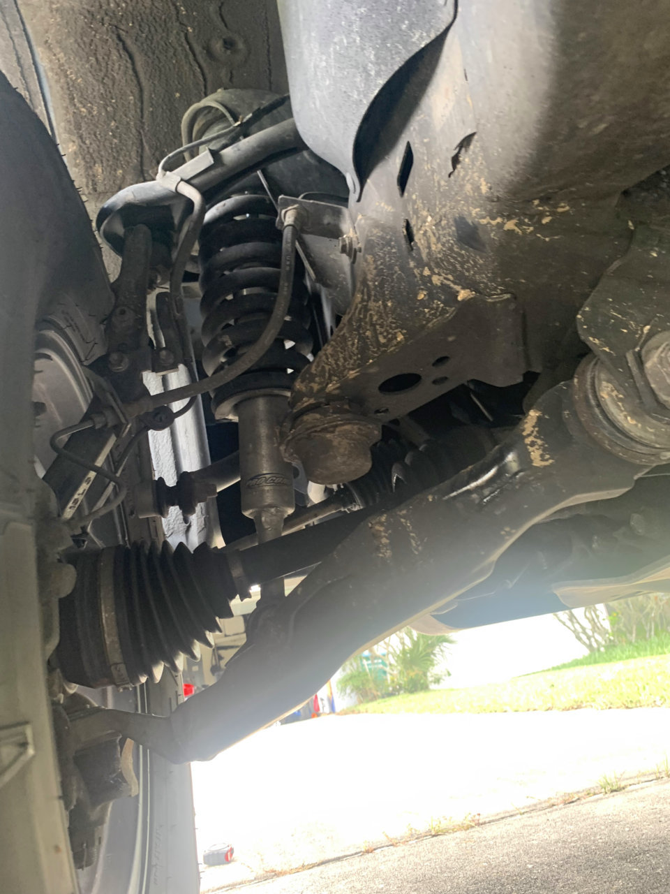

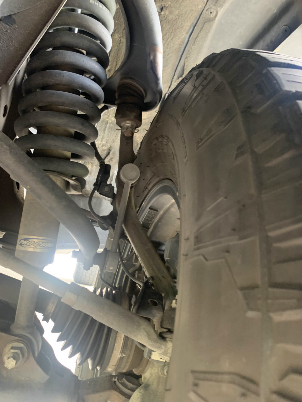

    I believe it is the upper control arm but I am not 100% sure here's a photo that may help. Let me know if you need any more information, I am new to this truck stuff. IMG_5953.HEIC.jpgIMG_5959.HEIC.jpgIMG_5957.HEIC.jpg

    Your first photo tells part of the story: you are rubbing on the upper control arm. Your tires are too close to the UCA so you need either a bigger wheel spacer, different UCAs that give more clearance, or different wheels that move them further away (or a combination of a couple of these things).
    This also is true. Depending on a combination of OP's tire size, wheel offset, and alignment configuration you may rub in other areas too. If these tires are 33's or bigger then yeah CMC, pinch weld, inner fenders, etc. are all possible interference points. Can't tell from these photos, and OP didn't specify tire size so we have no idea. I'm guessing these wheels are the typical +30-ish offset and just too close to the UCA.
