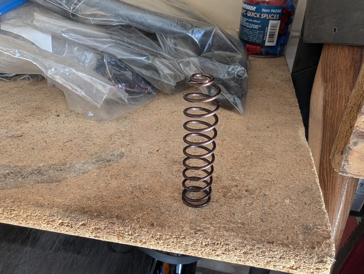

    The mod is pretty simple:
    -- Pull the heat shield. Hardest part.
    -- Pull the hard line between the (modded) accumulator and slave.
    -- Unbolt the slave and experience it shooting out of the bell housing. :facepalm:
    -- The piston is not retained in the cylinder. Just pull the rubber boot and use your finger to slide the piston out or use just a hint of air pressure.
    -- Peel the stoopid heavy spring off of the piston.
    -- Put it all back together.​
    A neat side bene of this is that with some hand manipulation, you can bleed the clutch by yourself since you're not fighting the spring.
    Just a few drives in and I am pretty happy while working out the final couple air bubbles. The 3rd Gen clutch self bleeds very well if some air happens to get in there.
    I saw the TOB spin down after everything was reassembled.
    The TOB still spins with the clutch, but the loading is just fluid head pressure, not the heavy spring force.
    Notes:
    -- The engage point is moved just a bit closer to the floor. Zero clutch drag, but it does change the feel of the stupid overcenter spring. I can feel it flipping over after the clutch is engaged.​
    -- Because of the feel of that spring, I can also tell that the engage point changes very slightly. This is likely due to the resting position of the TOB changing slightly.​

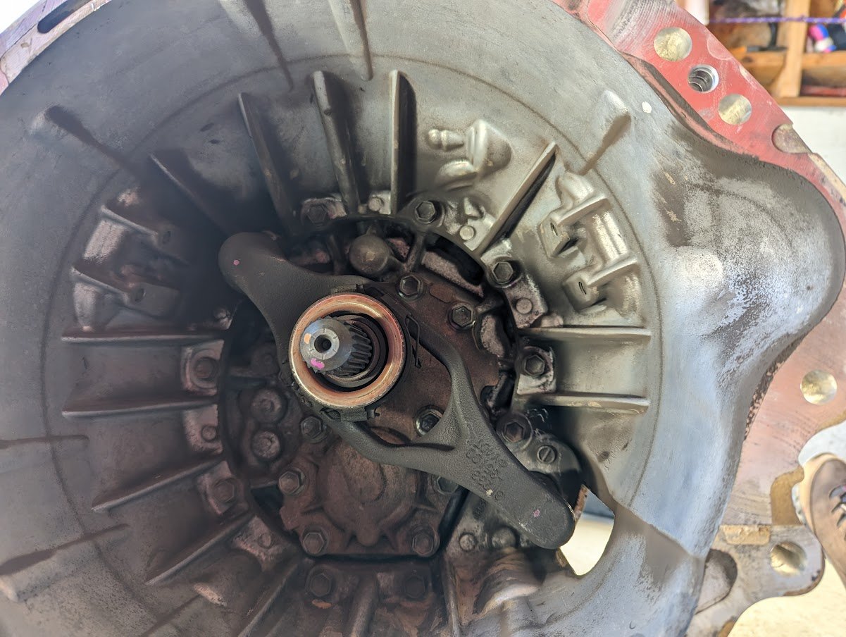

    The spring:
    For fun from the first replacement:
    The TOB's home:

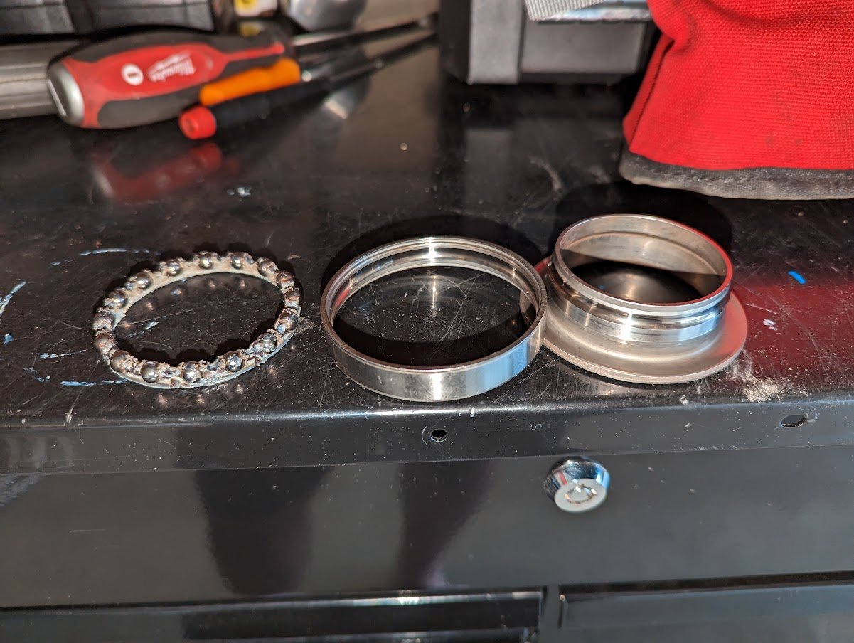

    The TOB disassembled. There is not a lot of bearing surface, IMO.
