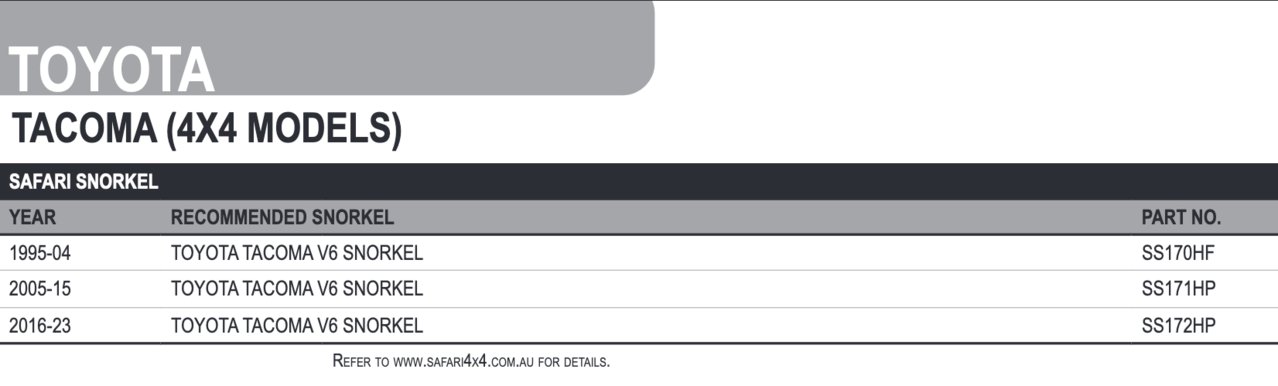

    Attached is a pic of the ARB fitment guide for their Toy snorkels. ALL V6!
    I even checked out the website in the fine print,
    https://safari4x4.com.au/
    No help. And they're supposed to be so steeped in history of 4x4 products? Wake up, over there. And smell the fuel. Toy trucks were ONLY 4 cyl, once upon a time. Man I LOVE my 2TR-FE motor. With the manual trans. LOVE it.
    I guess I will have to choose a different brand. But recommendations here say the Safari is best. Hmmmmph!

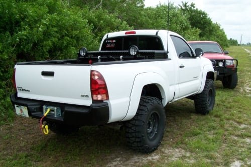

    I know I helped a friend put one on his 2004(I think)it wasn’t made for his year but it worked. He had the same issue none made for his truck. I know it was definitely a 4 banger
    edit: His was an 06

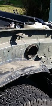

    Isn't the fender orifice in same location as 6 cylinder?

    And yes, the inner fender pass through is in the same place for the 4L and 2.7

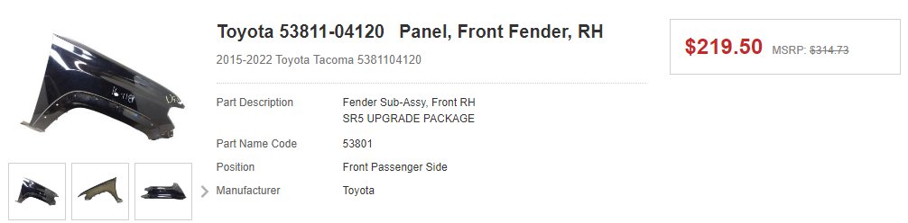

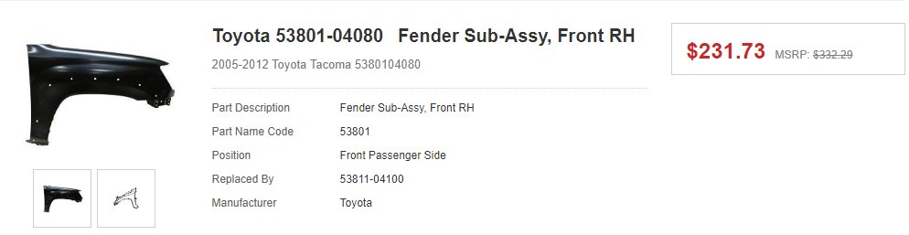

    So now we’ve “invested” $500-600 not including paint for the new fender.
