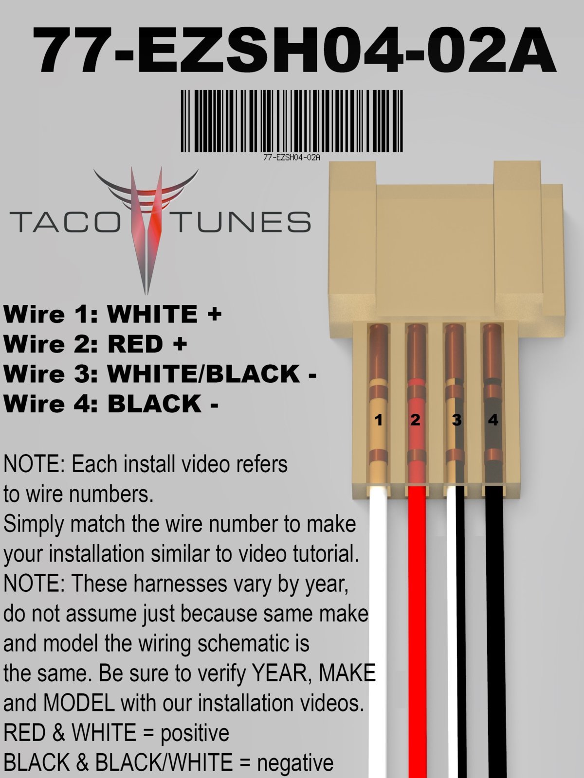

    the front output of the radio will go to top-of-dash speakers first, from there it goes down to the front door speakers. there's a 4-wire plug on those speakers that if disconnected, will render the door speakers not working.
    in the attached image, the center 2 wires, '2', and '3' are the input to the dash speaker. '1' and '4' are the output to the door speaker. using your volt meter, and playing something off the head unit, i would check 2&3 there for a/c voltage, and also check 1&4 for resistance--usually around 1.5-2 ohms, or anywhere from 1.5-6 ohms if there's aftermarket speakers. this will confirm both that the door speakers are connected, and wired back into the dash, and that the radio is connected and wired to that point.
    from that point, use that test as a measure to where to proceed. either the door panel needs to come off, or the radio needs to come out.
